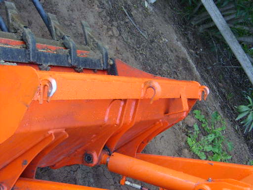

Fab-co 23 series adapters and teeth.
Bucket hooks 5/16 slip center and 5/16 grabs on the outside edge.

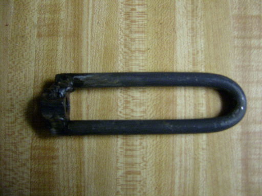

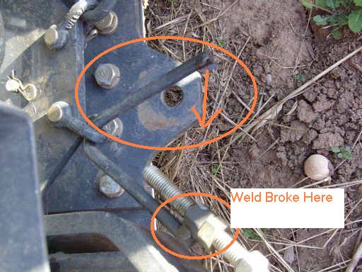

3PH oops /forums/images/graemlins/frown.gif

And 'what' are we looking at in the 'oops' pic? /forums/images/graemlins/confused.gif
   / New toothbar, bucket hooks and oops
This piece that has been fixed /forums/images/graemlins/grin.gif
Its the stabilizer for the 3PH, the u-bolt is at a roghly 75 degree angle. The weld on the bolt broke free on one side.

Nice looking bar and hooks!
Did you determine if the stabilizer was a factory failure or if you did something to stress it too much?
Thanks HomeBrew2. It was the loose nut, the behind the wheel /forums/images/graemlins/crazy.gif
The area I was working was a little tight and I was dragging the box blade on one corner. The soil is similar to dragging across chunks of concrete. The clay with rocks inbeded make a very stable surface /forums/images/graemlins/frown.gif. On a side note the GearMore box blade is fine. /forums/images/graemlins/grin.gif
Attached is a better pick of the hooks. I found while cutting the hooks down to use my grinder with a cutting wheel as opposed to my chop saw. I tried tack wellding one of the hooks to a piece of flat bar and then cutting with the chop saw, I glazed the wheel /forums/images/graemlins/frown.gif. The mount is just a piece of 2x angle
