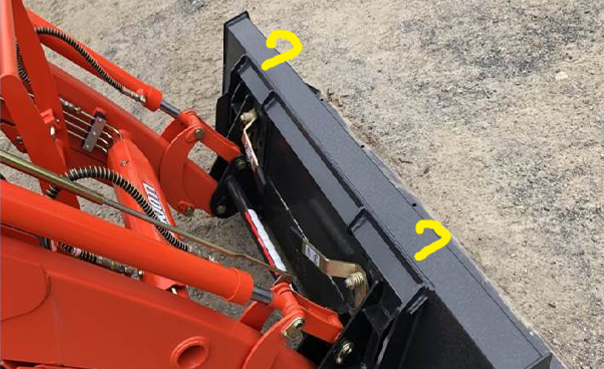

If you mount the bucket hooks near the reinforcements as shown and use backing plates, you should have no problems. Also buy yourself a good quality chain.
You might consider doing what I did on a small tractor that I had. I bought a piece of heavy angle iron the length of the top of the bucket. I welded to hooks to the angle iron, then bolted the angle iron to the top bucket lip using grade 8 bolts. After 20 years of using the hooks, my bucket was as straight as a new one. The extra steel makes a difference. But yes, mount the hooks where Airbiscuit indicated.
