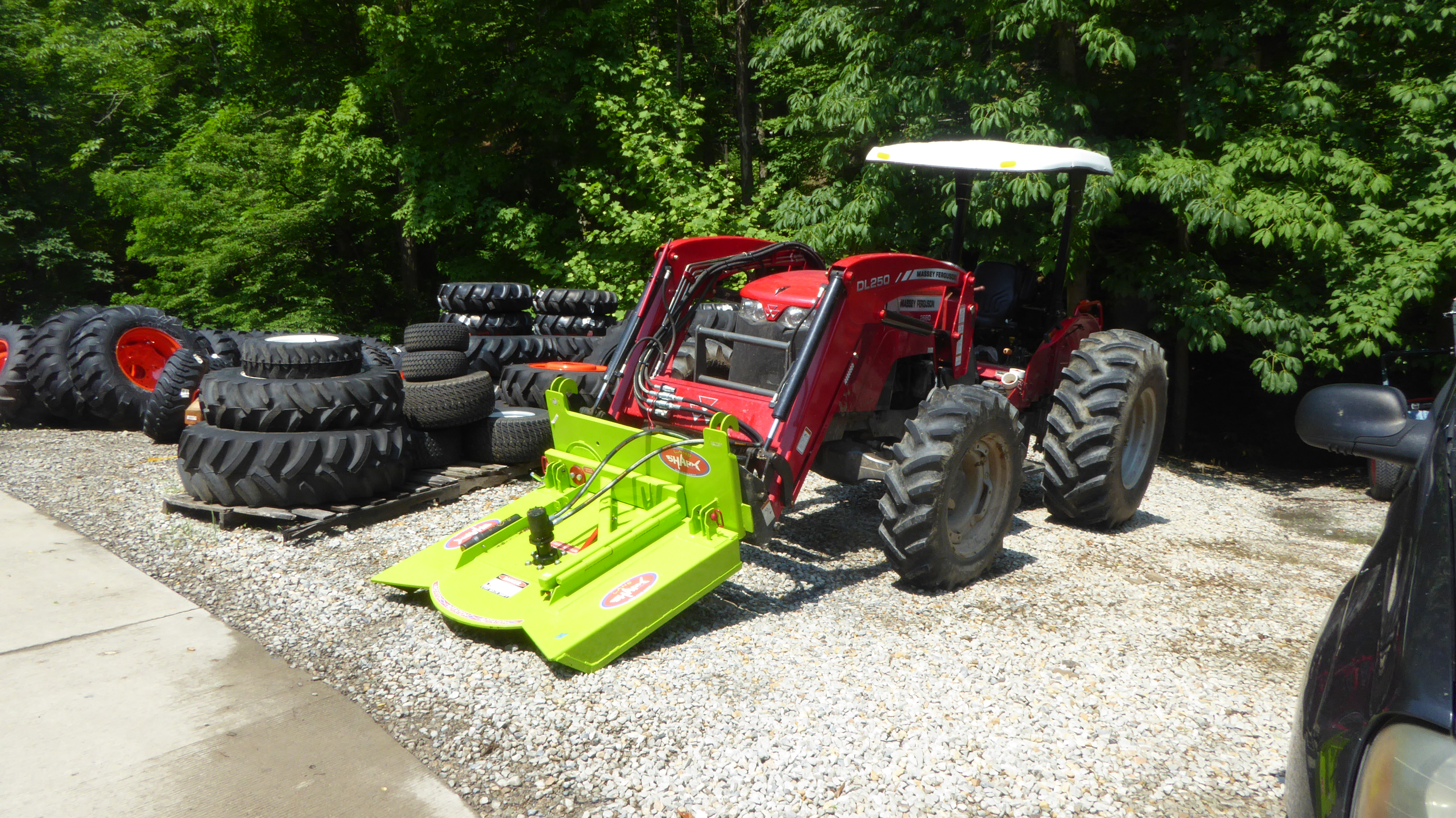

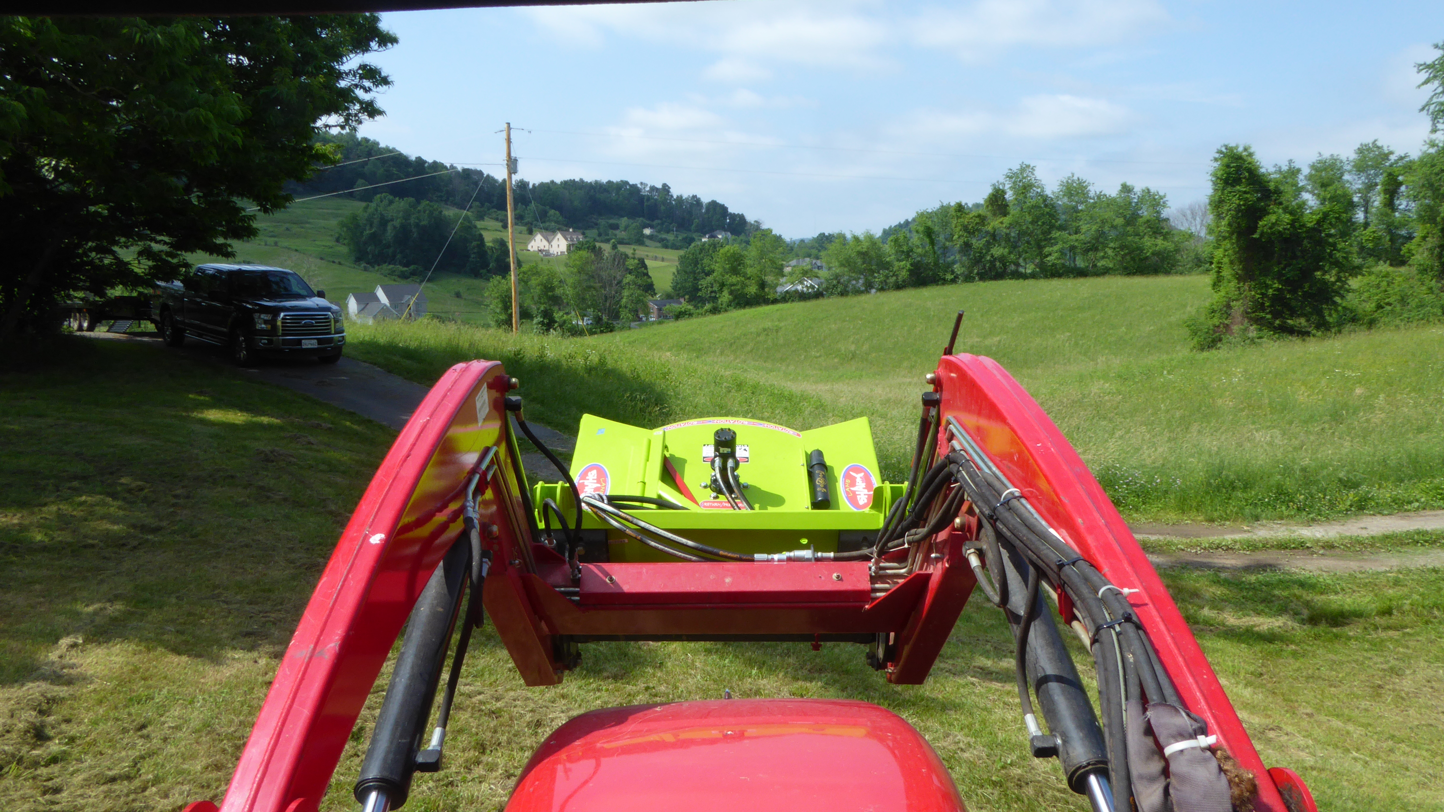

In the first post last Sept you mentioned getting a Lane Shark. Did you and how do you like it ? Since then LaneShark has gained a lot of dealers and seems to be going great guns with sales. Somewhere in there they got a dealer in WV near my farm and I bought the first one sold in the state last month. Had the local dealer (a Kubota dealer) install it on my MF2660. The plumbing turned out to be rather interesting with a few surprises, thankfully for the dealer and not in my shop. I took the tractor to the dealer, had the installation done and then hauled it back to the farm. I recommend that to you. Have only had an hour or so time with the Lane Shark so far but it seems to be a good tool. It has several bugs out of the configuration that I had with a much heavier FEL-mounted cutter in 2011. The hyd flow requirements are much more realistic for a tractor (compared to the previous attempt.) Besides that, the Lane Shark people have insisted on the return being to the sump rather than via the RCV. This has a big effect in that the cutter only goes into free-wheeling when you shut off flow by momentarily moving the loader frame. [Rather than a teeth jarring slam stop if the return line goes to an RCV!] That makes it seem like (most of the time) that you did not really shut off the cutter. It is robust enough to cut most smaller brush without bogging down. It is not as unstoppable a cutter as another PTO driven boom cutter that I have but it is one whale of a lot easier to take on and off the tractor!!
I only get a monthly crack at all the work to do on my farm up there and thus have only an initial experience with it but so far it looks like a keeper.
A couple of pictures -- first showing the Lane Shark as mounted on the tractor. Second one shows the view of it from the tractor seat.

Yes I actually picked up the Lane Shark from the companies owner prior to having the tractor delivered. The tractor dealer did the plumbing the same time he added my 3rd function. Now I have 2 sets of remotes on the front of my FEL. The remotes for my LS also work perfectly for my Titan quick attach log splitter. I have done substantial work with the Lane Shark and it has already earned its cost. There is a learning curve to operating it but the more you use it the better you get. There are not many tree left in areas I use the tractor that have limbs that will touch the cab.
