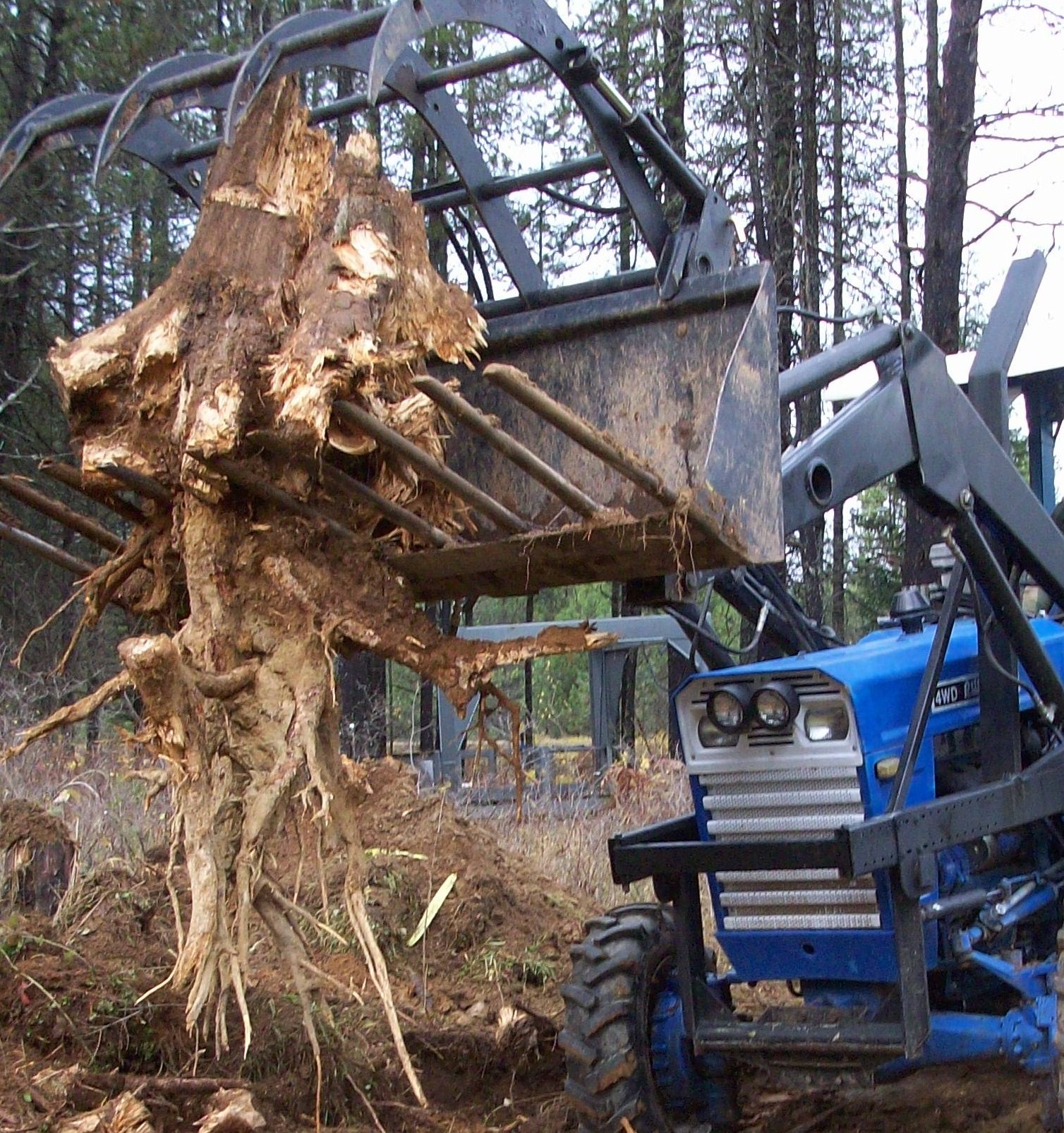

I did push over a few small diameter ones with my similar weight tractor and other than worrying about which way the tree might fall if a wind gust should show up at the wrong time it worked OK .
The problem for me arose when I hit one with a tap root like this attached photo and It would not move so we cut it down and spent some of the day with the tractor a chain, chainsaw,shovels, pickaxe.

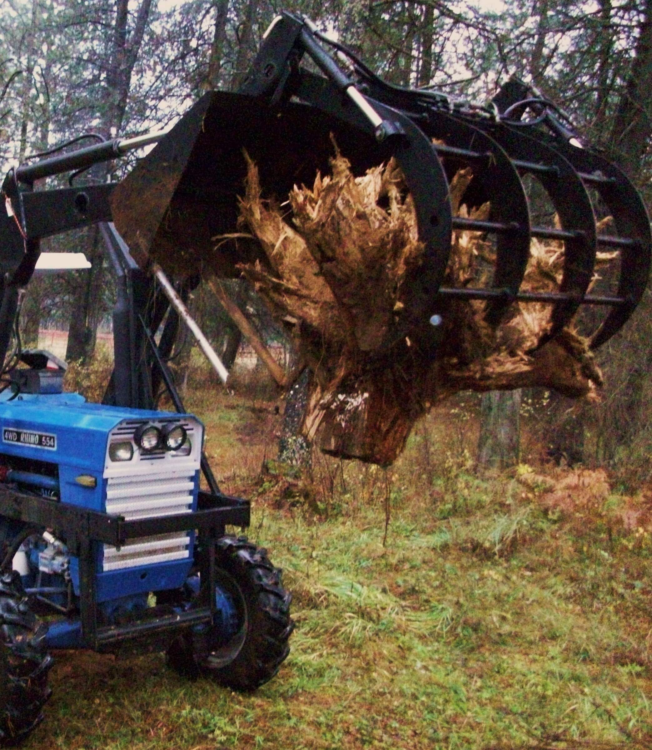

your plan of cutting the stubborn ones and then going after the stumps later sounds good-we also removed a few I cut down- and a was able to grapple the stump out in a single scoop year or 2 later on a rainy day(second picture)
There was not much rhyme or reason for the different root structures. Some were easy some not so easy.
