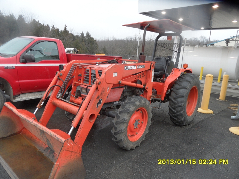

Bargains are out there. I've posted frequently of bargains I've seen and gotten at Public Surplus auctions.
Example:
1991 Kubota L3450 Tractor $4,400
John Deere Tractor Loader 4WDmdl 5300 $9,700
Ford Tractor 3910, $5,200
2002 Massey Ferguson Model 271XE 4x4 Tractor, red and white, 994 hours, with AC unit on top. <12k
2000 Kubota L35 tractor with Front bucket and backhoe attached$10,702 (I should have bought that one!!)
1994 John Deere Tractor with Post Driver $8,900 (or maybe that one)
