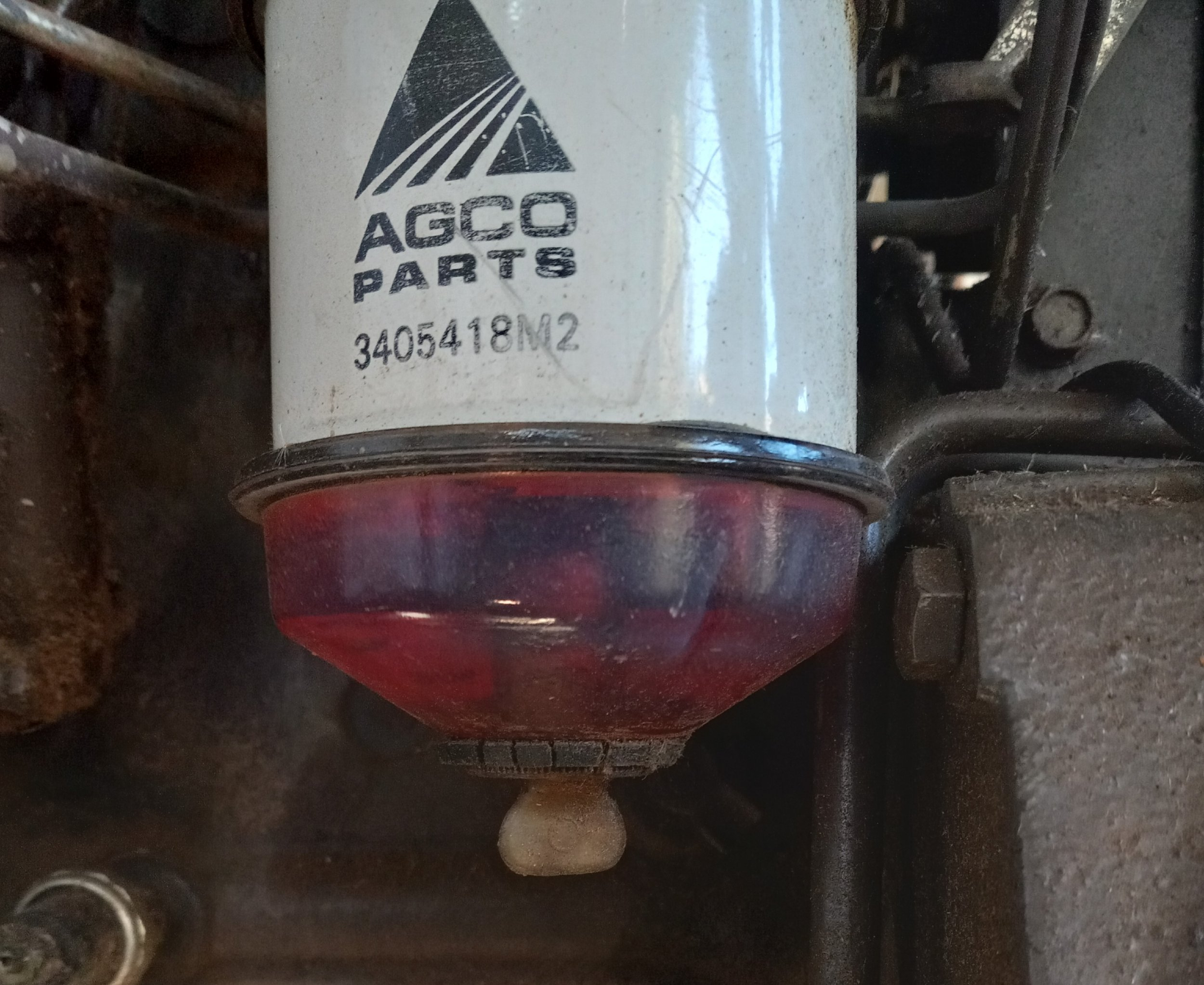

Going to replace the fuel filter because I can't tell if it's an off road mix giving it that brown look or if it's just nasty. That bottom rubber piece is dry rotted and needs replaced. Anyone have a name or part number for it?

You'll get a new set of o-rings and gaskets with the new filter.
Have you ever changed a CAV style filter?
If not I would watch a couple of instructional videos first, they can be a bit challenging the first time.
Napa 3166 should be the part number for your filter, it's the same across many MF tractors and other brands as well.
Here's a thread with a few filter numbers or cross reference on the web or order that agco filter..

Looking at my picture there's a quarter size rubber piece between the glass bowl and wing nut. I've watched some videos and it doesn't seem that it's an included piece.
   / New tractor owner- MF231 #17
Looks like you're going to have to buy the entire bolt kit for that rubber gasket.
Or go with those part numbers provided there and see if you can find just the gasket

Fuel filter does not look too bad. Its equal to a CAV7111-296 or a Baldwin BF825.
