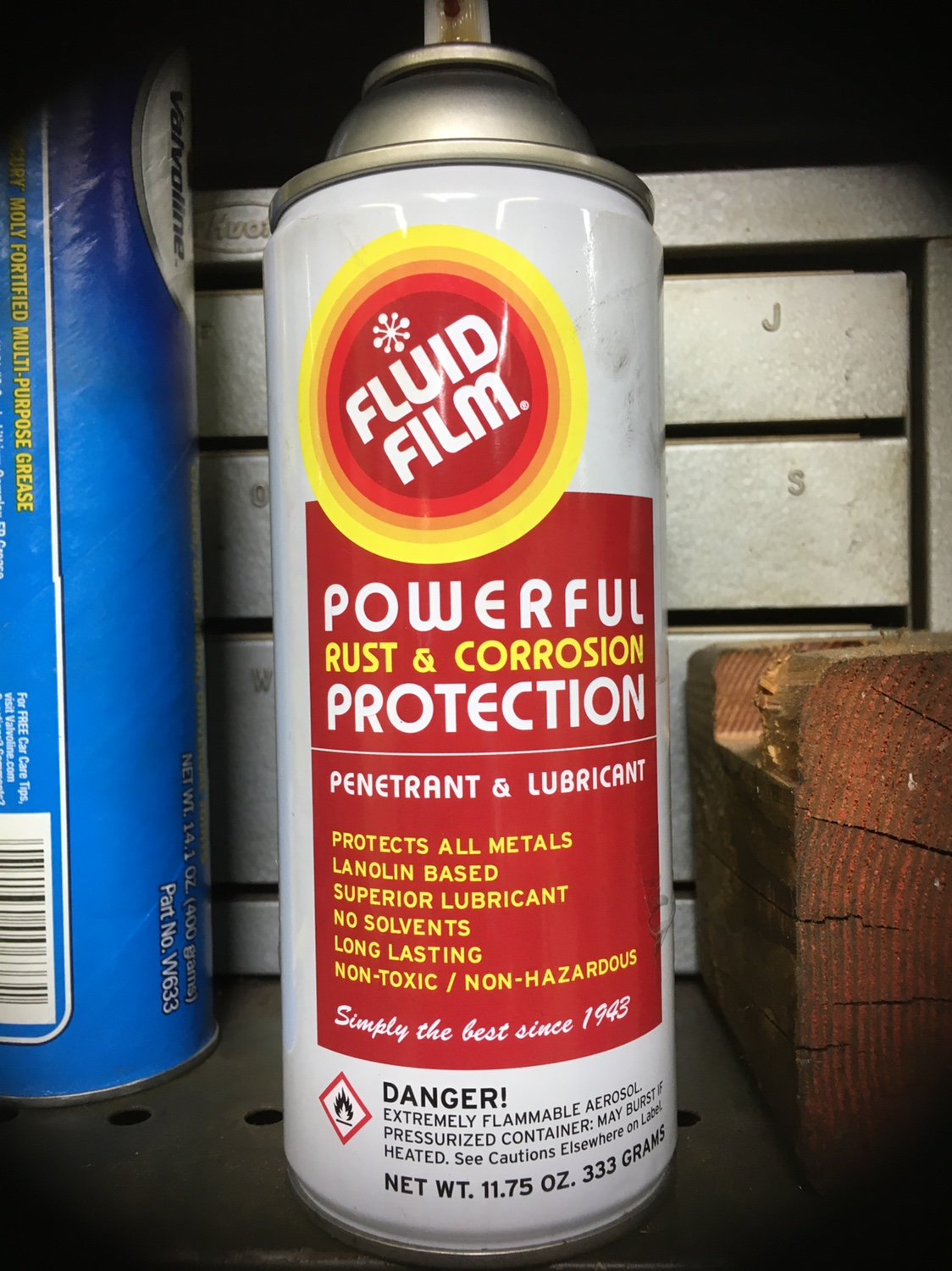

   / New tractor - preventing rust in a coastal environment #5
Use on any surface bare metal or painted.

   / New tractor - preventing rust in a coastal environment #7
Fluid Film may be available here in Aus, but there are several lanolin based sprays just as available.
I use it just as a lubricant. Even though I live about 6-10km from the coast I haven't experienced any salt-water corrosion on any of my 'vehicles'... including aluminium.
   / New tractor - preventing rust in a coastal environment #8
Fluid film is your answer.
