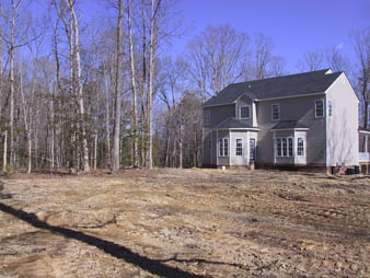

Does anyone have a strong opinion on the Deere 2210, 790, or 4115 they would like to share? I am deciding between the 3 of them, and I plan to buy green. I am worried about underbuying.
I have 6 acres, probably 3 of it wooded with pine and hard woods, and am in the market for a new, multipurpose subcompact tractor. I have an LT160 lawn tractor that I figure I'll keep to finish mow with around the home and the initial yard.
I am looking for a subCUT or CUT for handy work around the house. I had considered the Deere 2210 originally, but the dealer has also mentioned the 790 and the 4115 to me, if finish mowing isn't going to be the primary funciton.
It is a new home, so there is lots to be done 'scaping-wise as well as general maintenance of the property. I plan to have a vegetable garden, am interested in clearing out some of the woodland, have a long 700ft gravel driveway that will require maintainance, and other chores no doubt.
I had even thought the 2210 might be too small over time, and I'd be better suited to moving up to the Deere 4000 Ten series, but not sure. Pocketbook issues may affect that decision. The 790 seems to help allay some of the 4000 pocket book issues, but the gear shift and low spec concerns me, although performance seems solid. I do like the old nostalgic feeling of being on the 790 -- makes me feel like I'm on my granddaddy's old 40 series.
Oh, and I do hate the fact that the 2210 is essentially a Yanmar painted green (made in Japan). At least the Kubota BX is assembled in Georgia. Something about a Deere not being built here just irks me. I'm sure the 790 is built overseas, too, being so low spec. But I am willing to look past that to have a solid, reliable, multi-purpose machine.
Any pricing advice, good, too? I am being quoted $9800 for the 2210 tractor MFWD and $2400 for the 210 loader to start, with a MMM 60" for $1600. I'd like to get the dealer down around $13K total, if possible. The 790 MFWD quote is $12,000.
I'll try to post a picture of the home and type of wooded property surrounding it.

I was at the JD dealer this morning to buy some supplies for my 4310 and had a chance to look at the 2210's up close for the first and was amazed how small they are.
Although I have less acreage than you and I do not use the 4310 to cut grass, I needed something larger than a sub CUT. I liked the 790, but my final decision came between a 990 and the 4310. The 4310 will take a reasonable size backhoe and still is small enough to get into cramped situations.
Although I absolutely love the 4310, I still think that the 990 would have suited me just fine. The 790 would have been the lowest horsepower I would have considered. All the other tractors you mentioned would have been too small for me.

There will be others with direct experience and more knowledge- but given that I'm in simlar situation and have been looking at other machines I'll throw in my thoughts. I was initially planning on buying a 2210 and have decided it's too small and if you're gonna be skidding some trees etc- I'd go with the larger machines. The 2210 offers a lot in a small package. The 790 is a lot of machine (but will be more $ if you need 4WD) and if your happy without a hydro that's likely what I would buy. I don't think the 790 comes standard with a mid PTO either- if snowblowing or other front end attatchments are needed. However, for my needs I would benefit from 4WD and think a hydro is worth the money- which puts you at the 4115- not as much power, but more bells and whistles then the 790 but significantly more in cost. You'll have to figure out what you need most, and balance from there.

Thanks for all the advice. I'm sure I will visit the dealer several more times before I pull the trigger, but I am leaning to the 790. I tend to agree that the 2210 might be too small. And the gear shift doesn't bother me that much, as I might actually enjoy "working" the tractor. The 2210, after I test drove it, seemed so slick, I just said to myself, "White collar tractor."
