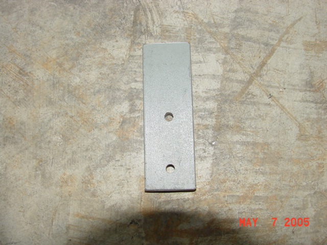

#35
Bob,
I fixed the gate on my trailer today, only took about 1 hour and $3.00 to do, I used a piece of 1 1/2" x 3/8" bar that I had laying around. Here is a pic fo the piece with 2 1/4" holes drilled...

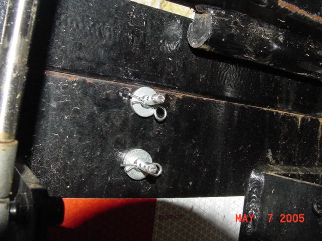

   / New Trailer at home...
#36
Then I clamped the bar to the trailer so it was touching the hinge, Drilled holes through the trailer, then installed 2 1/4" pins from TSC that have multiple holes in them, put some washers on the pin so when I put the clips in the pins were snug.

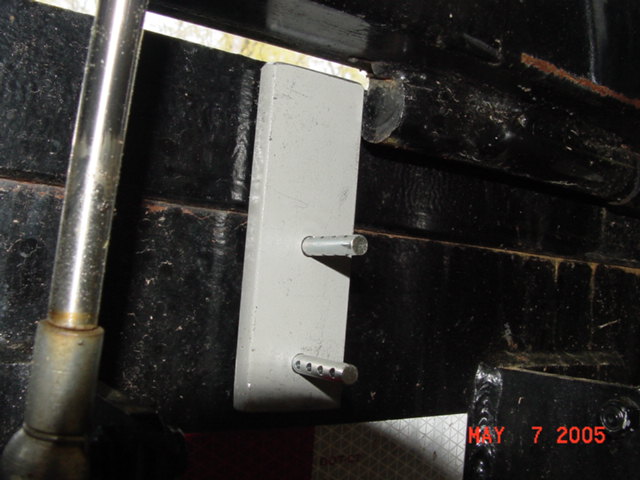

I test fitted the bar, marked how much of the pin I could cut off...

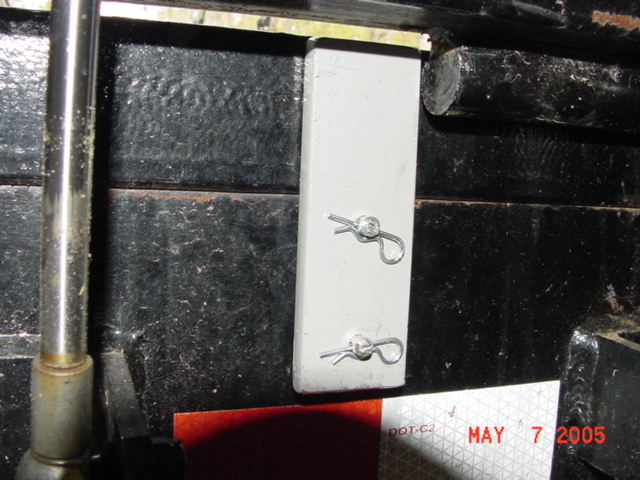

#38
And the final mounting, except for painting the bar black...

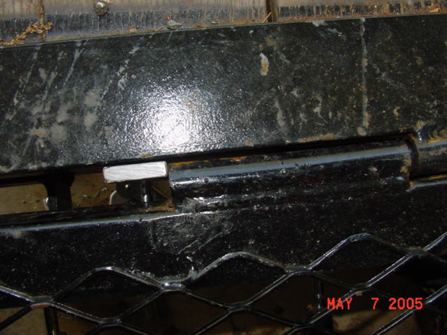

#39
Last pic,
Top view, the bar rest's on the hing keeping it from sliding left.
I chose this fix for a couple reasons...
1. I could not put a bolt right where the hinge is, the wood deck is in the way.
2. I wanted a way to get the gate off without tools, or having to get under the trailer to find the bolt head to take it out. With this bar, I can just flip it 180* to get it out of the way.
3. I could not easily see how to manipulate the gas shocks to have the gate "pushed" right. Mine are perfectly vertical now, so I do not think the shocks were pushing the gate left. Moving one shock mounting stud to angle the shock would not work in my case, the shock body would hit the bracket.
I hope this helps some, the pics are not the best, please let me know if I can help more...
   / New Trailer at home... #40
Hey, Hey, Hey! You da Man, Kenny! I really like that. And it's simple enough, that I think I can do it. Terrific!
Thanks for a great solution and for taking the time to post the details. I'll be looking into this for sure.
