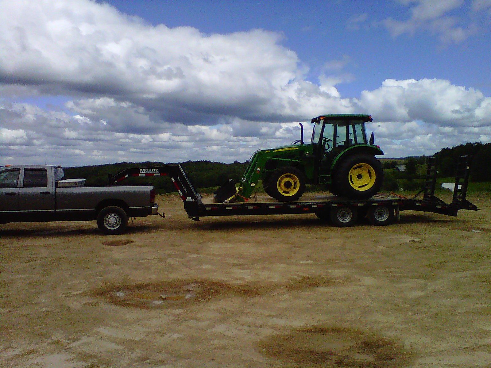

I have a 2011 Moritz 20+5 with a manual beaver tail so I can covert to a straight decked 25 footer. They also have a low profile option to get your deck height down to 33" like mine. Its a stretch but you can high step onto it from the ground! Its rated at 14.5K which gives you plenty of room for a dually to get to stay under your 26k number! They also let you get 7k or 8k axles under it. I had them put a 2" receiver welded inbetween the uprights so i could slide in a 12k winch just in case! I put the dual 600CCA batters in the tool box right below it!
