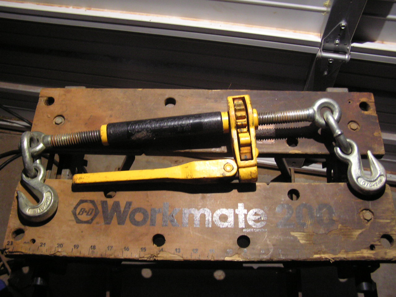

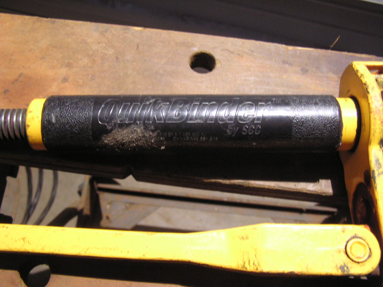

Review of QuickBinder ratchet binders with the folding handle.
Xfax, those are the exact ones I was referring to. Care to review them for us?
Matt

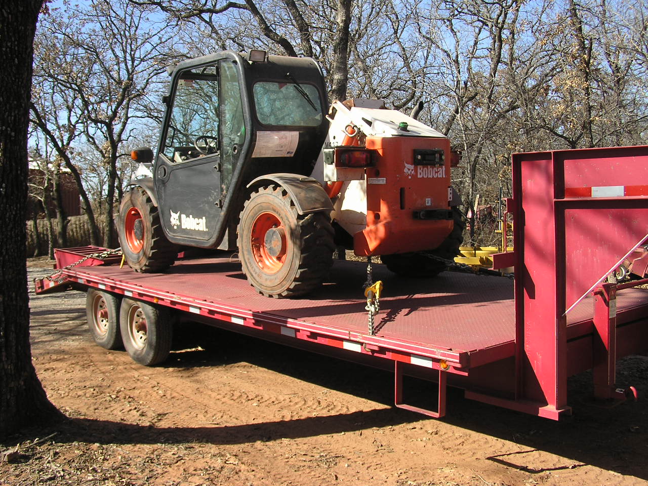

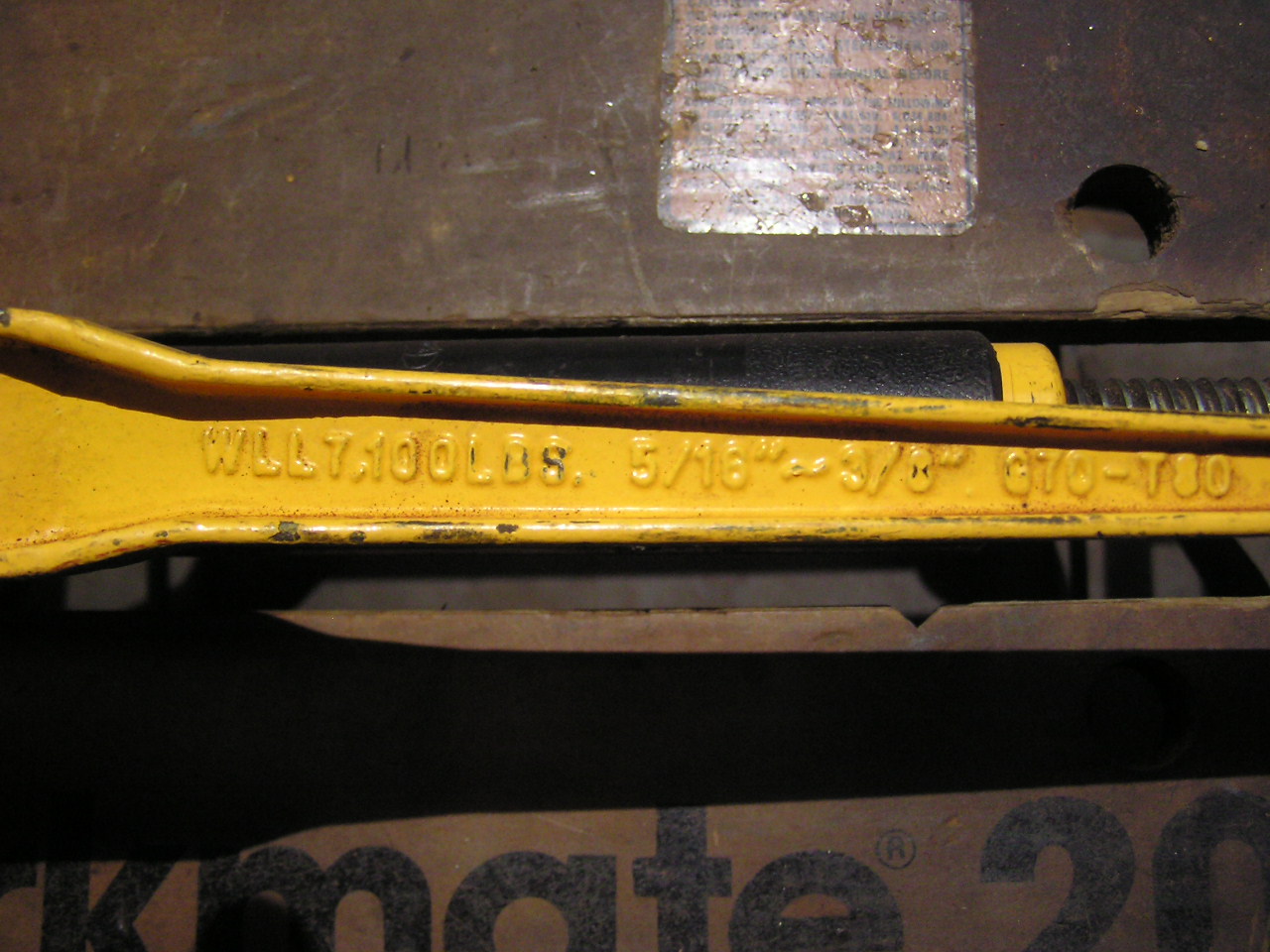

They work good like folding handle ratchet binders should. :D

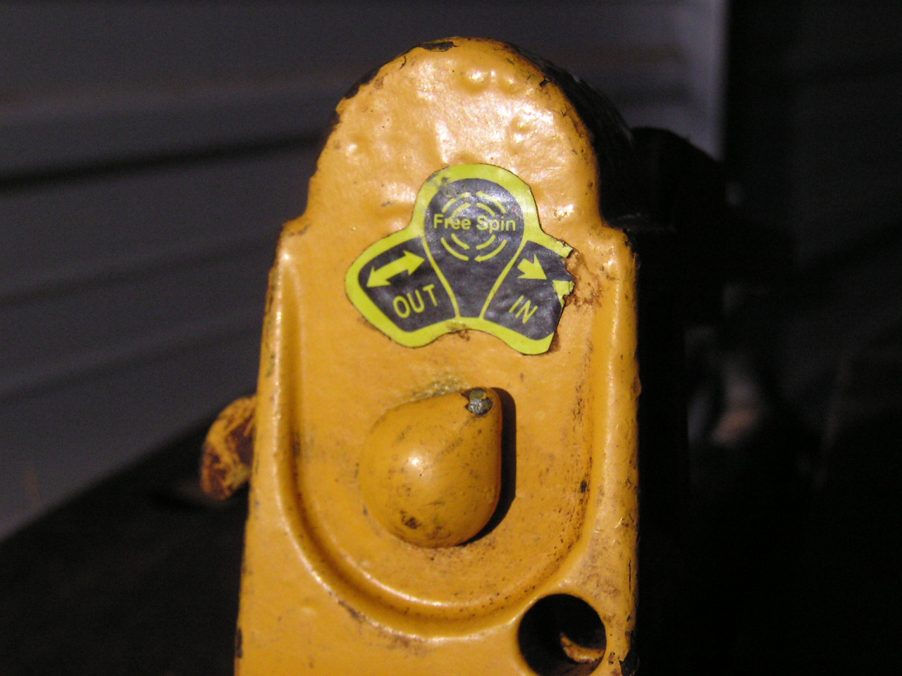

I like the free spin setting in the center, for quick adjusting in either direction. I bought them at Edwards Wire Rope many years ago.
They hold the V417 to the Delta.
:thumbsup:

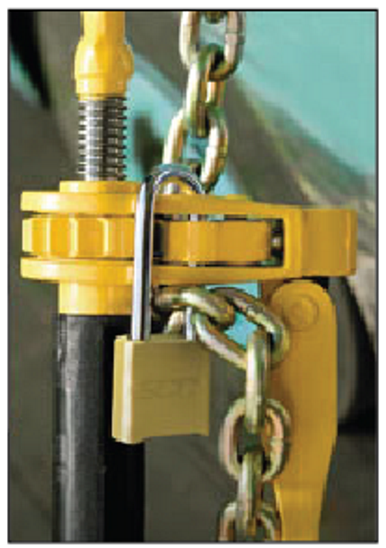

They can also be padlocked:

My binders are exactly the same as the ones pictured and described by Xfaxman. My experience is limited - only about 350 miles of use. I purchased them recently and they came out to a few pennies less than $50 each - shipped. They are made in China, but seem to be well constructed.
Peerless QuikBinder Plus Ratcheting Loadbinder: Peerless QuikBinder Plus™ Ratcheting Loadbinder
4 of them with 5/16 G70 chain held my approx 6000lb load like it wasn't even there. No adjustments were needed for my initial round trip.
