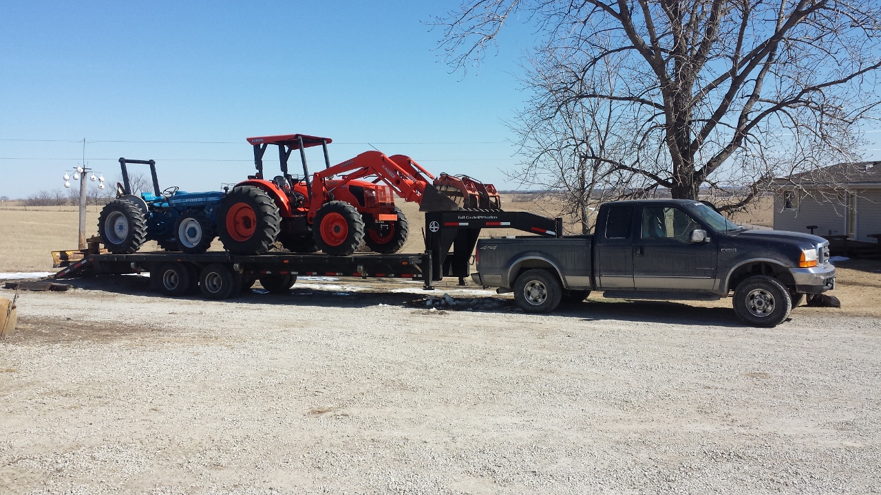

My '00 F250 supposedly has F350 spring kit added. I'm not sure what that entails. It sits level, not low in the front, when empty. It handles my GN trailer with little rear squat. Here's probably the heaviest rear axle load I've had on it. This is Grossing somewhere around 30K.

That is quite a load...
