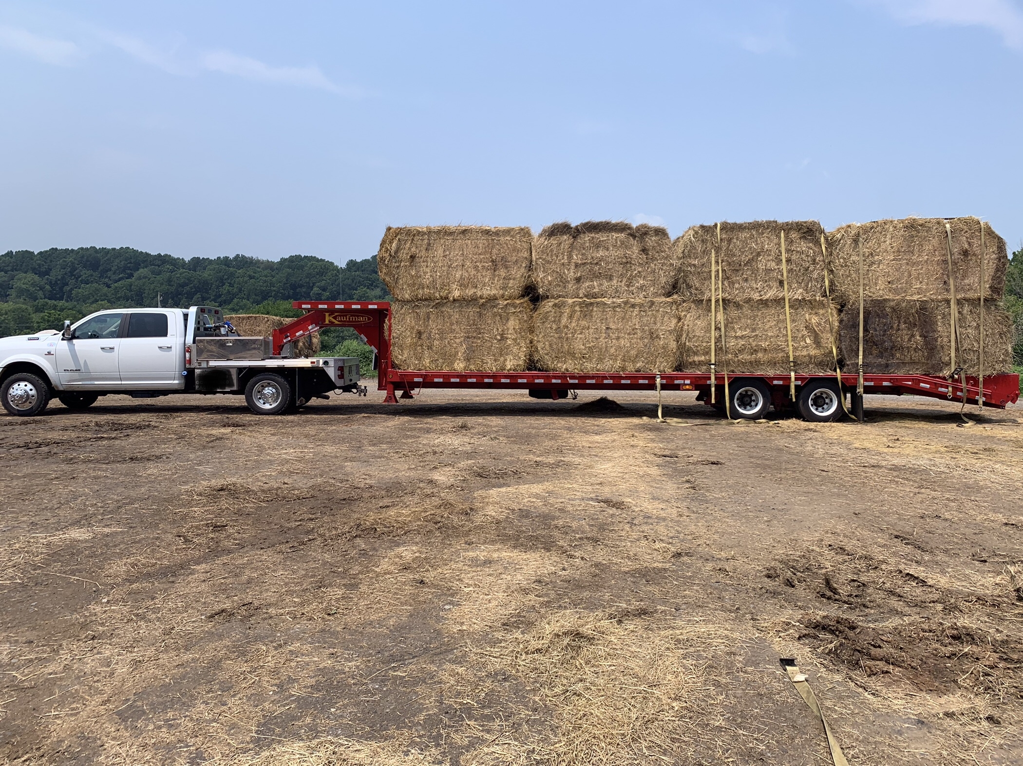

Hay Dude needs that, I bet he can haul at least one large round with it, maybe even two.
I prefer heavier loads lol

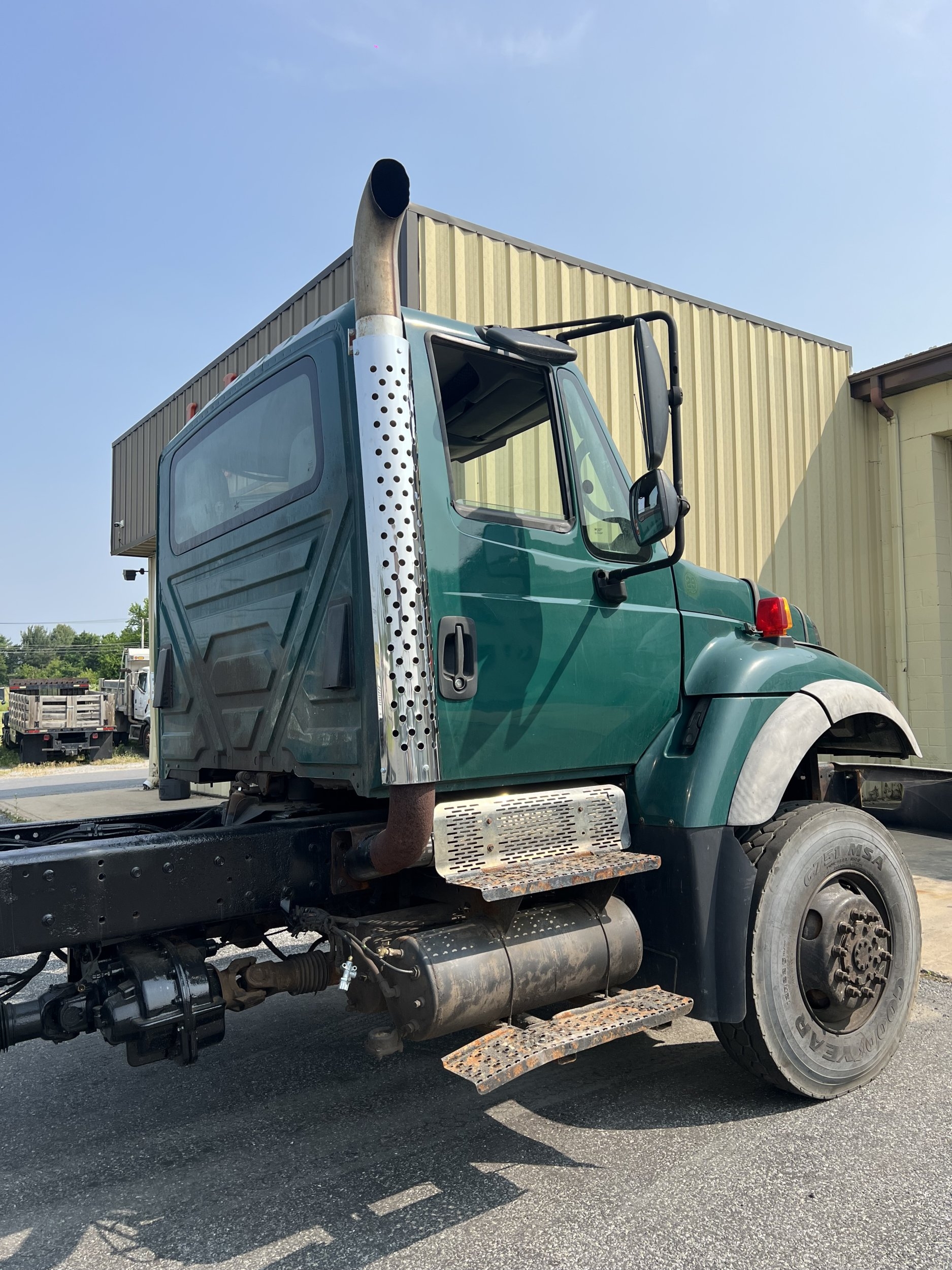

Got new turbo on truck and WOW what a difference! This thing will flat scoot off the line. :)

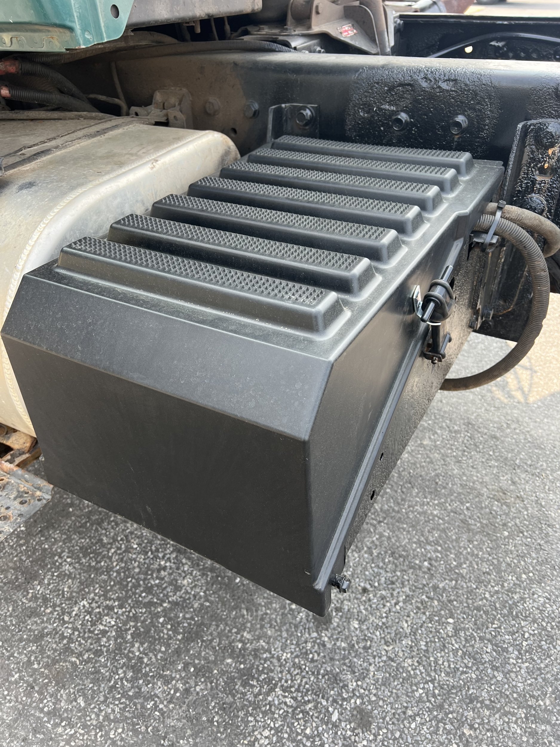

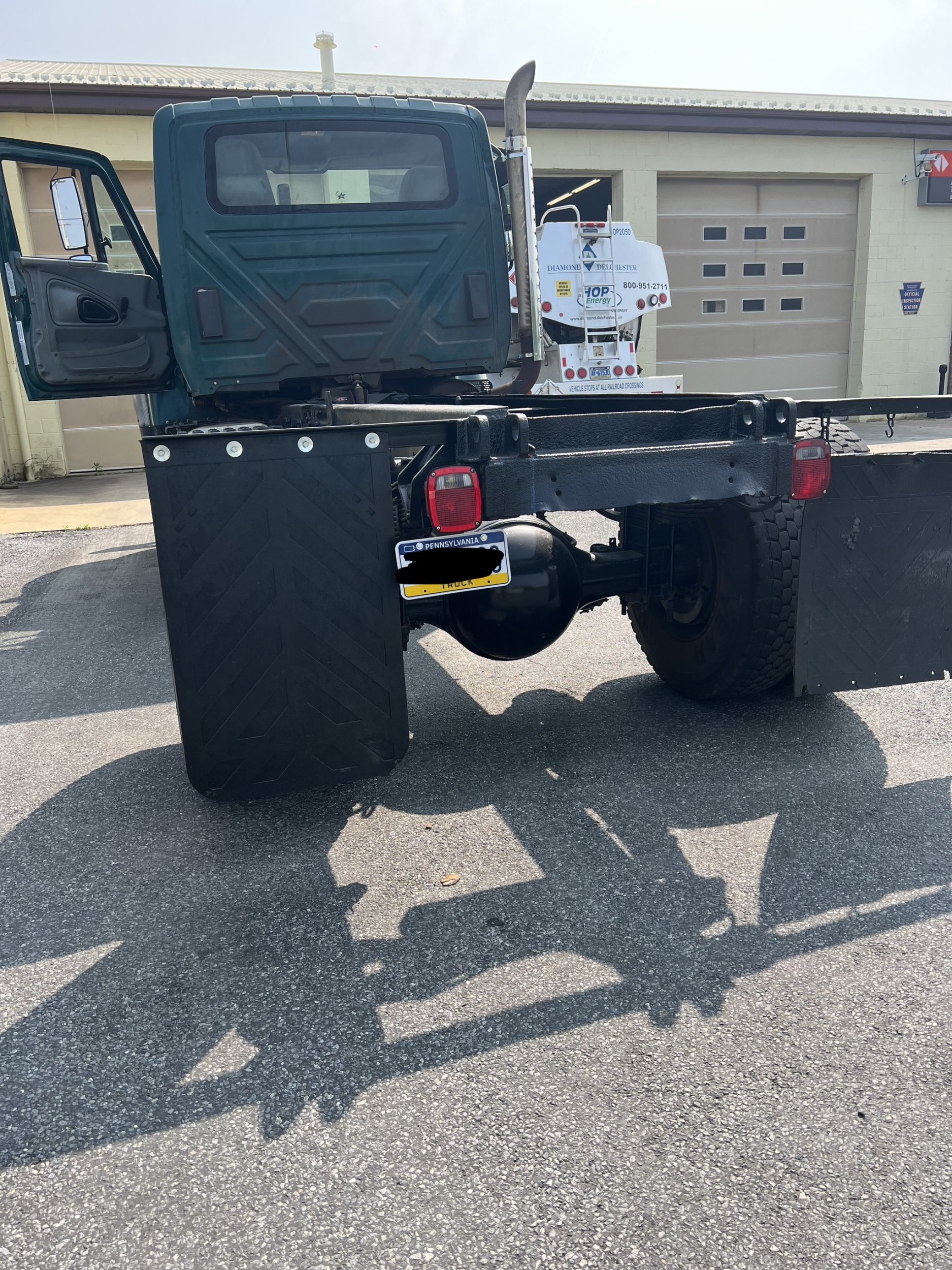

Small progress also being made in other areas. This week, after we welded up new exhaust pipe, I added a new battery compartment cover, new stack shield, tail lights and mud flaps.
You can really see the “scarring” on the outer frame right above the battery box. It’s like that in a few other spots. Inspection mechanic doesn’t think new outer frame is necessary.
Need to find (6) newer wheels. I can’t really tell if these are 9” or 8.25” rims. My inspection guy thinks they are 9”. IH spec sheet says 8.25”. The tires are 12R/22.5.
