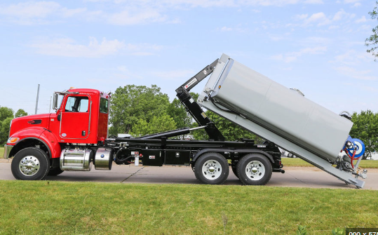

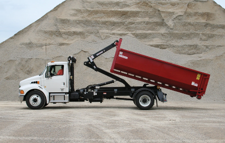

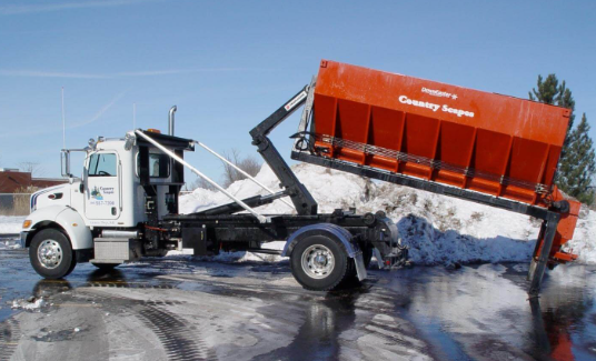

You ever consider one like this, able to change to different body styles, dump, flatdeck etc., not cheap tho unfortunately.
View attachment 798821 View attachment 798822View attachment 798823 View attachment 798824

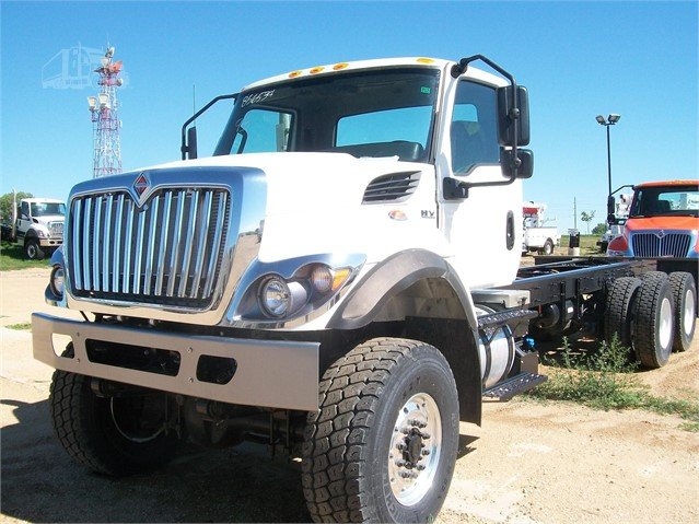

Yeah those switch & go set ups are pretty cool. I have looked at used units. Very expensive.
I think I am leaning towards a dump truck for the 7500. I have a contract to do a very large ditching job with it. It will pay off 1/2 the truck. It really depends on finding a nice 12’ used dump.
My end goal is 2 trucks. The 7500 4x4 I currently am building and possibly a 7400 6x6 20’ flatbed next year for hay. That truck will be registered for farm use only in the farming LLC.
Something like this with a 20’ flatbed.
The 7500 4x4 dump will be part of our property maintenance division.

That's a nice looking chassis
Yeah, I passed on that truck about 2-3 years ago. It was offered to me for $115K. There was 3 of them ordered by a utility company and they lost their contract. Stuck dealer with them.
Loaded & beautiful trucks.
   / New (used) IH 7500 Dump Truck purchase, modification & fix up
#207
That's approaching pickup truck money these days !
Funny, aint it? 3 years ago, I thought that was expensive. In todays hyper inflation economy, that seems cheap!

I had a Stellar hook lift on a F750. This system is fantastic but in my opinion needs to be on a tandem axle chassis for realistic legal weights. (heavy empty weight for a s/a)
