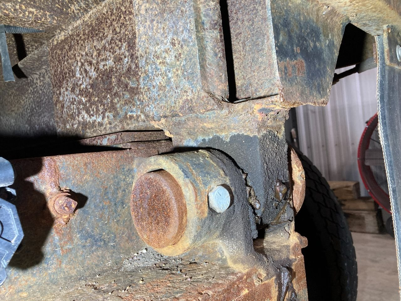

Here’s the listing. I still don’t see a tailgate release handle. I don’t see any linkage for one in the pictures underneath. There is a cable of some kind in one picture.
This looks like linkage to me (right side of picture by the mudflap):
Most newer dump bodies have the air tailgate and the cable runs to the hyd valve on the pump to stop the body at full lift (pulls the valve to neutral) .
