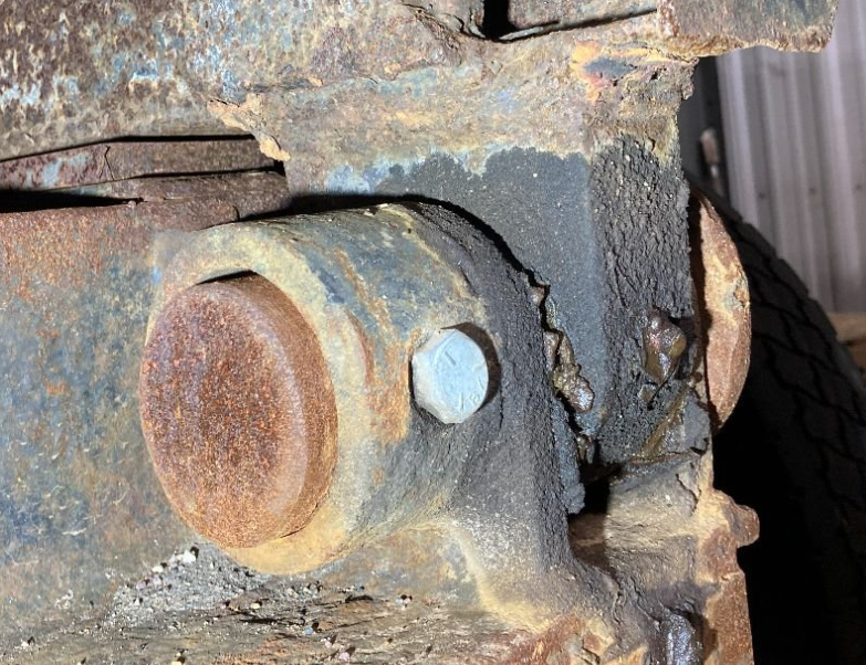

Anyone of the opinion that the body is light-built, or light duty?
I don’t think its a Beau Roc or a real HD body, but I want to make sure it’s not 1 step above aluminum, either.

That's going to be something that's hard to tell unless you're actually there to 'bang' on it.
One thing that does give me cause to think light duty is the hinge:
The actual ear is 1", 1-1/4" thick? any I've worked on are at least 2"-1/2" as well the cheek plates are 1/2"?
What are the bunks, channel or tube?
Definitely not a BeauRoc

I will have the opportunity to redo those when the body is mounted, but you make a good point.
I want to make sure it’s not a glorified mulch or sand body.
