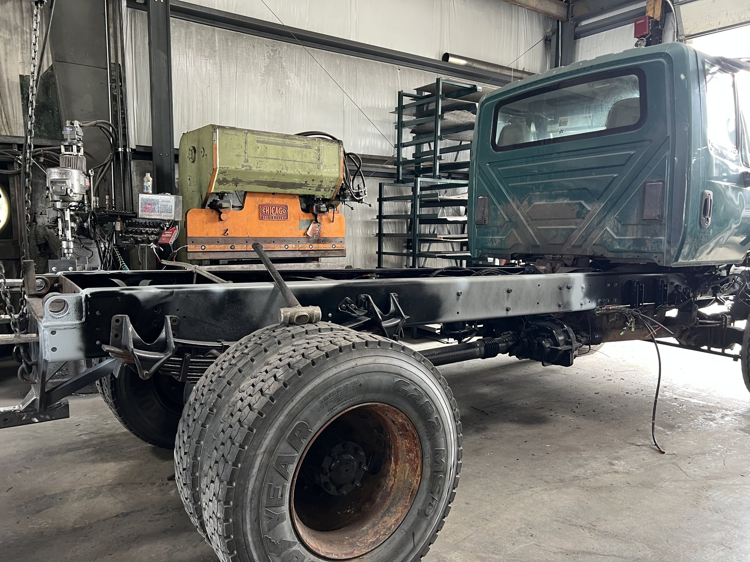

Your guys obviously know what they're doing, you got a good crew. Crossmembers look good.
You going to spray them with undercoating between?

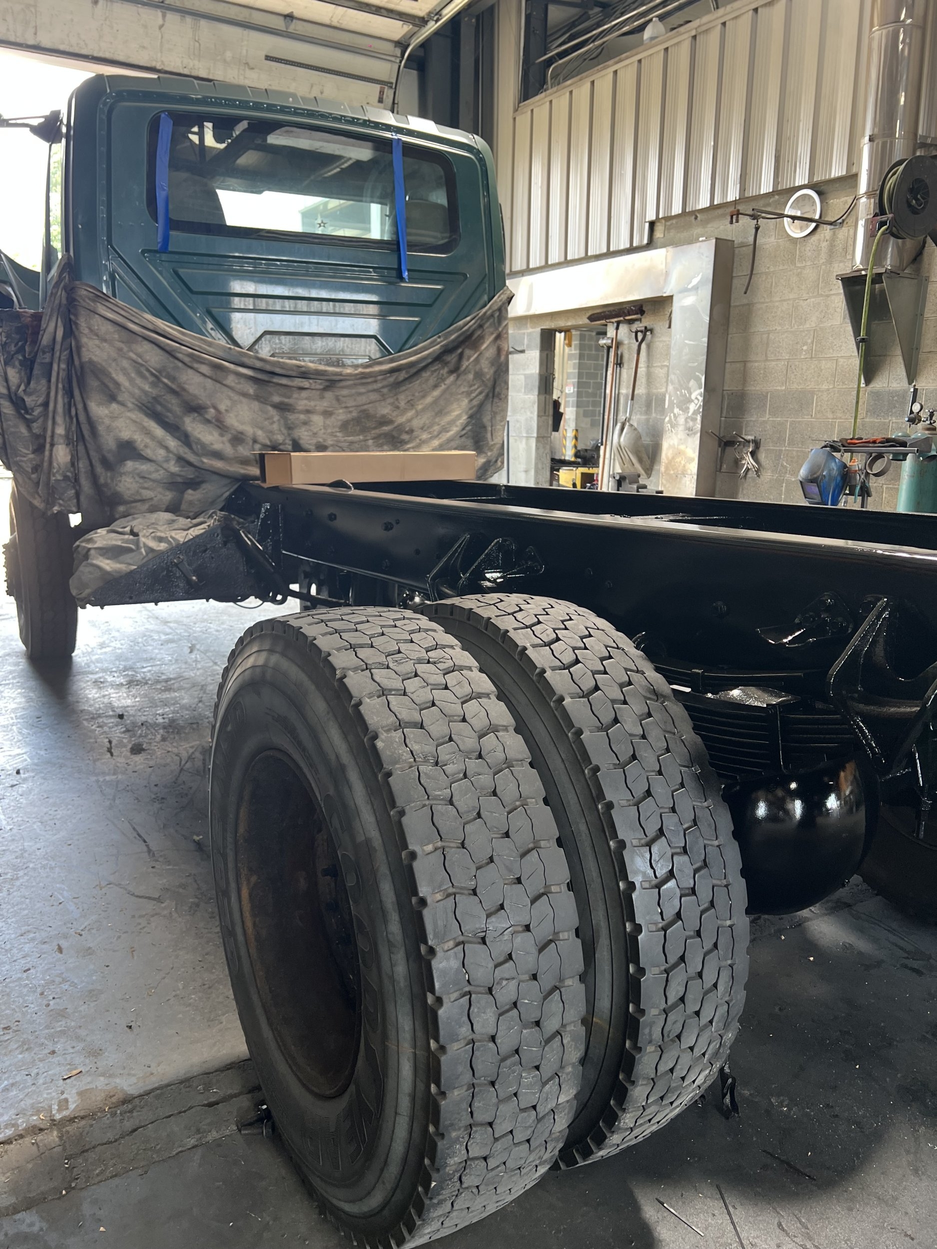

Yes. They surprised me when they repainted the inside frame. I thought they were just going to wool wax it, but since they used it as a drilling pattern, the holes became exposed metal. Probably took very little extra time to shoot the inside frame. It was scarred-up pretty good, so I’m satisfied they made that decision.
Crossmembers don’t look too bad, I agree. I thought they would have looked worse. They are painting those, too.
PTO gets here today. I have to decide on the trailer air brakes soon. I gave them the go ahead on the electric brakes and brake controller. Looks like this truck has never been used to pull a trailer.

More progress today. Other side frames were installed. The’ll be painted again to get all the bolts and one more coat on the frames.
Also pintle plate was welded and braced/gusseted on. A 30 ton swiveling pintle hitch will be installed above the receiver tube. The receiver tube (for lighter trailers) is 12 ton rated.
Air lines run to the rear with glad hands and electric with trailer brakes run to the rear coming next. Wet line equipment ordered (PTO, pump, tank, lines, etc.)
Then the dump bed.

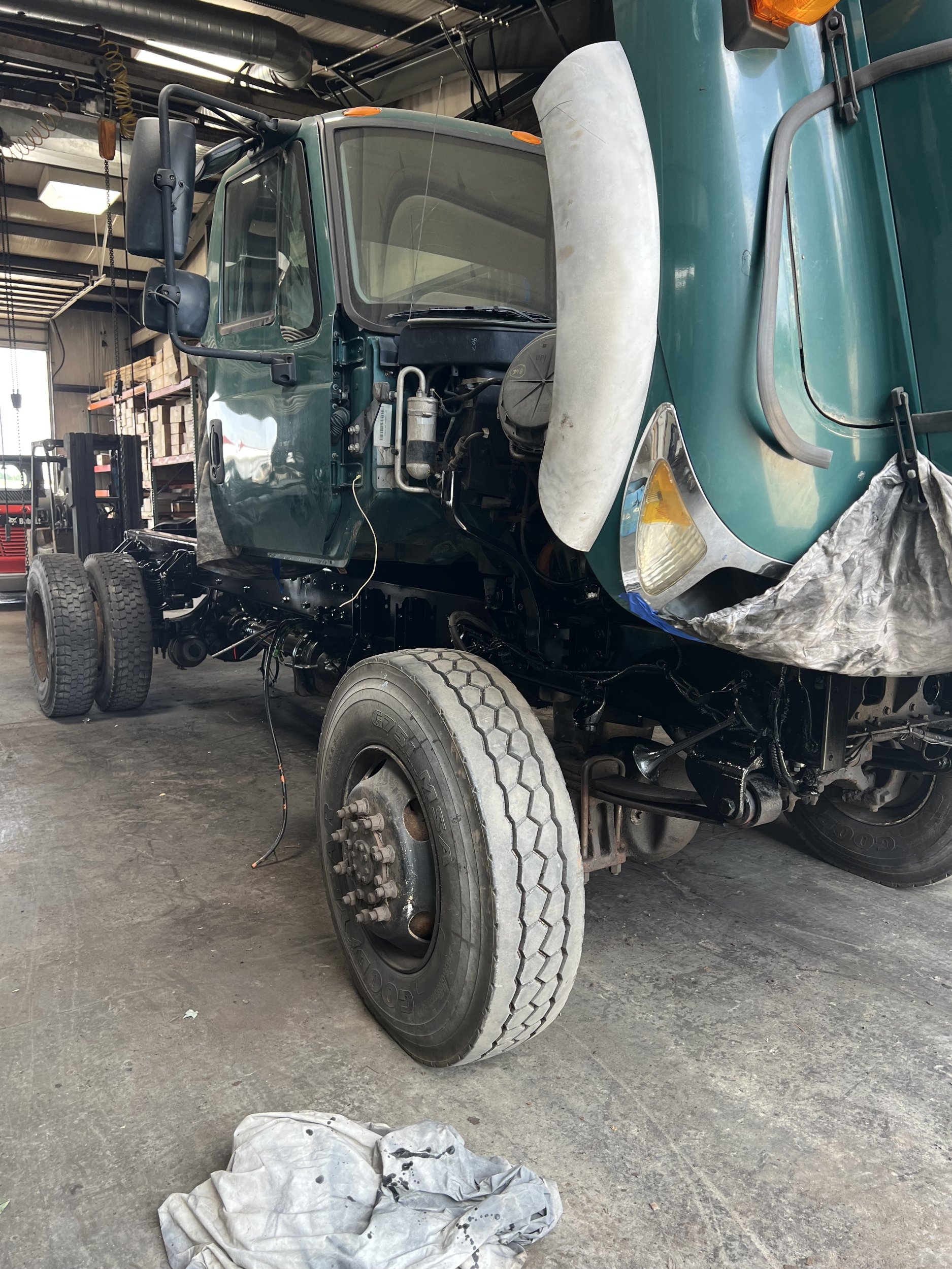

Stopped out again today and they painted the frame again.
Coming together!
Wonder if there’s a paint that would look good on the fender flares? They have sun faded badly. Or maybe just replace them….

You can take a propane torch to them to rejuvenate the gloss of them did it to an old four wheeler once brought it back bright green better than new looking just have to be careful with the heat and speed several youtube videos
   / New (used) IH 7500 Dump Truck purchase, modification & fix up #307
Rustoleum Recolor Works.

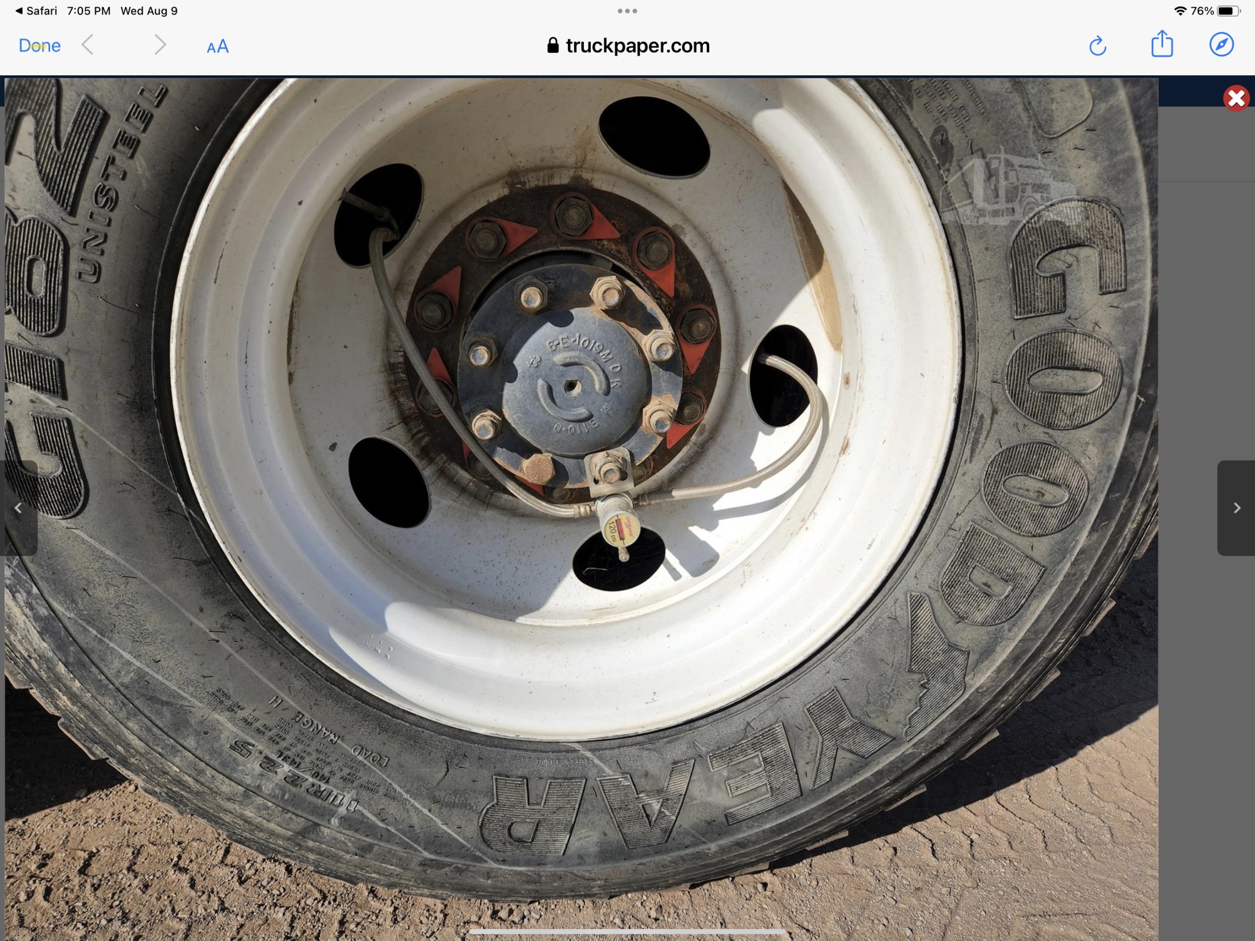

Starting to think about the replacement wheels. I’d like to install these on the rear axle. Just thinking about if they’d get damaged off road.
Also what, if anything else, I should be thinking about for a dump bed tarp, bed vibe, bed lighting, etc. My wallet is still open, but closing soon LOL
