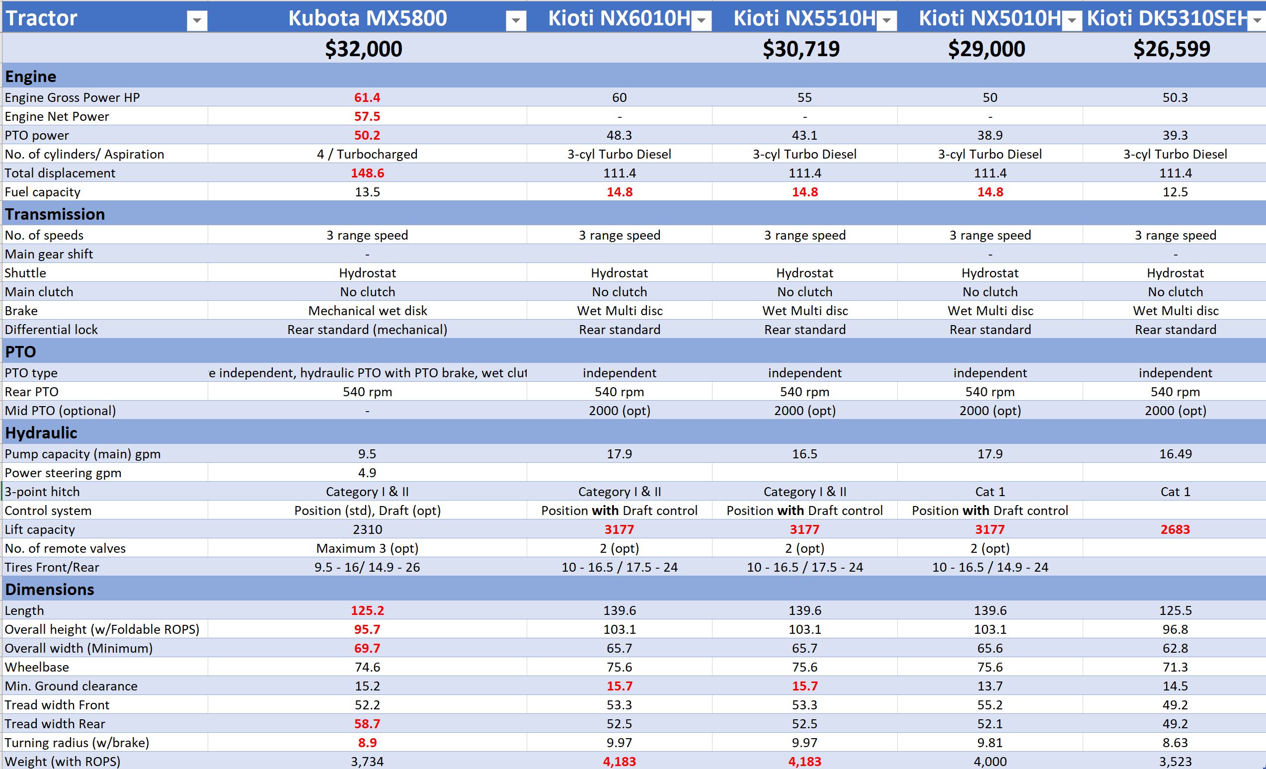

I would consider Kubota even with the crappy dealer but I do not think their tractor is in the budget. An MX5800 with a loader, bucket and rear remote is $37k before tax on their website. Is street price going to be much less than this?
A discount of 8% off MSRP seems average.
Kubota's incentives to the dealers change every quarter. If the stars/rebates line up auspiciously, discounts of over 10% are sometimes negotiable.
MX series are 3,800 pounds, bare tractor weight, 1,200 pounds less than Utility Class weight.

Thanks for the advice! I think all of the tractors mentioned are around that weight - probably not the 4066m though.
The neighbor would let me use her land for no charge and wouldn't expect to be a partner in the financial sense. She just wants the hay mown without having to pay someone to do it. I don't expect to make money. In fact, I imagine it will be a loss most of the time. Thatエs okay.
Kubota MX 5800 or an M series
