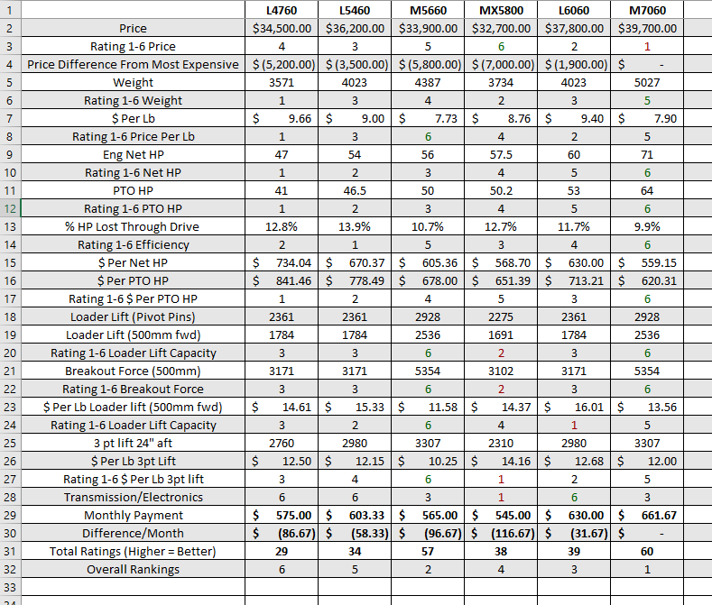

I'm going to try attaching the spreadsheet I've made on 6 Kubota tractors I've been considering. Please note that I've gotten quotes from at least 3 different dealers on most of these models and 4 on one of them. I listed the cheapest quoted price on my spreadsheet. The price range between dealers has ranged almost $4K on the same model of tractor with the same confirguration!!!
If you have questions about the ratings, just ignore them. I may have had a beer or two when i was making this but more or less the machine with the highest rating was better (to me) than the lower rating. All are rated 6-1 except the transmission. I scored the HST+ from the Grand L series higher than the Power-Shuttle (for my needs) and the MX series the lowest because i don't particularly like the treddle peddle.
I would add the M5660SUHD to you list of tractors to consider. I am leaning very heavy towards buying one very soon. One other quick thing about Finacing. Kioti and Kubota are the two primary tractors I've considered. Kioti are substantially cheaper if you can pay cash. If you use their 0% financing you are going to pay $4500 more for the NX series or $5500 more for the RX series. Kubota's price is only $700 difference between the cash price and 0% finance price. If you do a bank loan or commercial financing, most interest rates are going to be 5-6% and if you calculate that out over 60 months you will end up paying more for the Kioti's then the Kubota. From my expereience selling 3 Kubota's over the years and a Kioti... The Kubota will be worth substantially more for resale wise and have a much wider pool of potential buyers. I really like Kiotis.. lb for lb and dollar for dollar spent i think they are a better value.. But you should just look at all avenues. BTW.. the Kubota dealer 10 mins from me has been consistently $2-4K more per tractor then one 45 mins away that has had the best prices across the board... Difference is one is a Car dealership that started selling equipment as a side business (In the City) vs small, tractor only dealer, out in the country with very little overhead I'm sure.. tractor.PNG

I forgot to mention, all of these tractors are Kubotas, all are open station, 4x4, loader, R-4 tires, and a 3rd function valve installed for the price on my spreadsheet. Keep that in mind when you look at the price. The 3rd function valve is close to $900 and $300 to install it on average. So if you don't need a 3rd function, you could save about $1200 off these prices.
