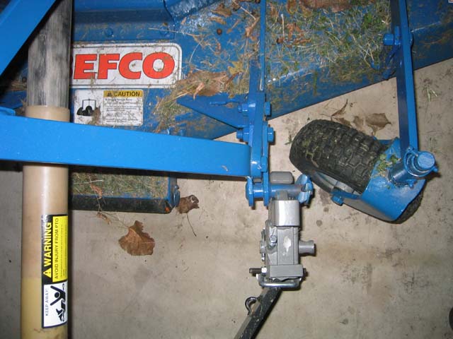

There has been a lot of posts about how the Pat's Easy Change system could prevent implement pins from connecting up square to the Hooks on Pat's system. The Easy Change allows for adjustments to make sure the pins have good square contact to the hooks and do not rub on a tangent, creating undue and uneven wear.
Here is a picture taken directly over the top of one of my lower link arms showing that the hook on the Easy Change is square to the pin on my Befco Finish Mower.
Hopefully the picture should clear up some confusion.

bob i think you are the one confused here, i understand that you can adjust them to square with the pin, but when ya change to an implement with a different width, then they wont be square, unless ya readjust them. also a 3pt linkage has some side to side play in it so they wont always be square to the pin, bottom line is that when they invented the 3pt hitch in the 1930s they put the swivel eyes in for a reason, and they have been on every 3pt hitch since then, i dont see why pat thinks he can improve on that.

You are correct about the fact that they may have to be readjusted from implement to implement to make the perfectly square to the pins, however the practical difference of the angle differential is virtually nil between one implement that is 26" wide and another that is 28" wide from pin to pin.

markct. . . one more thing, I set the Pat's Easy Change so it is square to the pins on my Befco Finish Mower because that is the implement I use the most. In the 3 seasons, when I use the most, the mower deck is used 75-to-85% of the time and if the pins were not square to the hooks, it is possible that I'd get some premature wear that would be noticable in just one season.
However, I use a PHD and various blades/box blades as well, but typically for a few minutes to a few hours at a time, and they are only slighly narrower at the implement's A frame than the Befco deck. Consequently, I don't thing being "off" just a few degrees on such lightly used implements will wear out their pins in any noticable manner. I might be wrong! But so far I don't see any wear on the blade's pins that I use, and it is the 2nd most used implement I own. Granted, it has only been used for about 1.5 hours since I've gotten the Easy Change installed. And if I had to guess, I would say the Easy Change hooks are only about 2-or-3-degrees off square when using the blade. And it is hard to judge that because one side is perfectly square the other side might be off a bit and visa-versa as the hooks allow for some "slop" in movement anyway, probably to compensate for the fact that there are no ball eyes.
Again, I never said the Easy Change is perfect. But for me, with frequent implement changes, it is the perfect COMPRAMISE. /forums/images/graemlins/laugh.gif
