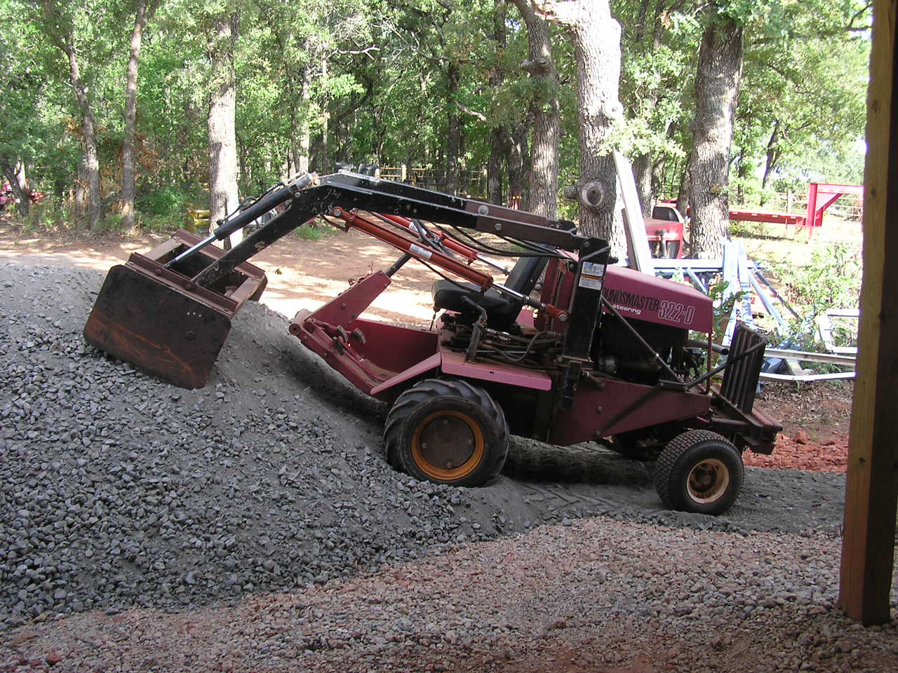

So I finally got around to checking my loader with a round bale. No luck lifting the tractor even while pushing down on the top of a round bale. I know I am not pushing the stick to float and I can feel a little vibration in the stick when it contacts the bale or ground. Is that a relief valve opening?

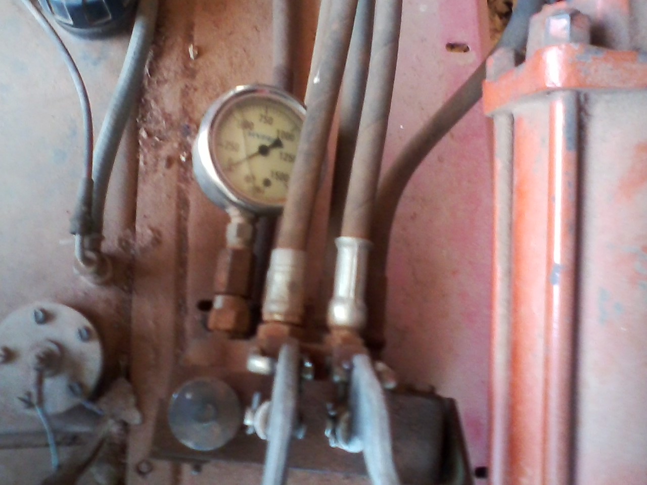

The best way to see if the relief valve is opening is to put a pressure gauge, were you can see it from the seat, in the line from from the pump.
Use the Google Custom Search box at the top of the page, there are several threads about it here on TBN.

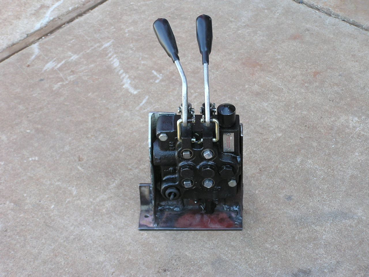

I put a gauge in the alternate pressure in port on the loader valve:
The pressure in ports are on the right side:
Valve mounted, with pressure hose and return to reservoir hose:
It is next to the seat on the left side, just look down to see the pressure reading :thumbsup:
