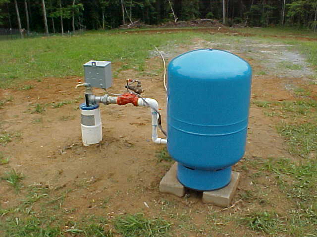

Here is a picture of the other side.

I'm in central NC and I built a box, roughly a 5 foot cube, around the well and pressure tank. I insulated the box and I put a CF bulb in to provide heat. Even when it was cold here the box stay around 40 degrees. This was a temporary installation until we decided what to do. That temp installation has been used for 20 months or so. :D
Long story short I started designing a well house this past week. I don't need permits if I build a 12x12 shed. So I'm going to build a 12x12 shed. :D Our well is currently on a roughly 5x5 concrete pad. I figured I'll just extend the pad to at least 12x12. Maybe larger for a pad in front of the door. The current plan is to make the walls and roof removable so I can lift them out of the way with the FEL/Pallet forks if I need to have the well redrilled or pump pulled. I need some storage space and this would work as well as providing us plenty of space to add a filtration system in the future.
Some of the pictures of what other have done make me wonder if their solutions would work better....
Later,
Dan

I've also been looking at building a well house for a 4" submersible, 250 gallon tank, and water softener. Waiting on some bids to come in for it. I also talked to the guy that put in the well (he's been doing this for 25+ years) to see if he had any suggestions/tricks/tips on the design, i.e., removable walls and/or roof. All he said to do was make sure there was a roof turbine or something similar directly above the well in case he needed to pull it.
My will probaby be 8' by 12' and have a two windows as well as the door for ventilation. Whats the reasoning behind removable walls/doors? My well is about 150' deep and has a 1-1/4" draw pipe.
Ira

My thinking is that if for some reason the well requires a well truck to fix the problem then the walls would have to be removed and thus the roof. I was talking to a couple of guys yesterday who have repaired wells in the past and we came up with at least three different pipes running to the pump. Some of the old wells have galvanized pipe, I have seen what looked like PVC, I *** THINK *** my well is using a black plastic pipe that is seamless and this would be easier than the other pipes to pull out. But it would still require some headroom.
One of the guys had his well collapse. It was about 220 feet deep. The fix was to redrill but then add gravel to keep the well from collapsing again. Now the well is 80 feet deep with pleny of GPM but no reserve.
That is why I think the wall(s) and roof have to be removable....
Later,
Dan
