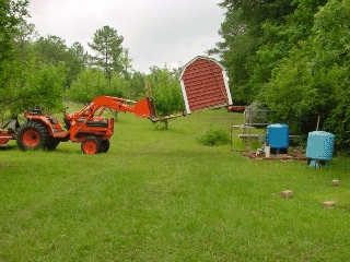

I built this little "well house" from scrap and left over material. It more or less matches my full size shop (barn) with the gambrell roof.
Here is a pic of it being replaced after the tank had to be replaced a couple of years ago.
Very nice work. Did you pour concrete around your pump or what did you anchor the house to? Also is your well bored or drilled? Tell us more about your well. I saw two tanks, how many gallons per minute is your well? How deep etc. Looks like you have a nice spread there and maybe that is a Kubota.... Tell us more about your tractor as well :D

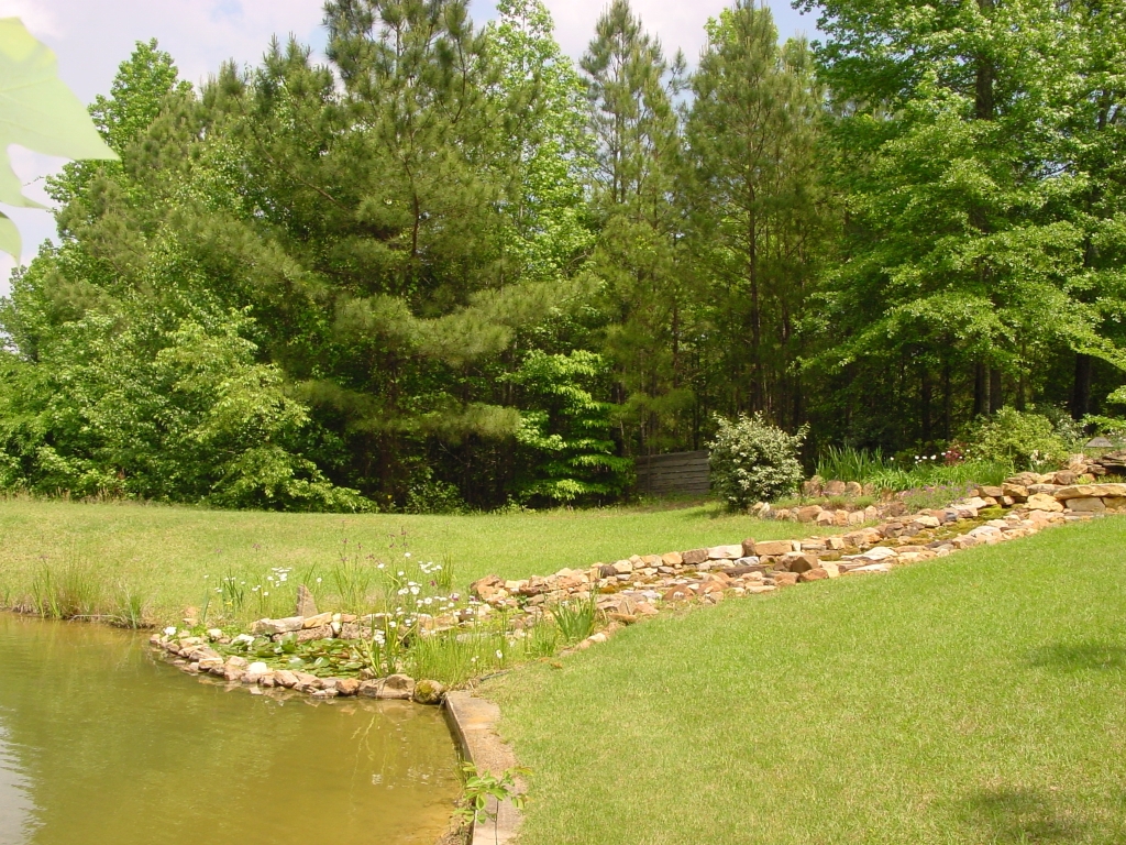

Jim I don't have any more pictures. The frame was from scrap aluminum, got my son to weld it together. Wood framing was attached to aluminum. Then I had some 3/4" insulating board that I used to cover the outside. The red vinyl siding was left over from the shop/barn. I then framed the roof section, took it to my sheet metal man and had him apply the metal roof. Then the roof section was bolted to the wall section. I only have one tank, the other one had the bladder burst and this was after replacement when I was re-setting the house over the DRILLED well 230 feet, hit rock, pump installed at 185 feet, 30 gal/min. It runs most of the time. I keep a slow run to keep the pond full. The pic is at the pond, did not want to have a plain pipe running so we started gathering rocks and built us a "mountain spring" to keep the pond full.

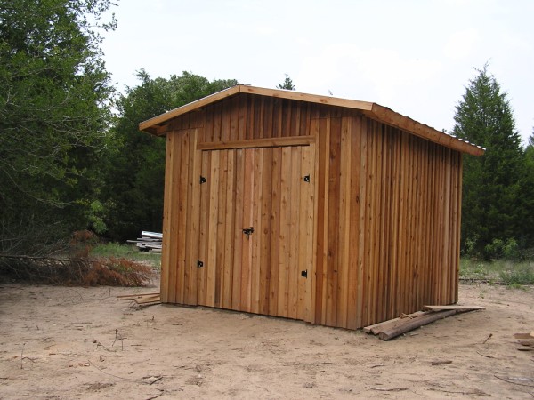

I built a well house / garden shed - just finished -- I built the back corner so it could be removed easily to work on the well. cost about $2k -- but I wanted to use the vertical cedar here as a test before I used it on the house we want to build in 3 years.

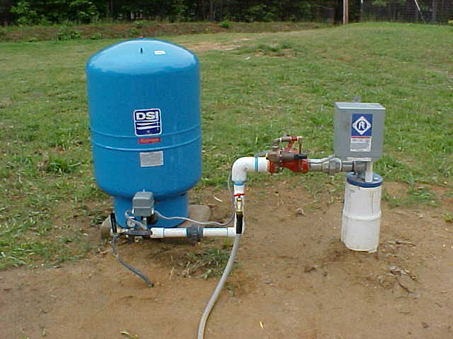

The well was installed (drilled) at over 60 gallons per minute now... it has actually been tested now at nearly 80 gallons per minute. Not sure why it increased but I am glad it did. It was installed to irrigate our Food Project to help others. You can see the last few posts about the Food Project here http://www.tractorbynet.com/forums/showthread.php?t=63526&page=99.
We are still looking for someone with a trencher to help install the system. Maybe we could trade for a trencher or something. If anyone has a lead to getting a trencher please contact me at bsm357@aol.com
I have attached a picture of the well and tank.
Thanks,
Jim
