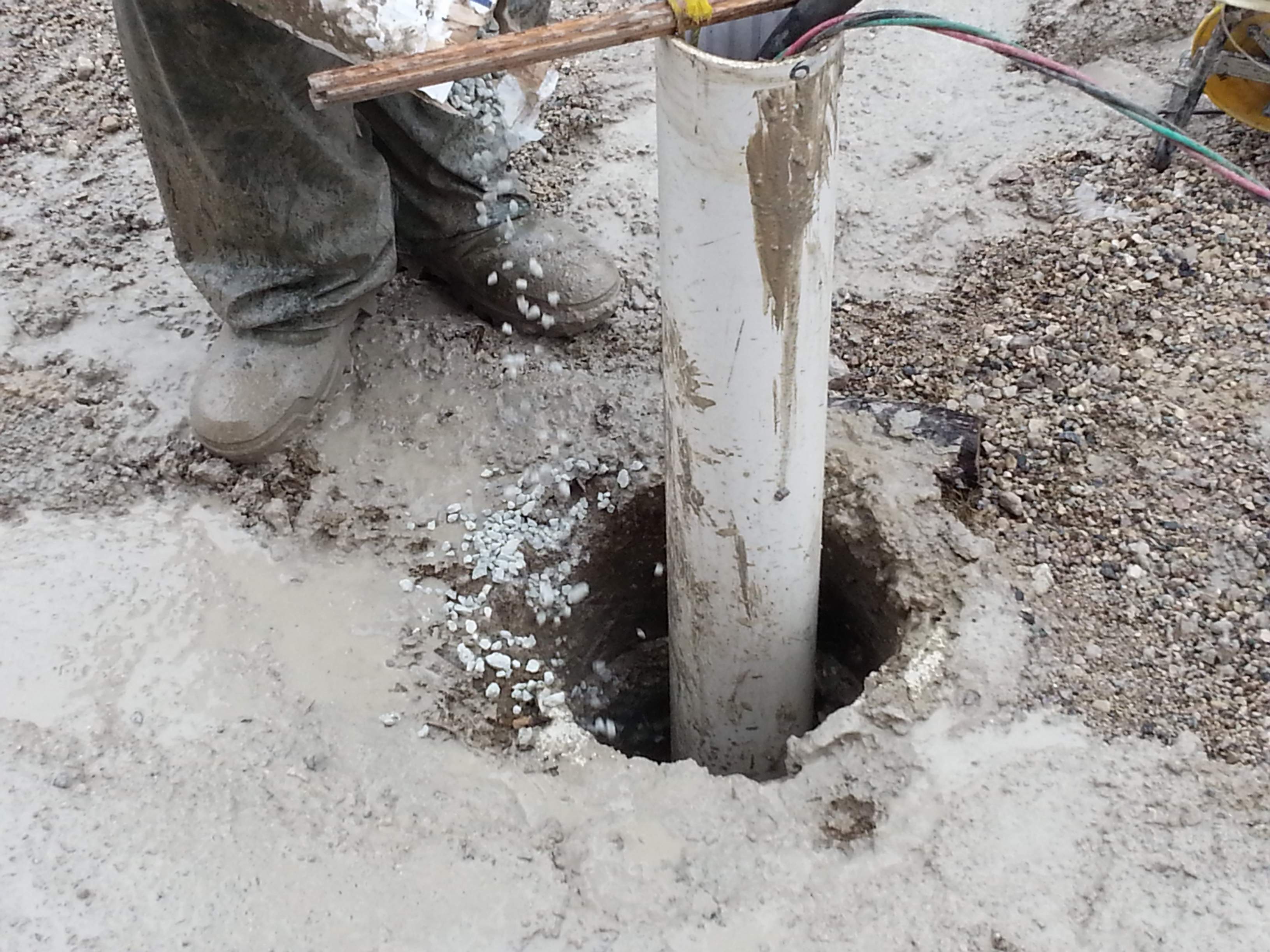

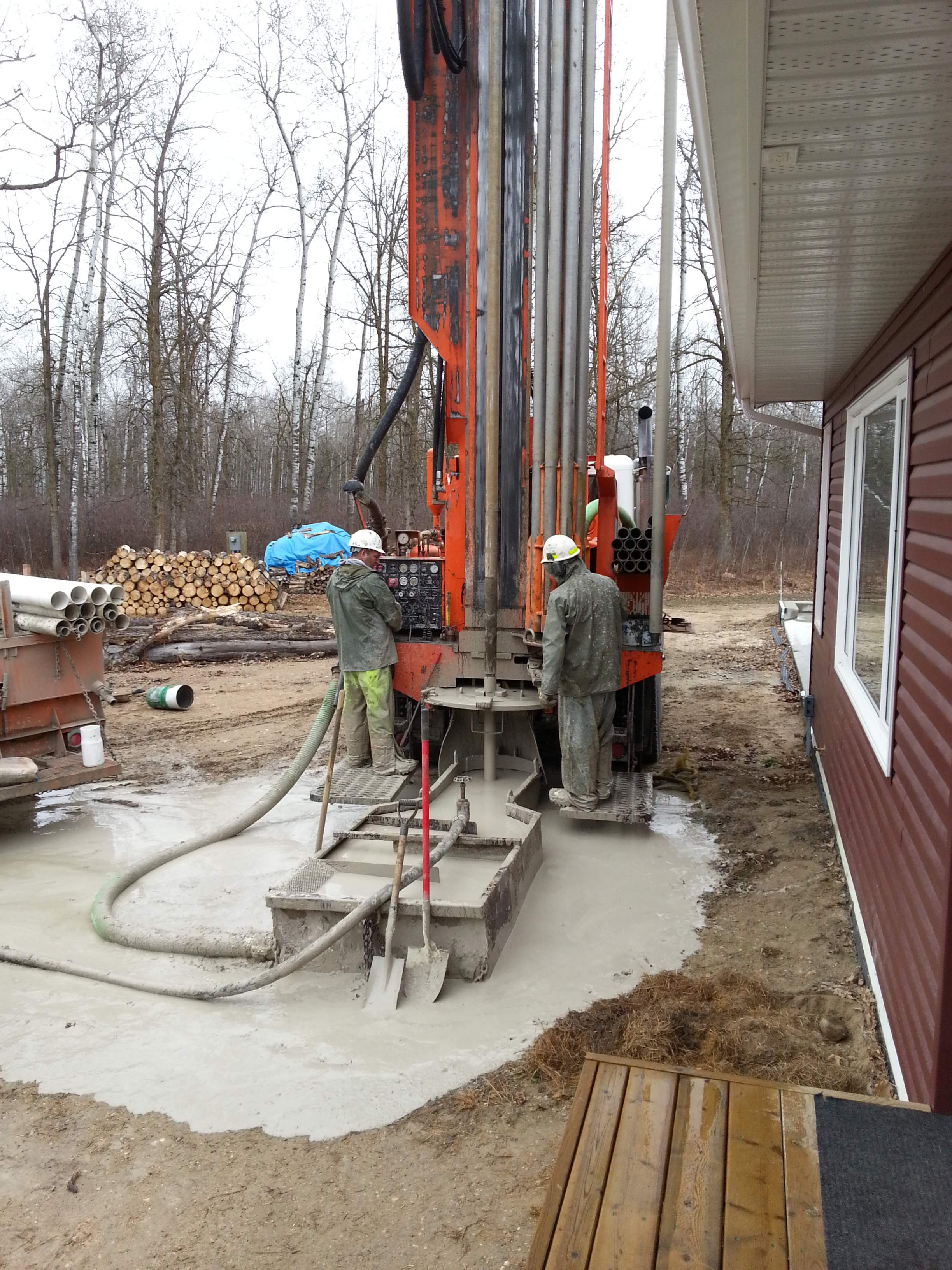

The wife and I got a little sick and tired of running out of water, 5 times since we moved in at the end of December 2011. Our old well is 27ft deep with a concrete casing at the bottom and a 15ft long 30 inch diameter culvert pipe stuck in the middle of the casing that travels up to the surface. That thing takes a longtime to replenish so it was time to do something about this, heaven forbid you'd want to take a shower, do a load of laundry and then flush the toilet lol. Also I had extended the water intake line as close to the bottom of the well as I could. This worked for awhile but in the end we had a local company come out and drill.
This new one is 137ft deep, casing is at 116ft, just need to get it hooked up to the house. My plan is to remove the submersible pump from the old and put it in the new. We won't seal off the old well but we plan on getting a hand pump and I'll whip up a better lid as the one that's on there is concrete and about 7 inches thick. The old guy that owned the land was paranoid about someone falling in, sheesh it takes 2 men and a small boy to remove the friggin thing, or a buddy with a loader. Anyways here's some pics of the expensive day.

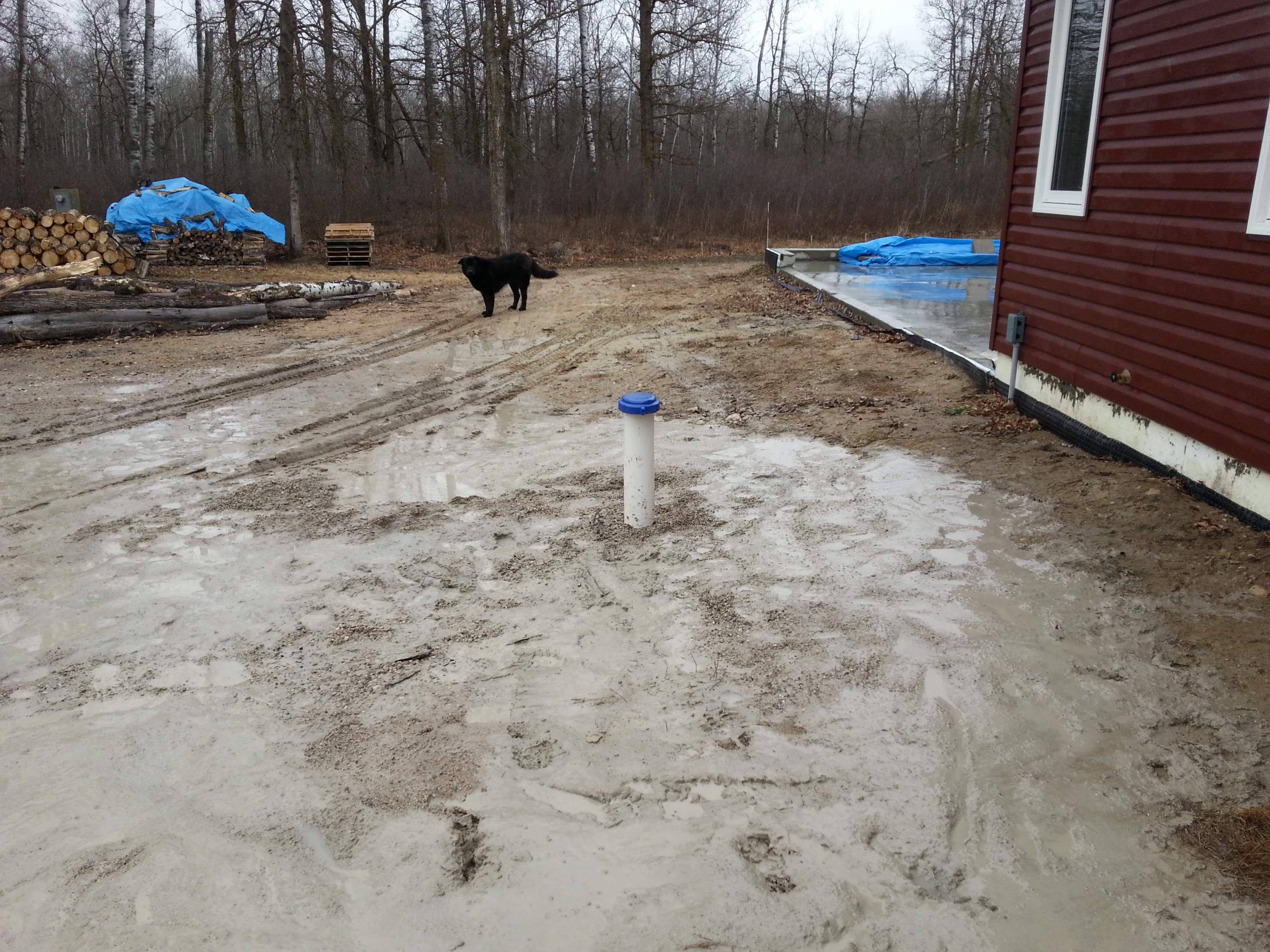

Saw that 3rd pic with just the well head poking out of the ground. What is that white pipe? PVC? Is the electrical below ground?
Down here in Missouri they require 80' of continuous steel casing (i.e, four welded 20' sections). After that its up to you but everyone with any cents runs PVC casing all the way down.
My well in '08 was 340'. Water popped up to 200'. Pump placed at 240'. About the same price of 5 years of water bills back in the city so I'm already ahead.
Bob
I'm wondering the same thing. PVC there is just asking to broken off. It also deteriorates from direct sun. It may be painted steel (hope it is).

The current rate as of last week when I spoke to the project manager of the company is $32.50 per foot. The casing is white PVC for the entire un. We plan on covering it with a wishing well and that side of the house is quite shaded. It's not operational as of yet because the drillers don't do any hook up at all, I'm going to go see a friend from up the road and see if he and I can get it done, plus he's got a backhoe. If not I'll call the guy that originally did the old well hook up/septic system.

I just had a well drilled for the house I'm having built in Chesterfield, VA. Don't know the cost of the drilling but looking at your picture I had to have mine drilled 50' from the house, whie yours looks like it's right next to it.
It's 8 ft from the house, about 2 ft away from the old well lines, my reasoning for this is because 1 of the 5 times we ran out of water was because of my dumb### driving over the line everyday. I thought it would be ok but it drove the frost down like 8 ft!!!!!. It was an unusually cold winter this year and I want to insulate the pipe. Myself, and a few people I've talked to, agree that some 1" form board a foot or two above the line will stop that from happening. One guy around here did that and his line is only down 5 ft and he didn't have issues. Another reason is if I can't get my backhoe buddy I'll have to hire it out and obviously it's a lot cheaper to dig/trench 8 ft then 100ft.
