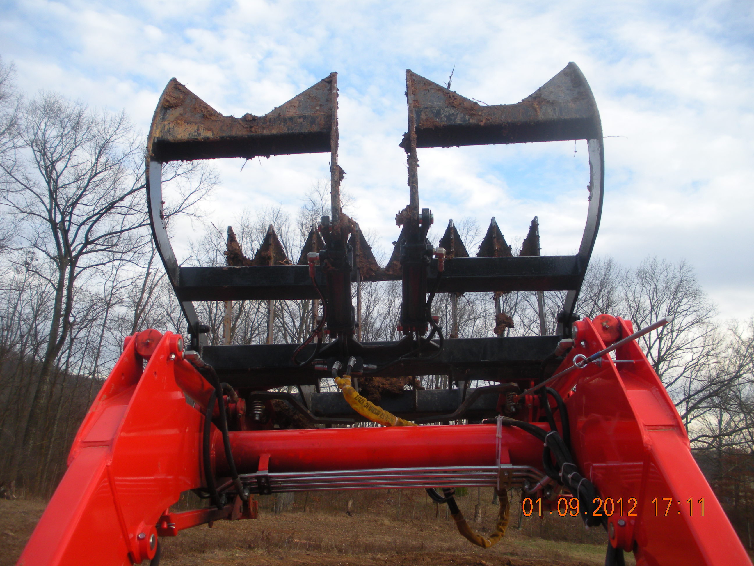

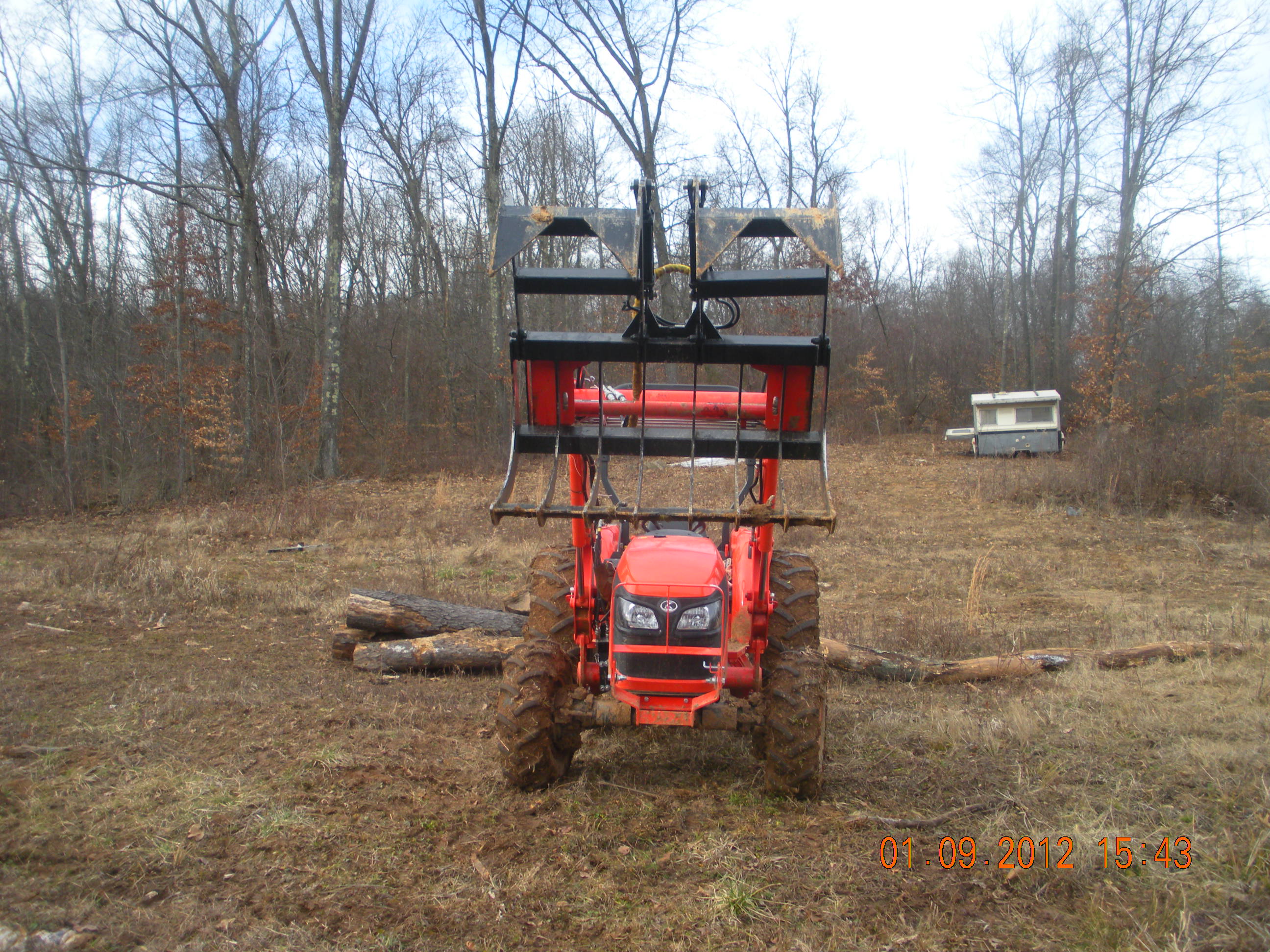

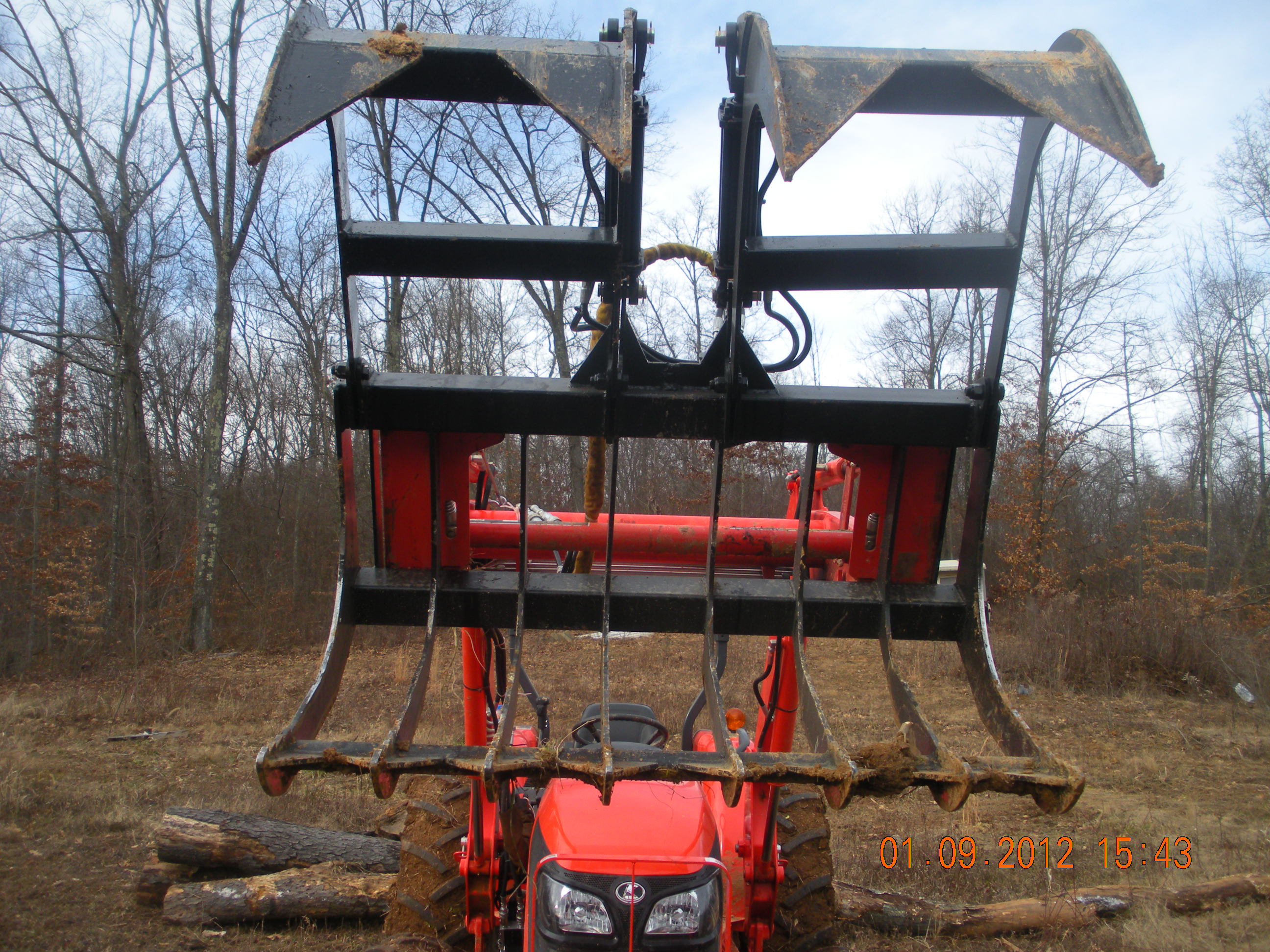

should have taken pix soon as i got it, but i forgot had it about a week when i took these.
this grapple is the berries.

Nice. I'm sure you will get many years of use from it. Looks like you have already been busy.
Unless it is an optical illusion, it looks like you have twisted the left upper arm a bit. No biggie but that is one of the disadvantages of having the dual upper arms with the hydraulic cylinder on one side. If you have an asymmetric object in the grapple and clamp down, if the object is fatter on the outside than inside then the hydraulics might twist the arm. Kinda looks like that has happened. It won't affect function and if it bothers you then heat it and bend it back. That cannot happen as easily with a single arm because the hydaulic pressure is on the middle rather than lopsided.
