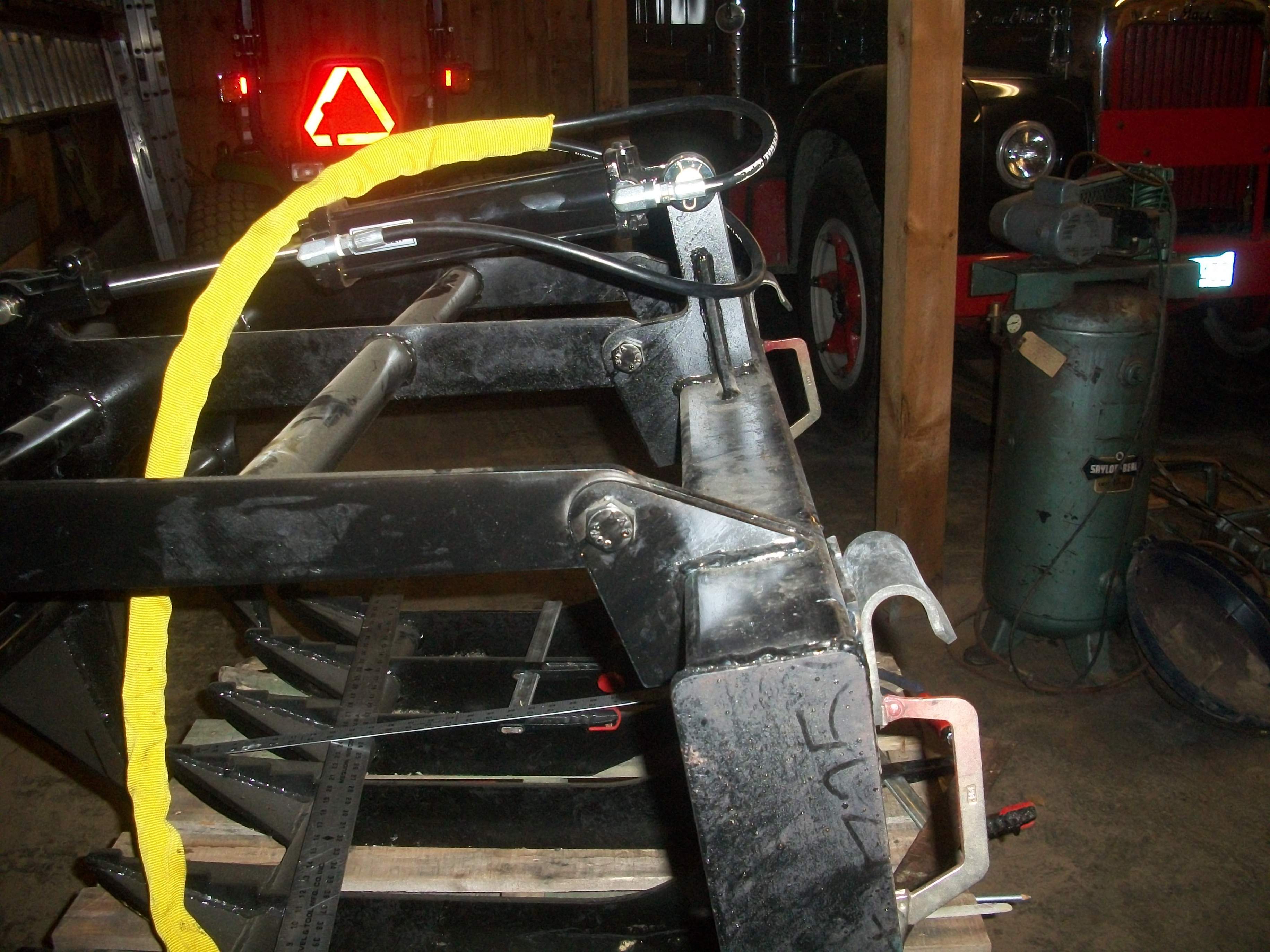

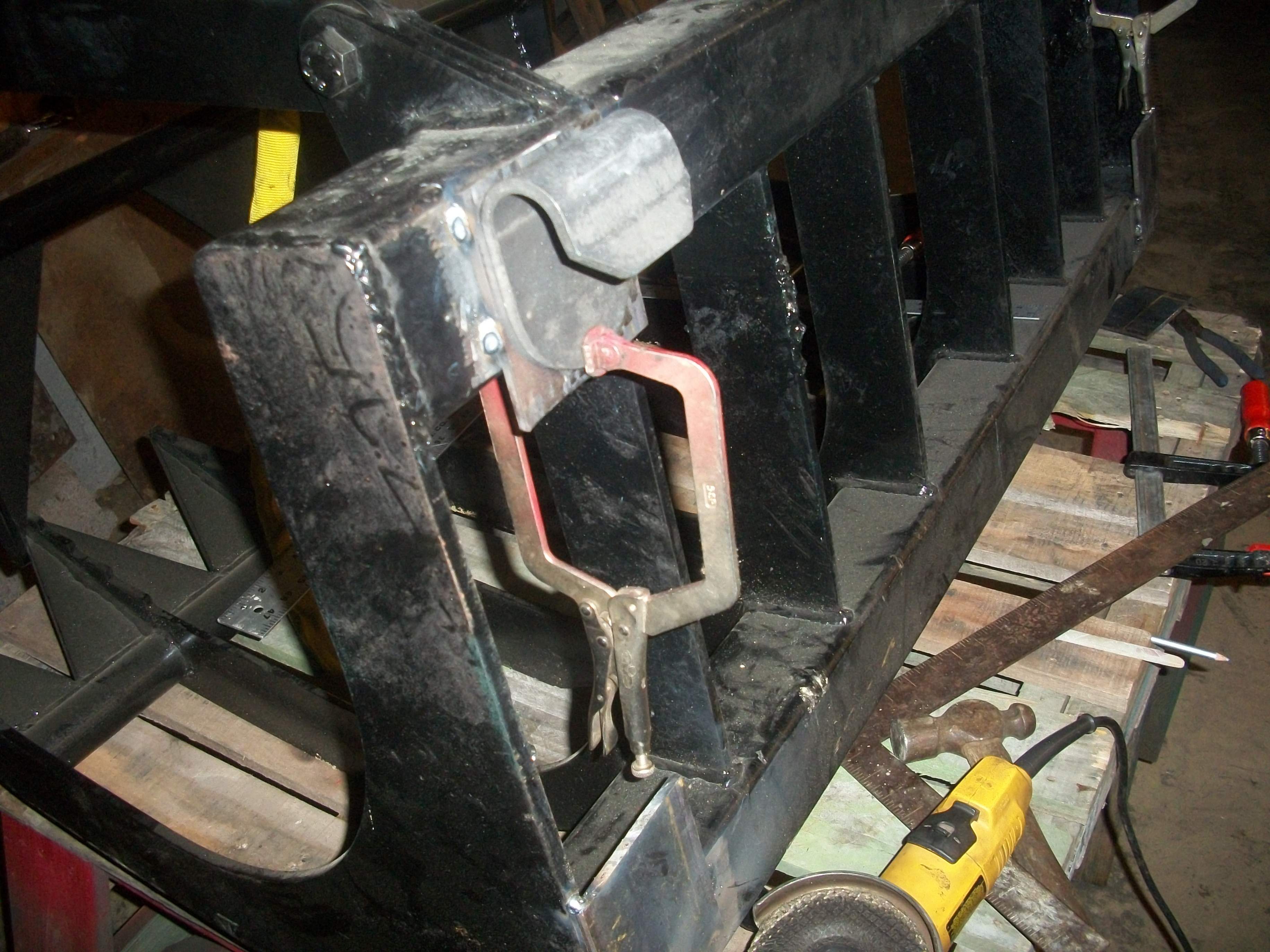

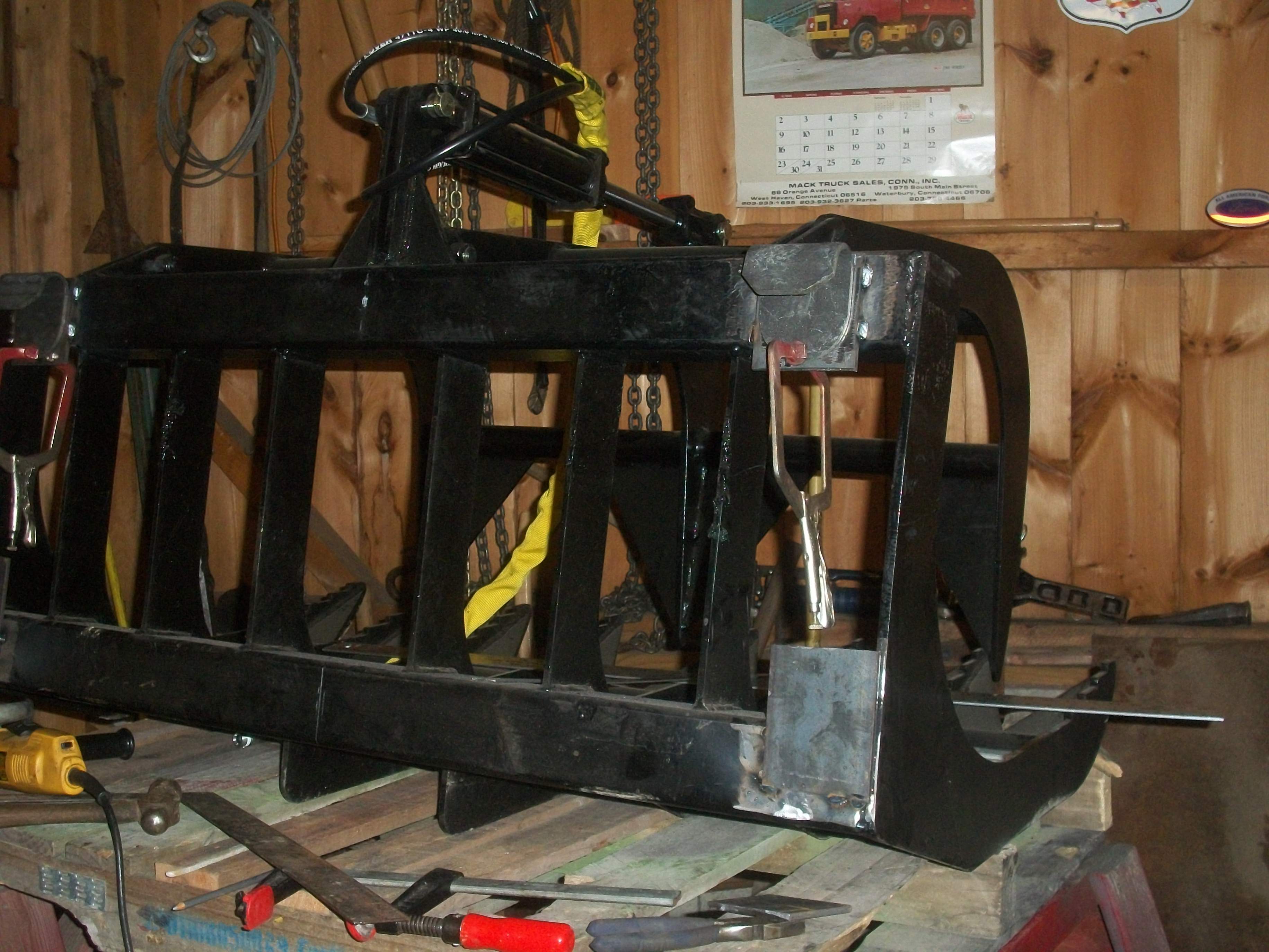

Well guys mine came today. After reading some of your posts about sloppy pins on the Deere set up, I had them delete the hooks/pins. Probably ends up costing me more as anita took 40 bucks off and I was going from memory on the first set of hooks/pins I bought in 2005- surprise almost twice the price! In any case pix of a "work in progress-Had to add some 1/4" plates as the top to bottom dimension on the Deere's is 14-1/2" and the top beam to bottom beam dimension is greater.
In any case a couple of shots of temp tack job. Finish up in AM.
MoPioneer and the rest of you guys-thx for all your recommendations-can't wait to get at the burn pile. THIS is VALUE!
