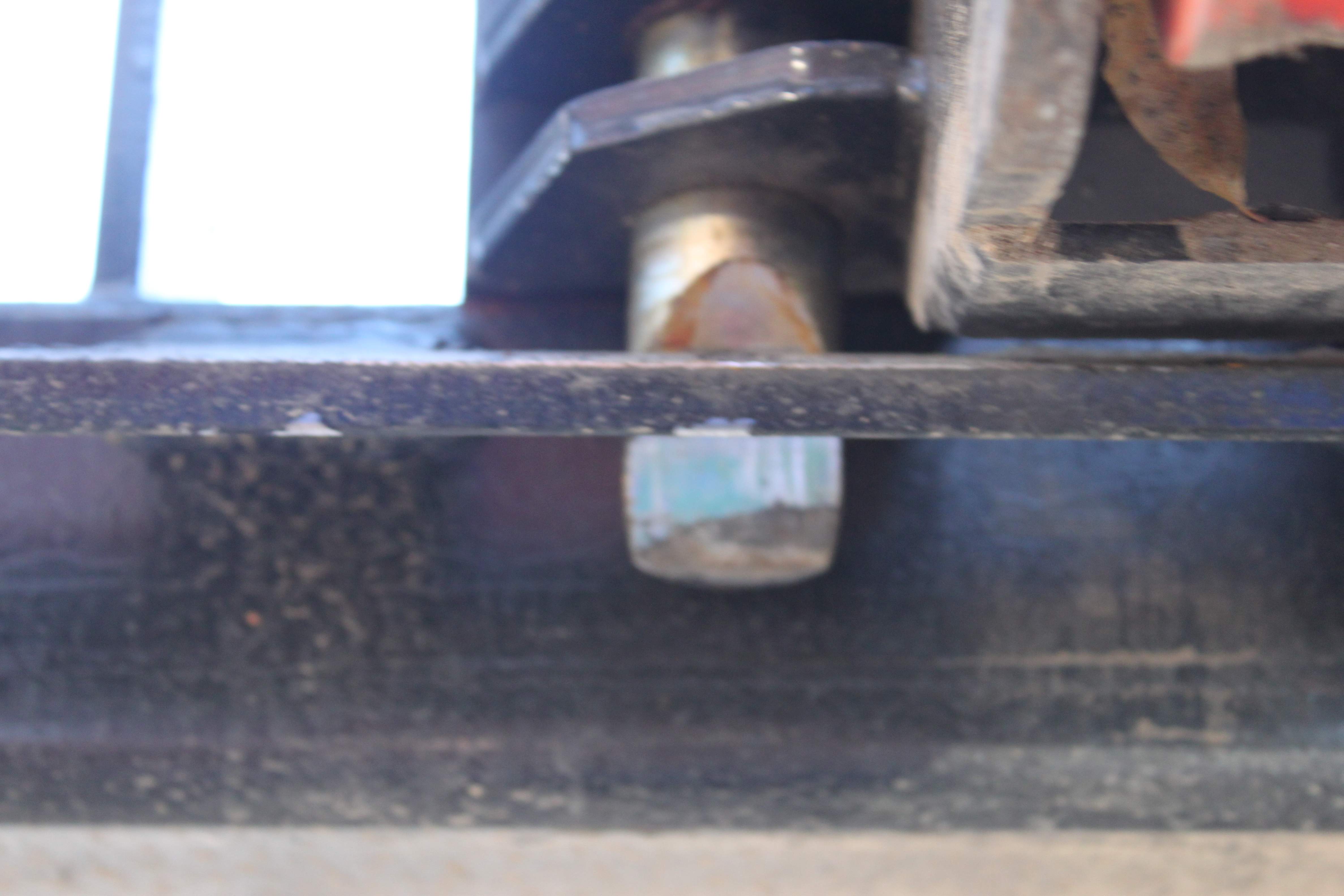

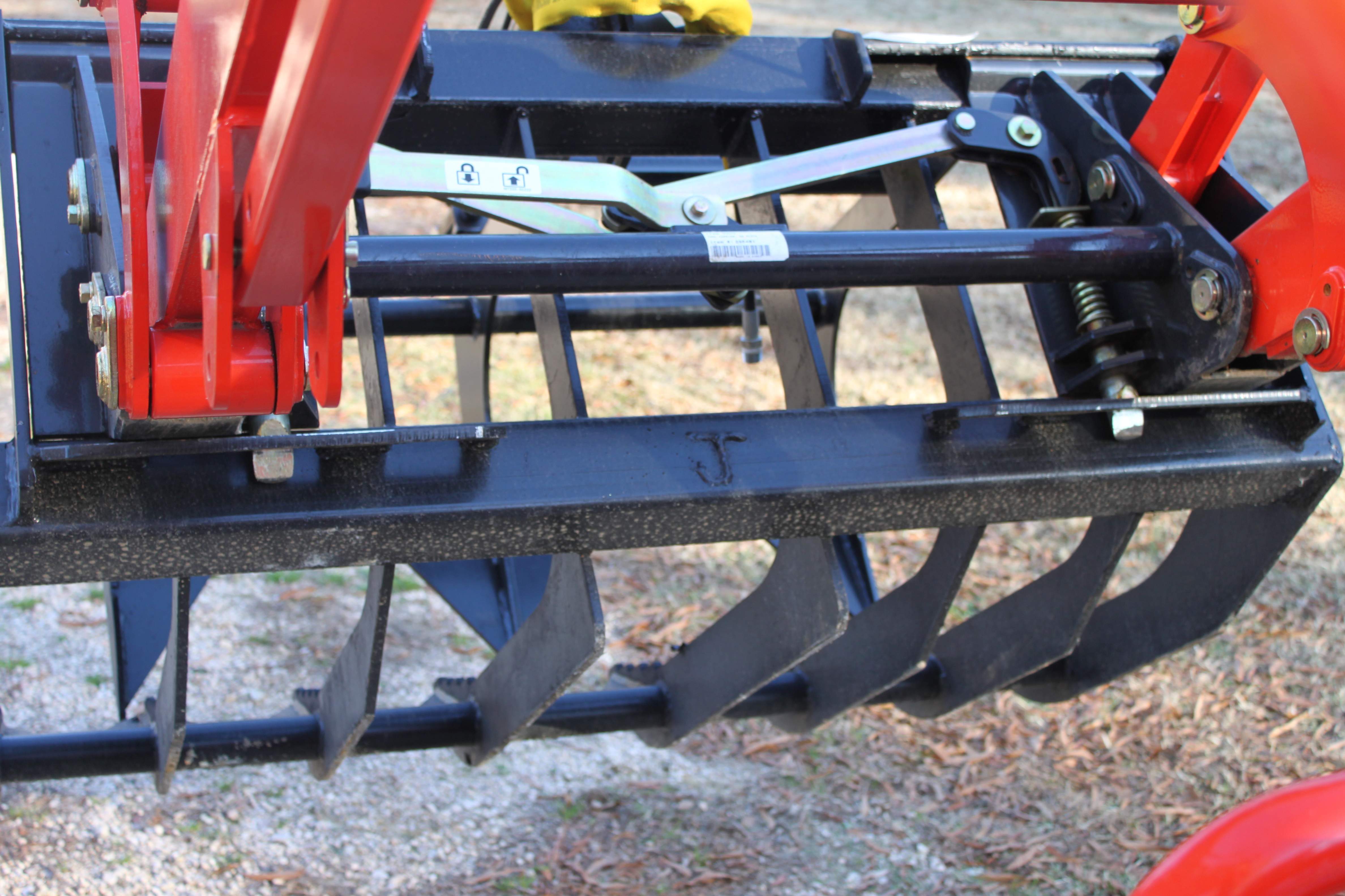

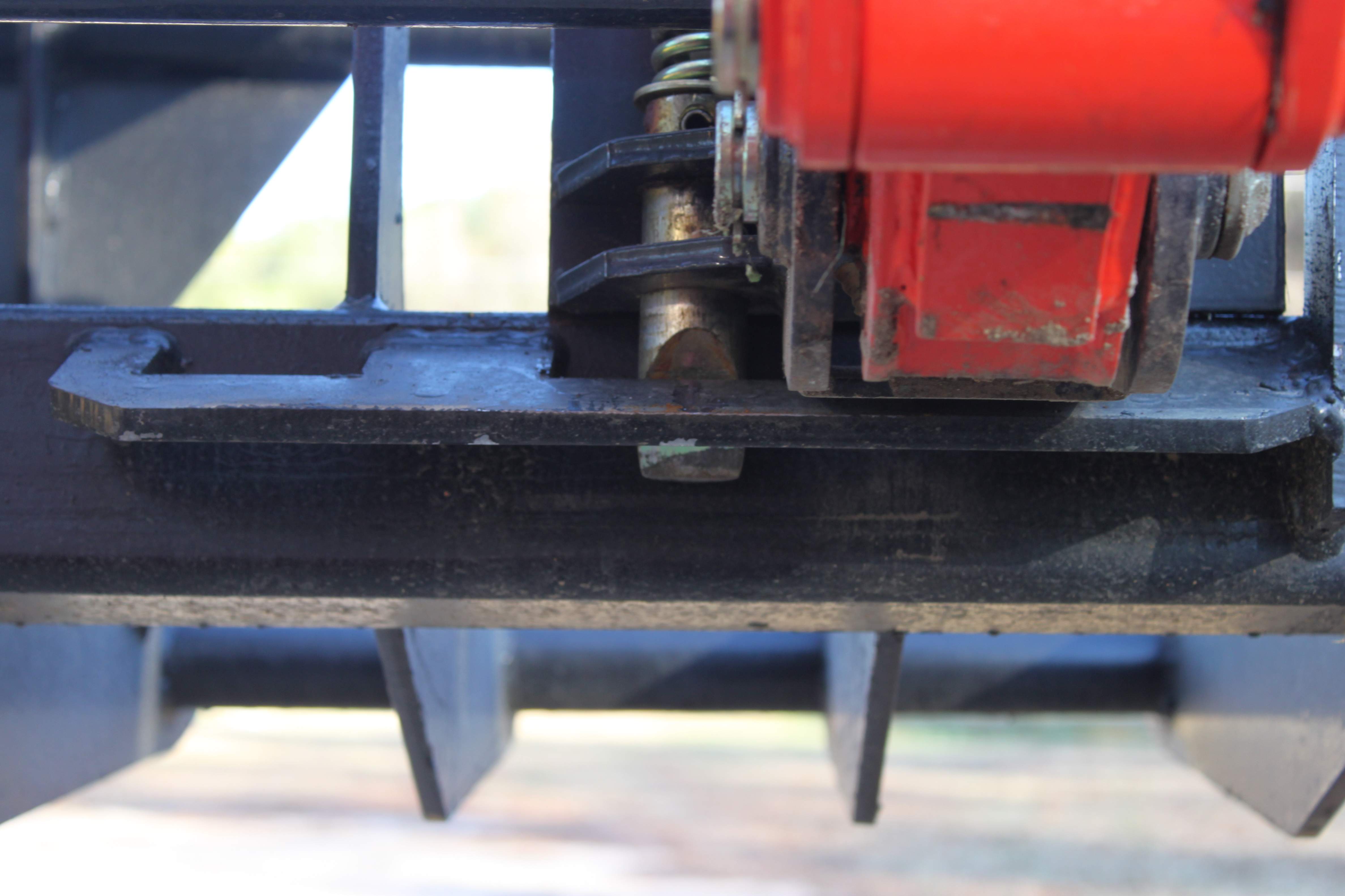

Just received my new Wildkat Grapple. I've got to get some couplings to get it working but its finally here. Please take a look at my pictures an let me know if you think I hve enough pin in to keep from losing the grapple. It looks pretty good leaning forward but has much less when sitting level. Not sure if it needs shimming or not. Thanks for everyone's help in ordering the grapple.

Doesn't look like there is enough wiggle room for that thing to come loose. I dont think you will have anything to worry about.

With your loader off the ground & the grapple bottom sticking straight out, are the sloped surfaces of the pins in contact with the grapple's securing surfaces? If so, I think you're good to go. It looks like the pin thickness at the point of contact (assuming there is contact), is thicker than the steel that makes up your grapple, & probably your loader, too, & I think the pin is hardened, so I don't think it would be the weak spot (ie something else would break first).
I dunno if you read about my mini-saga, but mine had a 3/8" - 7/16" gap :( allowing for a lot of grapple bucket play/ movement.
Here's the gap, along with a sketch of the plate that was welded on to take up the gap:
Here's the actual plate welded on:
The painted final mod:

I did read about your situation which is why I was asking for you guys to put your eyes on this one. My middle picture above is with the grapple sitting horizontal and about three feet off the ground and I have about half the grooved part of the pin sticking through. So I think I have a little more than you but I'd feel better if it stuck all the way through in this position. I'll be careful and watch it when I start using it.

From the pics it looks ok, with the grapple loaded you should be good. What happens when you roll the grapple with the loader control? An slop?

It looks like you have plenty of pin sticking through the bracket to hold it on.

THe fit looks good to me. Since I have been playing around with the rear remotes I am getting more excited as i now have a way to squeeze some stuff.
