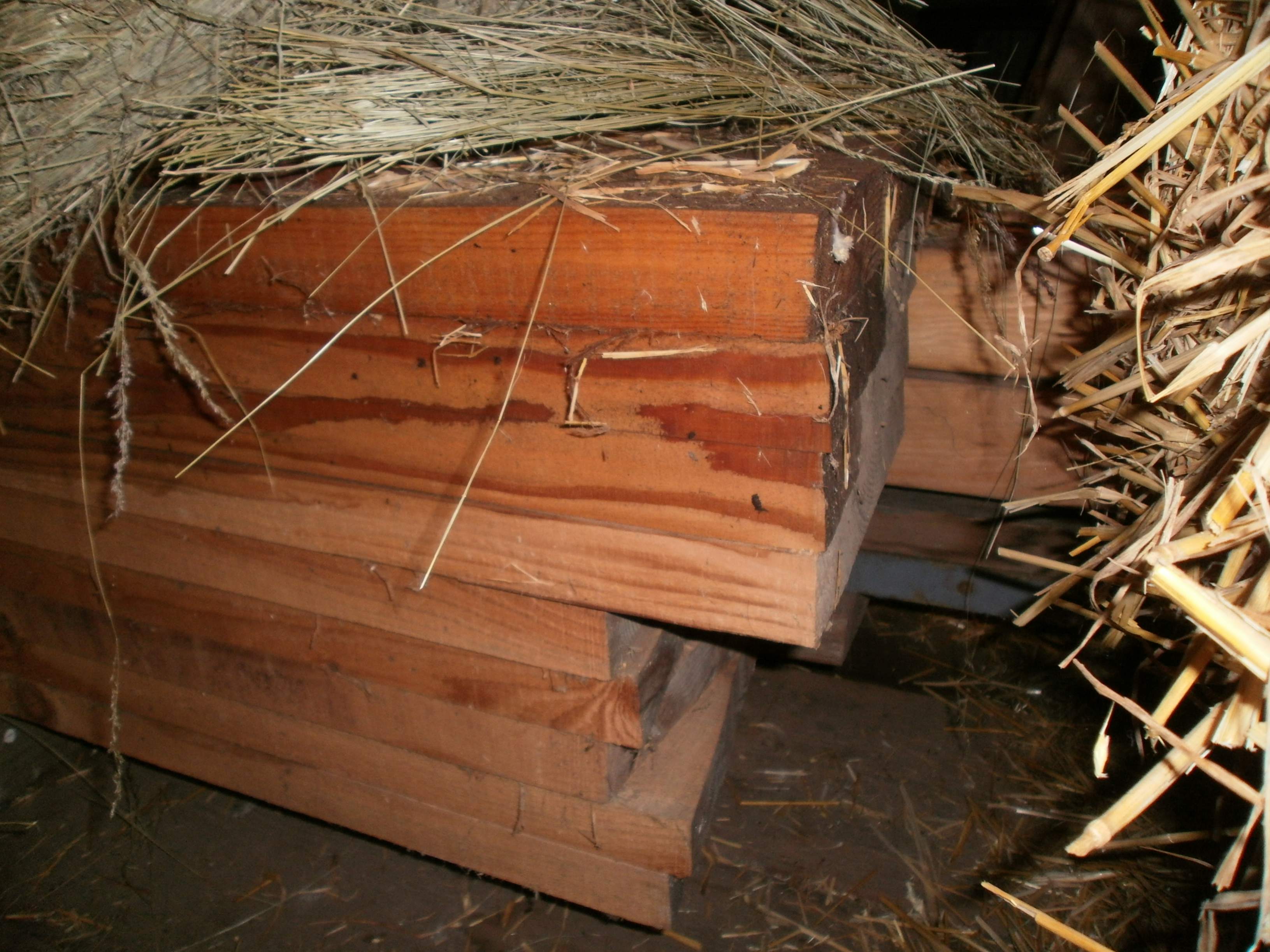

How about using that local lumber and have T & G grooves added? the extra procedure should not be all that costly.
In fact if you had a good solid table saw you could do the T & G yourself.
Once installed you could rent a belt type floor sander for a smother surface if you decided it was needed.

How about using that local lumber and have T & G grooves added? the extra procedure should not be all that costly. In fact if you had a good solid table saw you could do the T & G yourself. Once installed you could rent a belt type floor sander for a smother surface if you decided it was needed.
Good idea.

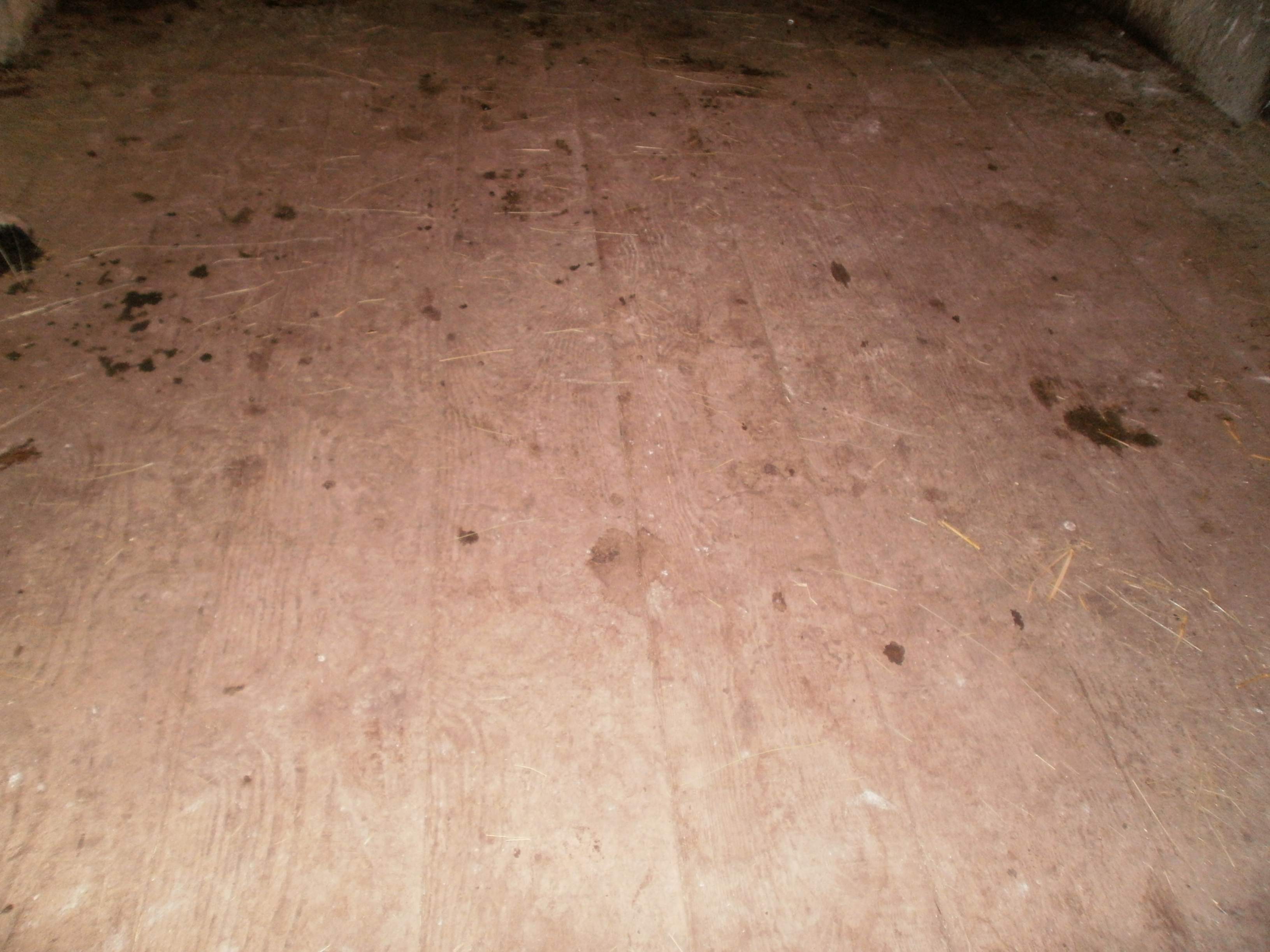

PC140032.jpgPC140031.jpgI haven't seen any tongue and groove barn floors in the pacific northwest. Alleys in OLD dairy and small farm barns were all rough sawn, side by side. If you lay em up and put them in dry, generally they will stay pretty tight. If you put them in green, they will shrink and you will have a gap that wouldn't be acceptable for a shop floor. Barns were made to breathe. Barns with good ground clearance and good roofs last forever. When one of those gets neglected, they begin to fall apart.
Shops were made to be tight.

I do a lot of work on old barns and timber frames. I would also recommend going with either the 2x6 tongue and groove or the rough sawn and adding t&g. This will help stiffen up the floor with larger spans. Either way a 21" span with 2x material is fine. T&G will just add a bit of stiffness. Wouldn't be too hard to add the t&g yourself or have a mill do this and also plane one side or as someone else said, rent a floor sander after it is done and knock it flatter and smoother.
