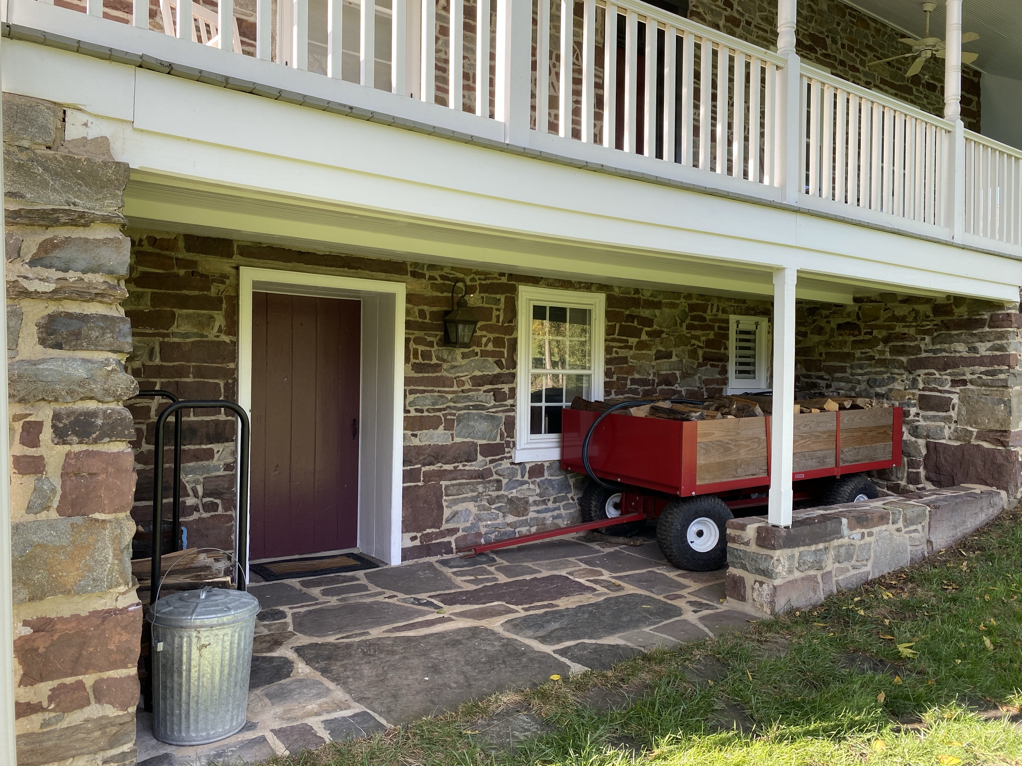

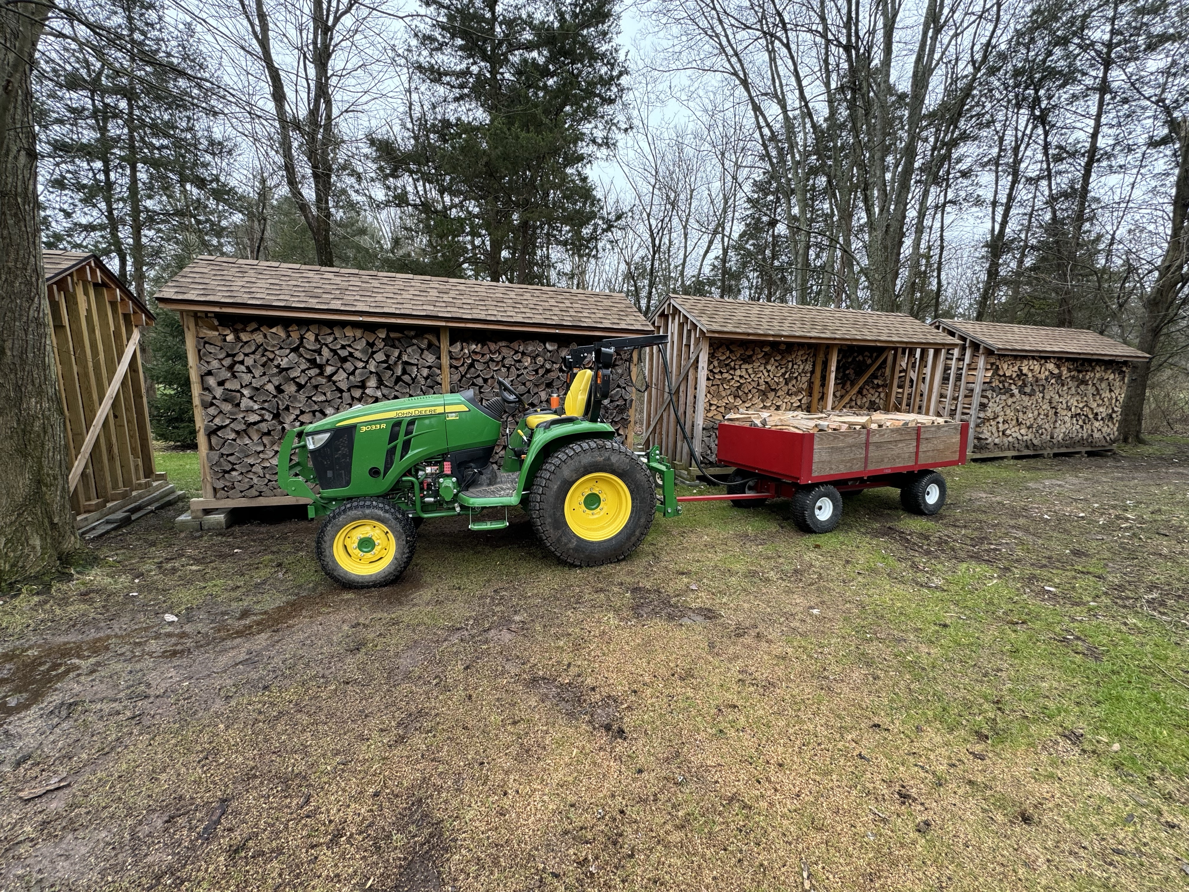

Because the tractor I owned when I started all of this wasn't really great for moving full pallets of wood, I never even considered that option, instead choosing a wagon as my storage at the house. I can fill the wagon, park it at the house, and never have to unload it. I have a place to park it under cover, and it can hold 1/2 cord with ease... up to 1 full cord with some care and extra effort. I use about 1/4 cord per week in average weather, up to 1/2 cord per week in blistering cold weather, so ease of moving wood is key to me.

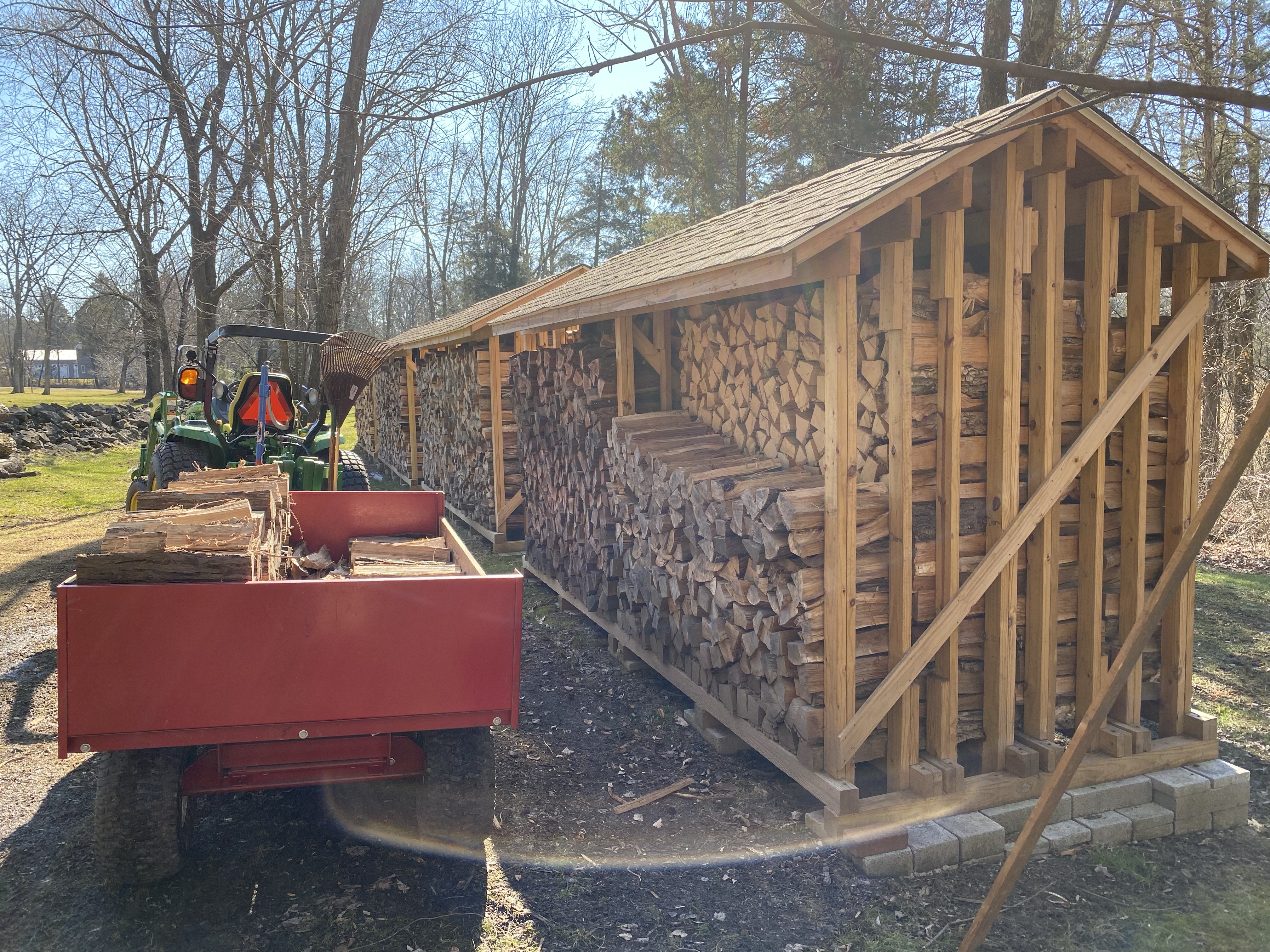

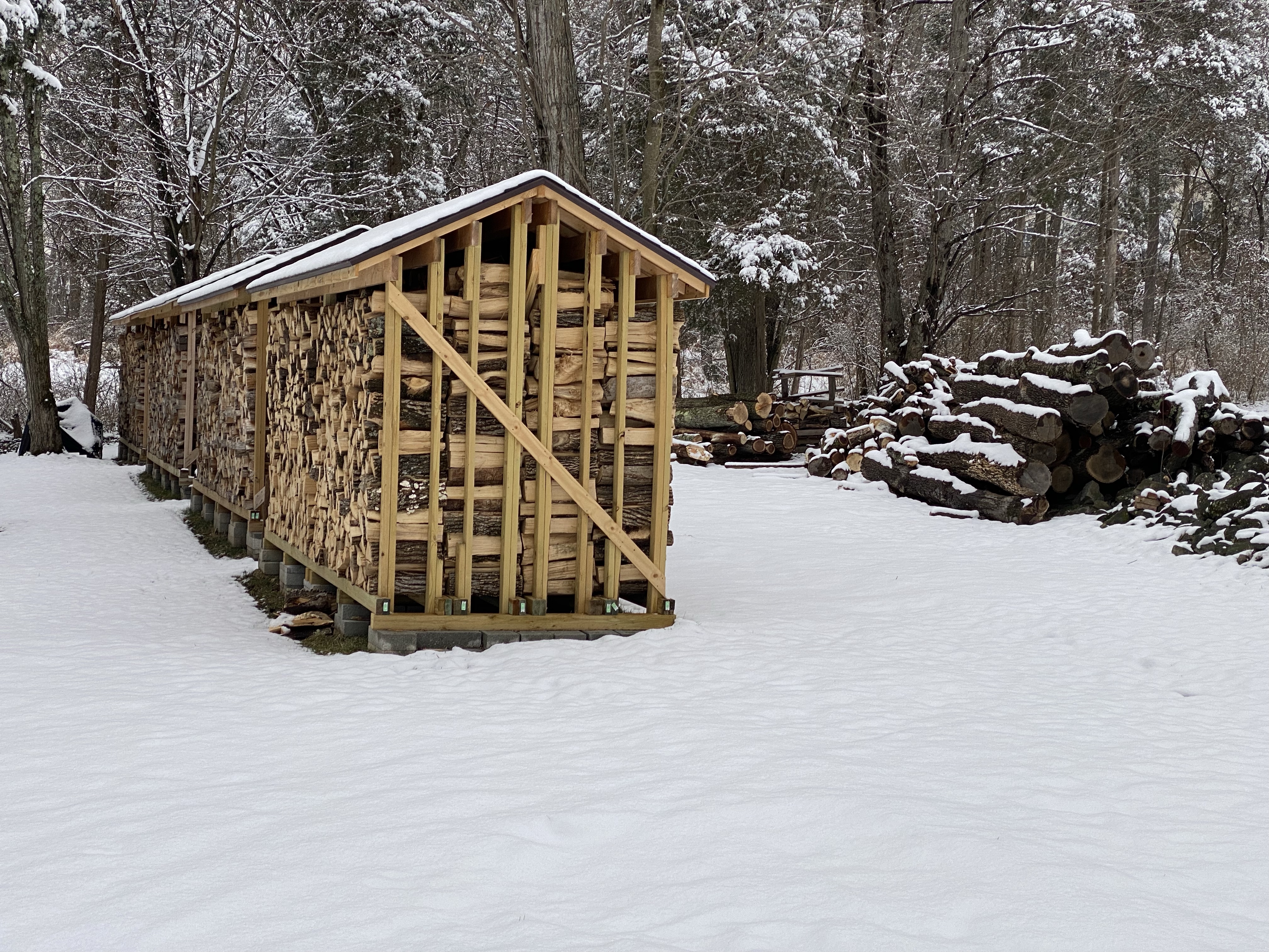

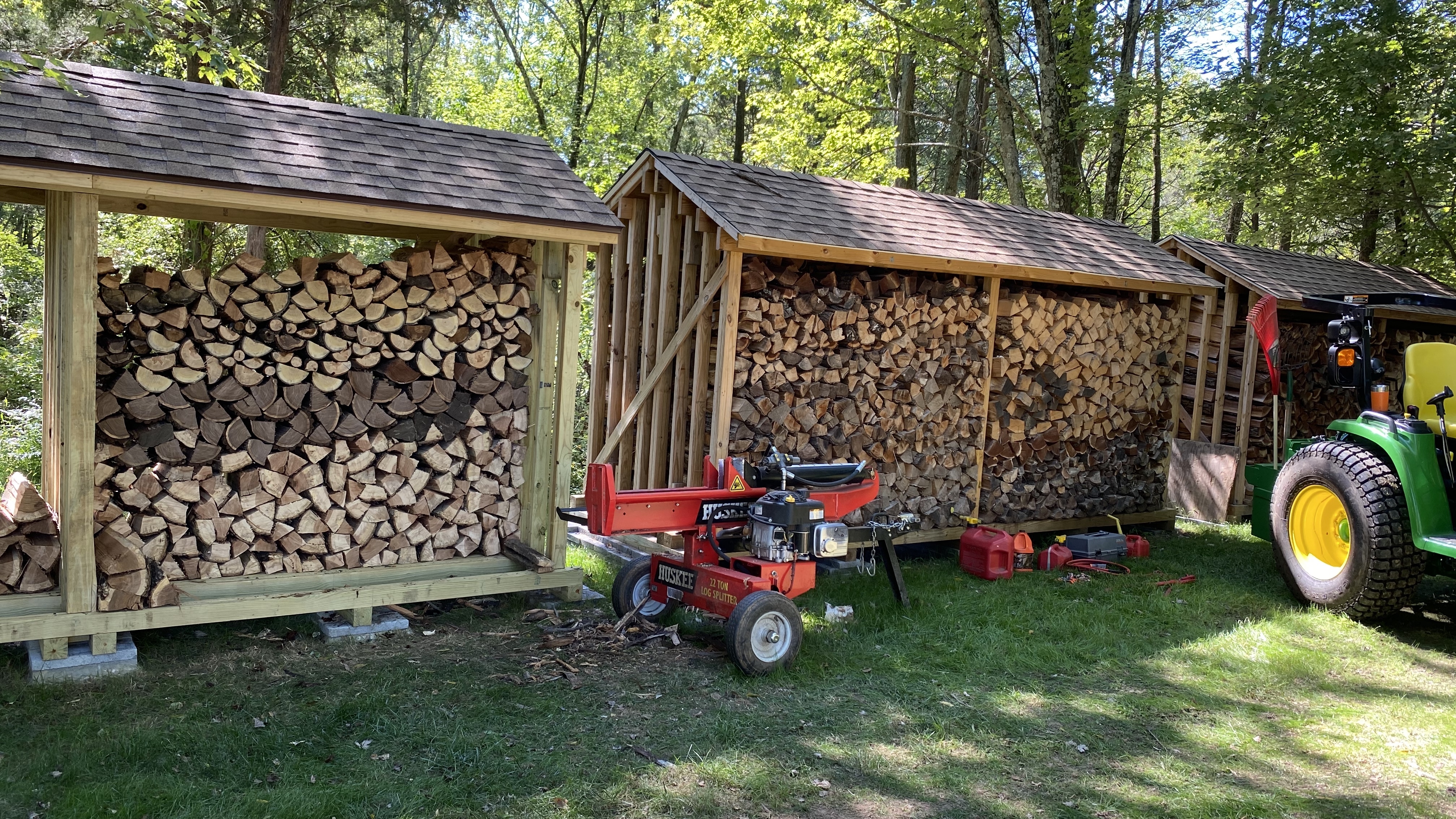

For the shed, you want to avoid anything deeper than an arm's reach, as walking into the shed to retrieve each piece of wood, then walking back out to place it in your loader bucket or wagon, is a monumental waste of time. I built mine to be accessible from both sides, 4 rows deep, so I can retrieve two rows (arm's reach) from each side.

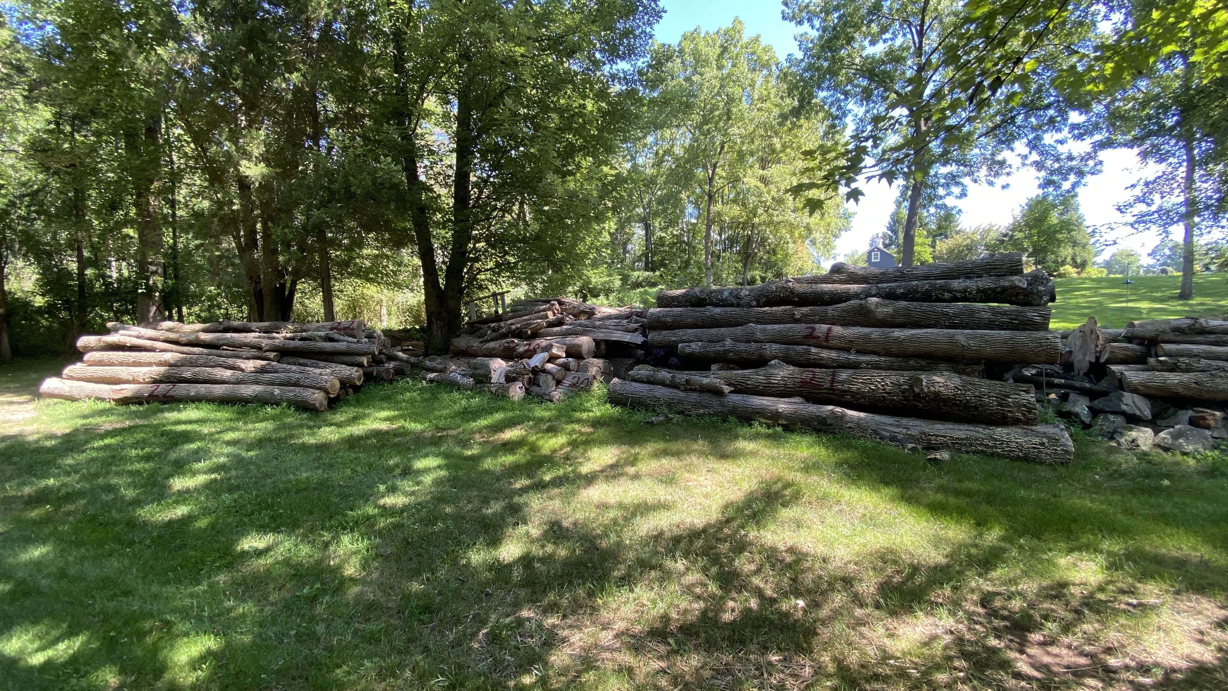

When processing, I just park the splitter directly next to where I'm stacking, which I can do from either side of the shed to minimize reaching deeper than the second row from each side. I essentially grab a log off my pile, lay it next to the splitter, and buck the rounds right there. Then I lift the rounds off the splitter if they're light, or use the loader bucket as my log lift if the rounds are heavy, and onto the splitter. Off the splitter, straight into the stacks.

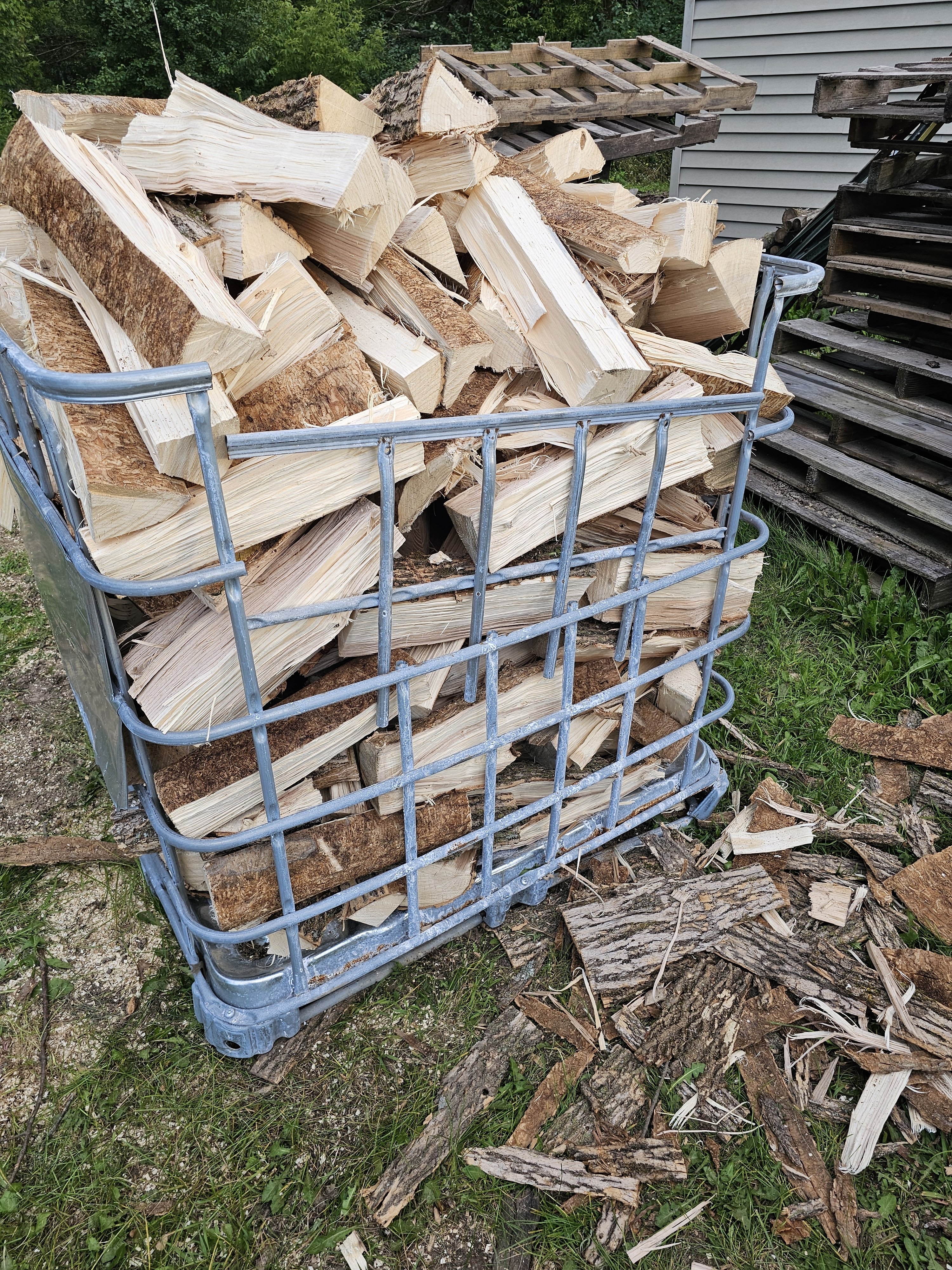

I would coveView attachment 2736904r them. Would you cut the front side to make getting bottom wood easier to get to?
I saw one picture the guy used part of the plastic as a cover.
Cut the other side. This is how I fill the totes and use the cut out to hold them in. My wife has slight ocd and stacks it all perfectly. She does most of the splitting. I just take care of the big pieces usually. so I'm pretty lucky with that

Question - Do you cover them?
I do not. I've never covered my stacks before, and everything has always been fine. I don't care about the rain hitting it because I stay 3+ years ahead now. The only benefit of a cover on the totes to me would be keeping some of the leaves and dust from landing in them.
