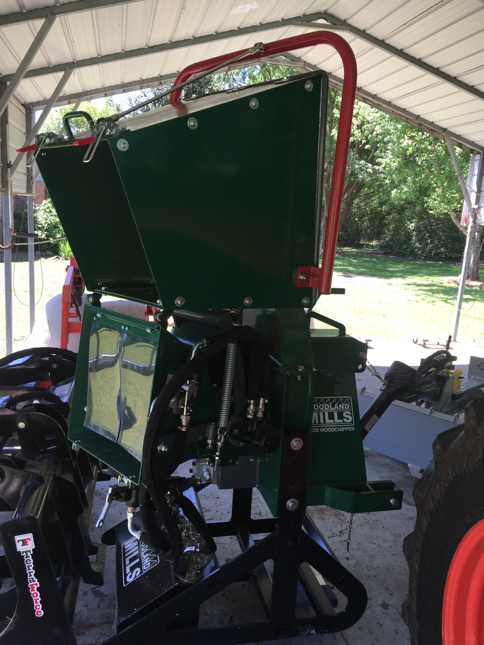

Old thread but just sharing my experience with the Woodland Mills WC88 I just got. It is an awesome piece of machinery for the price. I looked at the WM and this one and very glad I choose the Woodland Mills. I was skeptical and while I hoped I made a good decision, I have been very pleased with every aspect of the purchase. The delivery to South MS took only 7 days after ordering. The unit came well packed on a steel pallet frame. Instructions and assembly was easy. The unit is robustly constructed and excellent engineering in the design. I have it attached to my M7060 and run it in the e-pto setting and run the chipper at 540 (not sure why anyone running them lower than design?) The unit devours everything I put in it. If you watch the great video WM has on the units design and workings I think it is easy to see it is a better unit than the WM. Look at all the 5 star reviews on their website too. I am more than happy with this chipper.

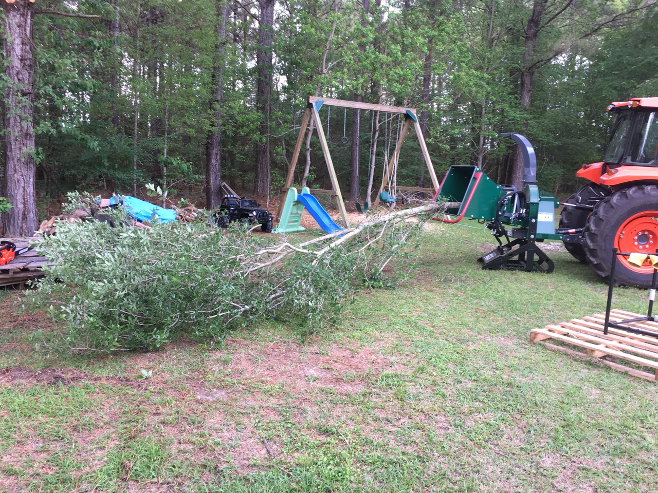

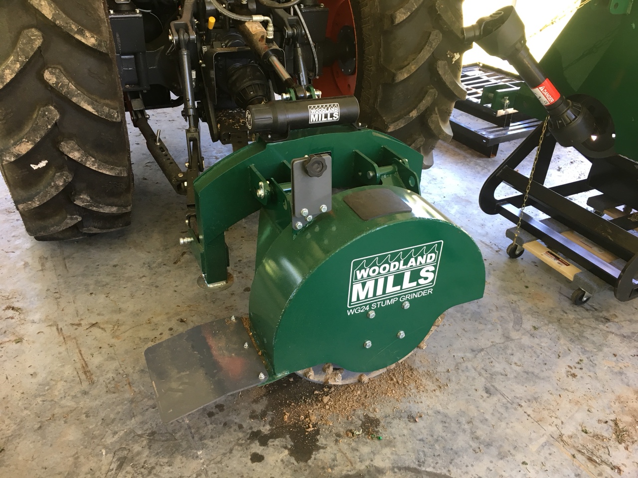

I have the WM88 on my JD955. The horsepower and 3pt lifting capacity were borderline but I really wanted the larger opening. I had a Jimma and that was a job to use. We burn everything over a couple inches, so this is for branches and brush. Well built, hydraulic variable feed is excellent. With the 33 hp Deere, and brush this size you can barely feed it fast enough. The quality and the price made it a good deal, and from what I have saw about used chipper resale values, I can't go wrong. For the homeowner who has a lot of trees, and likes the freedom to do things on his own schedule, this is an excellent choice. I also have the WG24 stump grinder. It's just as satisfactory as the chipper.
