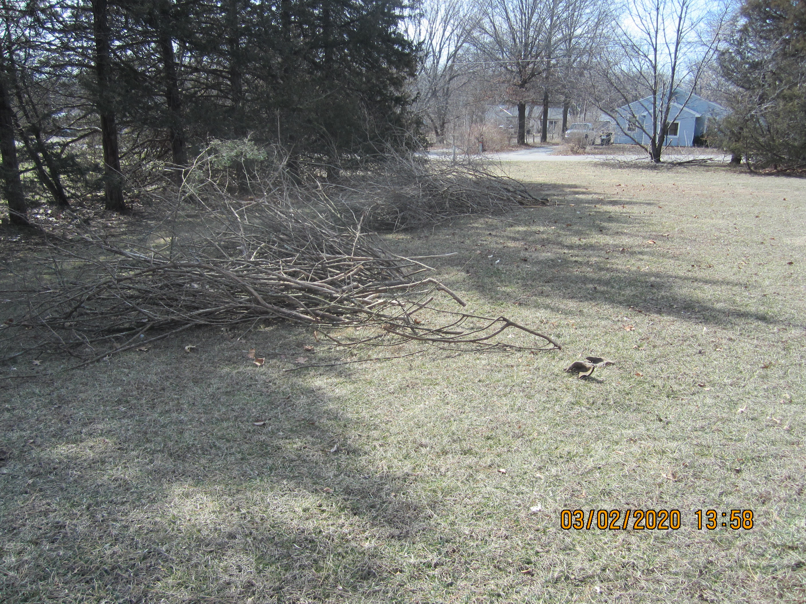

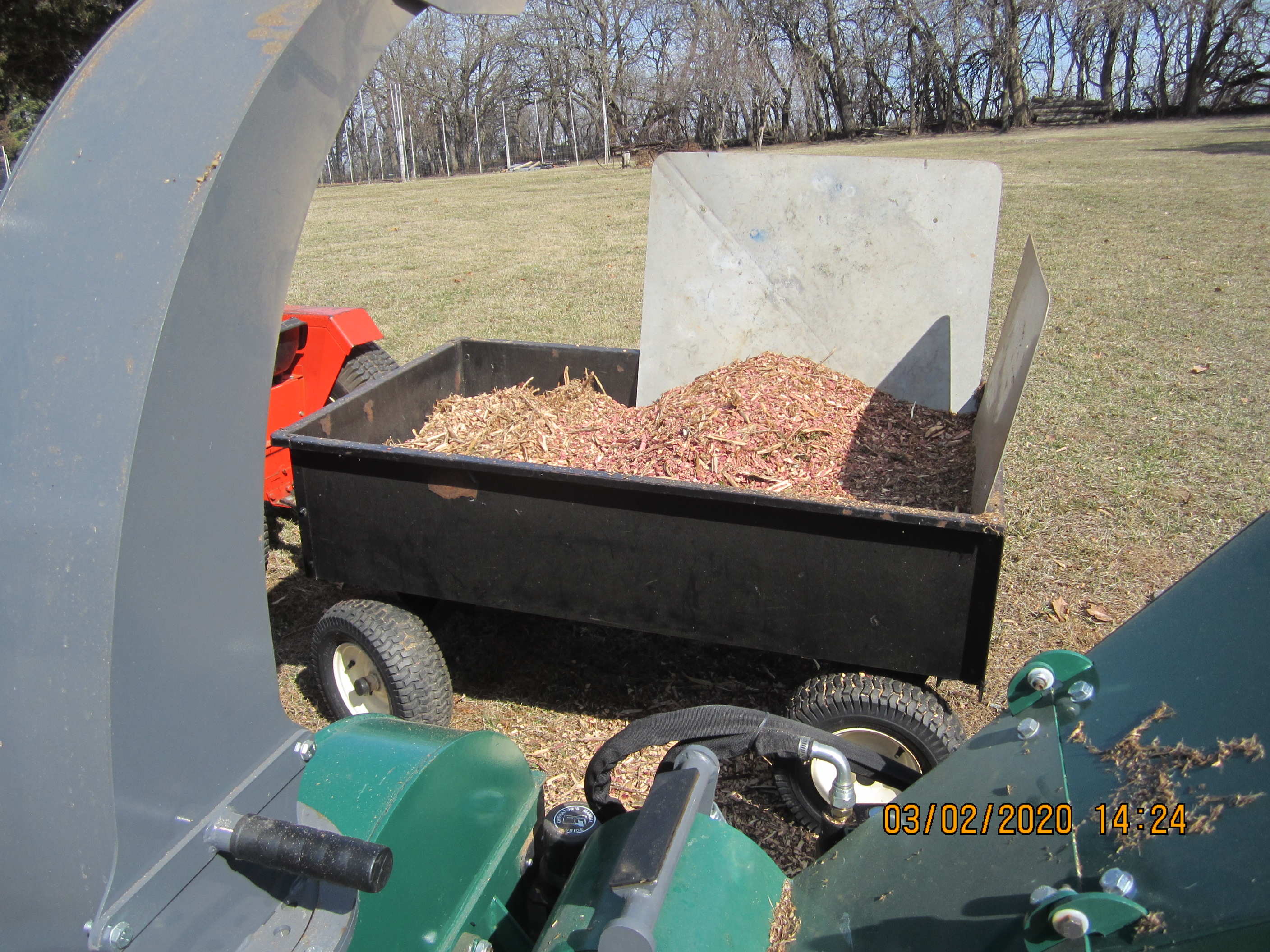

I have about four hours experience with my new WC68 and I am excited for spring to come so the cleanup can really begin. I have piles of brush everywhere and most were cut and piled before I had any thought of buying a chipper.
I have had to reverse the hydraulic infeed a half dozen times as I learn how twisted a branch can be. I am sure that going forward while I am cutting, I'll get a better sense of which (Y shaped) branches may need a secord zip with the saw to make them 6" compatible.
As for small stuff, I have already learned to feed it in along side a longer branch - that works well. I did try to chip a totally rotten branch - it turned out to be sawdust held together by bark. It did not work out so well and clogged the chipper and chute. I'll leave these sorts on the ground to finish rotting.

   / New Woodland Mills WC68 Chipper on the way #30
Yep, dragging limbs out is how I hurt my knee real bad. It is an old knee anyway, but a few days ago it gave out and I'm out of commission now. Maybe by the time this rainy weather is over I can get back at it.........but ....I don't know. 002.JPG003.JPG
