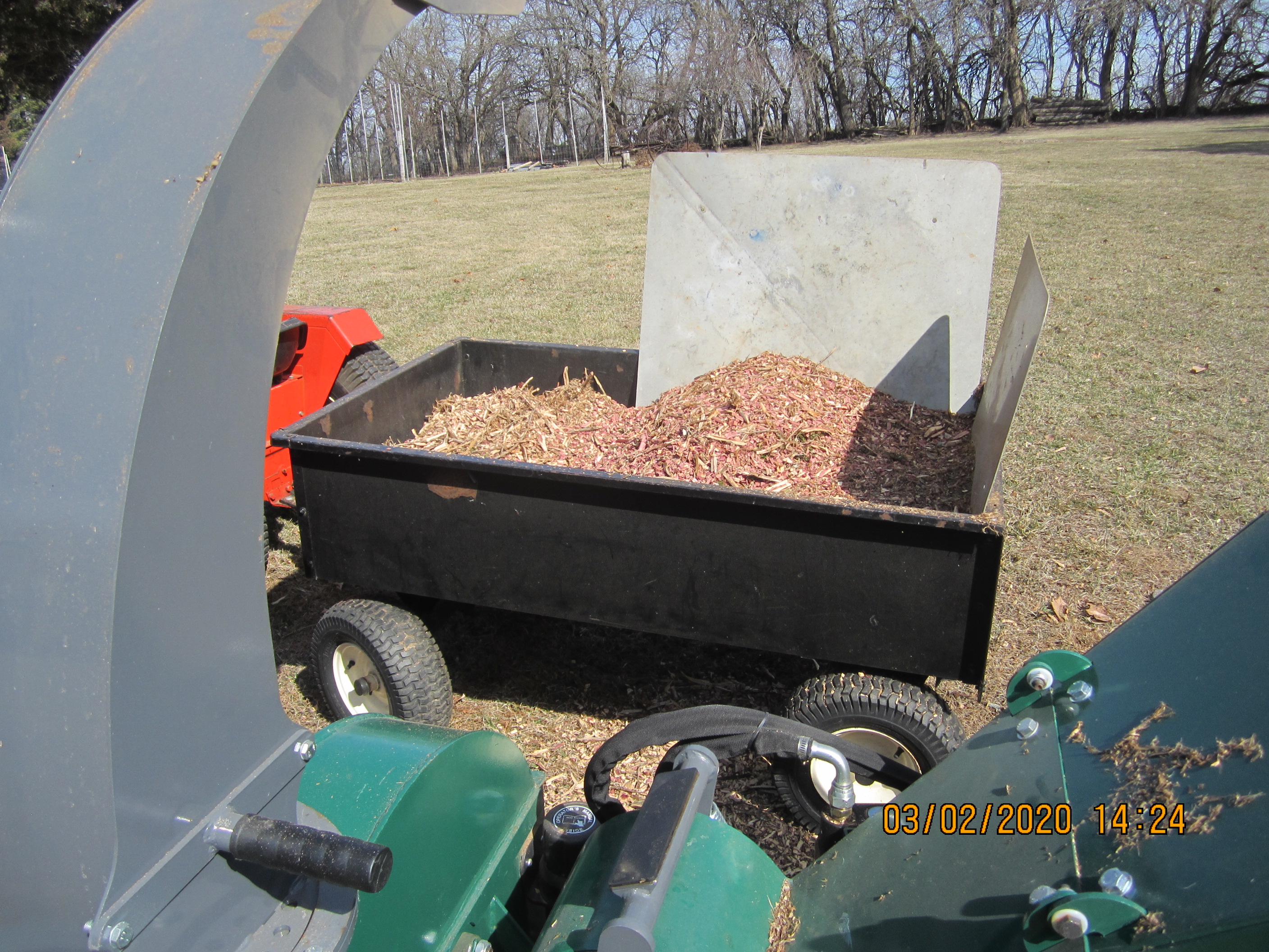

New WC68's come with feed pressure set about half full pressure. It sounds like yours may have come with a bit too soft of pressure.
Your Owner's Manual describes how to adjust the feed pressure. Pressure can be adjusted with the large spring on the right side. After the chipper break-in the pressure is a bit softer than brand new. On the plus side, the softer pressure makes starting large pieces easier to get pulled in. You can tight up the spring pressure but be aware, starting large pieces can sometimes be contrary. If you encounter that, the easy work-around is to shove in a smaller piece to raise the roller a little, then immediately follow it with your large piece.
Other 'fixes' are to make your larger tree cuts at an angle, giving the roller something to get a bite on. I usually forget to do that, so I just routinely use the smaller piece first system.
If adjusting the pressure spring doesn't solve your problem, there is of course, a hydraulic pressure control next to the spring pressure control. You may have to bump up the hydraulic pressure. The BX probably has to run a full PTO rpm to get the needed fluid pressure. haven't needed to do that though on my L3400.
Hope the above solves your problem. If not, Woodland has an excellent Tech Service Department that will gladly walk you through whatever it takes to resolve the problem.
I have adjusted it up. talked to tech department several times. I installed a gauge. When it jams there is 2500 lbs pressure in the system. Even with a small branch. They sent me a new pump. Did the same. Their last recommendation was to loosen the springs. Have found that evergreen tends to plug the chute. Usually after things warm up. Guess the sap is not helping. Have used slip plate in the shut which helps
I am happy with the unit has a hold. It is much better then the Chinese model I had before it. Was just checking to see if others had my problems. I do run it a little faster than 540 RPM
   / New Woodland Mills WC68 Chipper on the way
#32
Has anyone had trouble with the W68 hydr. feed stopping and you have to reverse it. Even with small pieces.
Also with the discharge chute plugging up
I've not used my new chipper much, really just a trial, but it seems to work just fine. The only feed problem I encountered was my own fault, I saw that it was unlikely that a fork was going to feed properly and put it in anyway. It twisted and wouldn't go in or out, so I had to shut down the chipper and reach in with the tip of my saw. Lesson learned. But the hydraulic feed has worked just fine with no stalling. I DID get one discharge chute plug (pluggage?) but it cleared easily.
