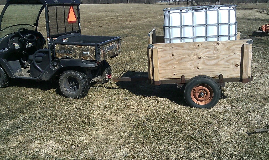

And next week turned into a couple of weeks... Got rust converter (3M Rust Reformer) on the rusty spots (mostly surface rust, plus a little on the welds from condensation). Next to put on Kubota Orange (tomorrow?) and then some undercoating where the deck will sit on the frame.
Pictures:
From the side with the splitter hooked up:
The view from the splitter's perspective:
Rust Reformer drying (sorry about the fuzzyness on the right side, the back slipped partway off my phone):
From the front:

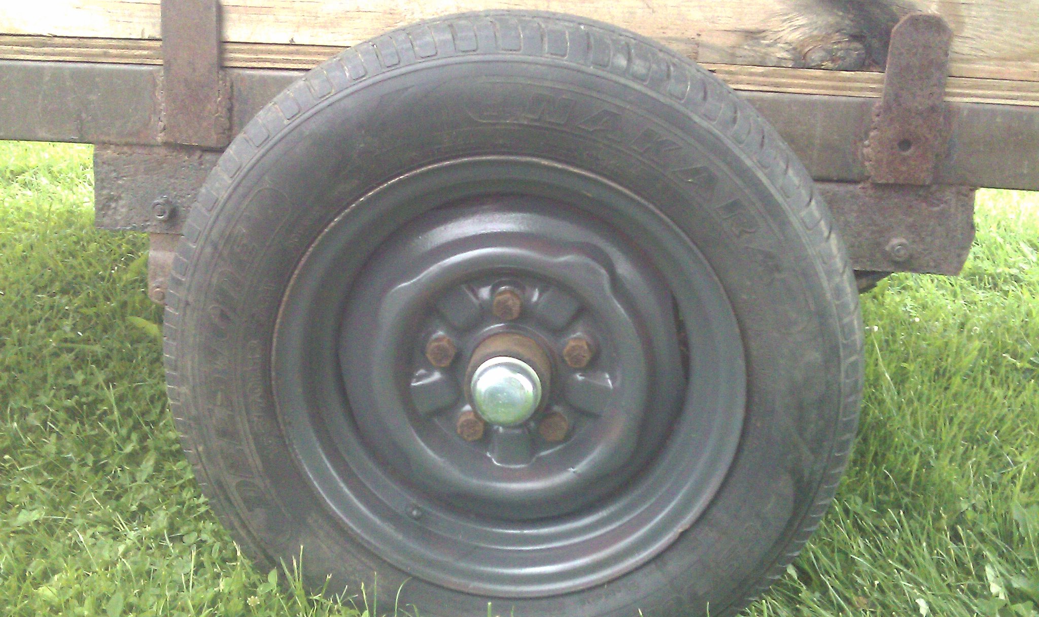

Tires: The current tires are old and leak down. If I get bored, I plan to pull them, perhaps try electrolysis to clean them off, repaint them and put on a couple of the mostly dead 13" snowtires that are currently taking up space in the shop. They are ~3/4" smaller in diameter and are ~1.5" wider, so they should level the trailer and "float" better in soft ground.

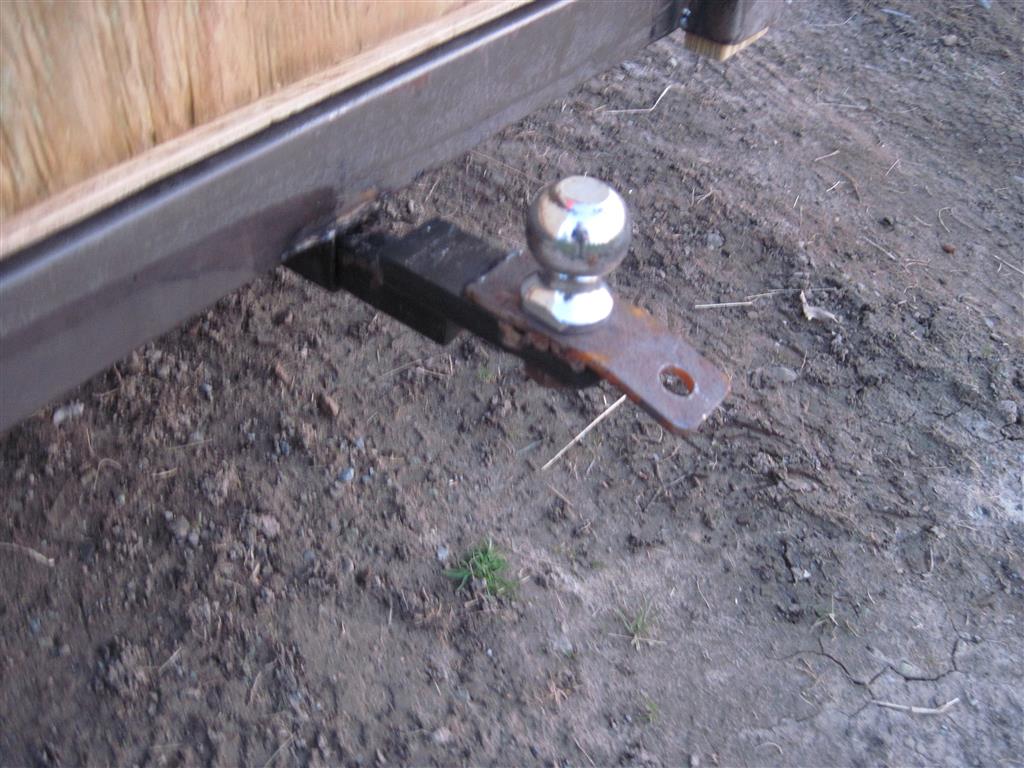

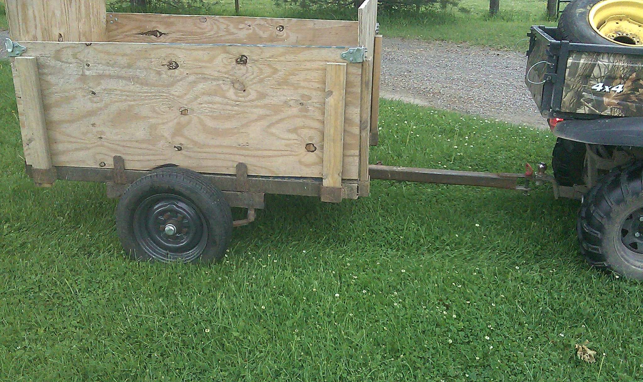

Hitch: The receiver hitch on the back is just a piece of 2"x2" 1/4" angle with a piece of smaller (1.75"x1.75"?) angle welded inside it to make a box. I couldn't see paying $30 for a 8" piece of hitch tube at Tractor Supply. I used a removable hitch for 2 reasons:
1. This way, I can turn the ball mount around and nothing sticks out of the back of the trailer
2. I had a ball mount sitting around from my previous car
Aaron Z

Looking good :thumbsup:
I like the hitch :)

Thanks. Couldn't see spending $30 on a piece of tube when I had all of the parts to make it and I would have needed a piece of angle to tie back to the 2nd crossmember anyway.

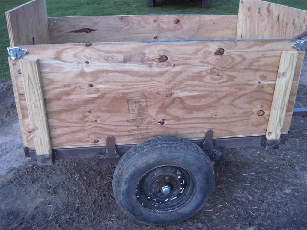

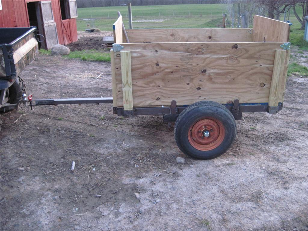

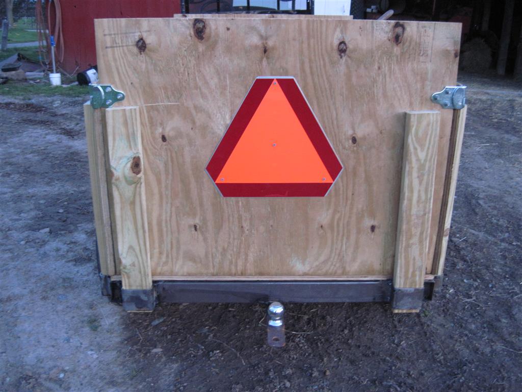

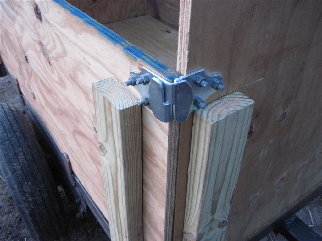

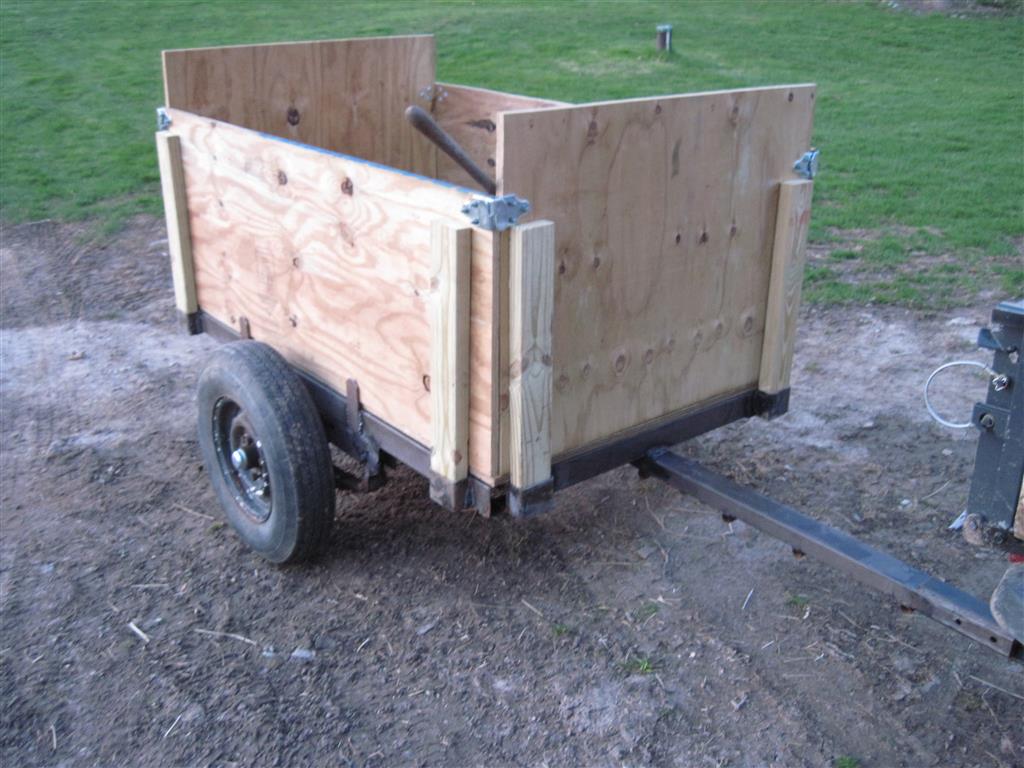

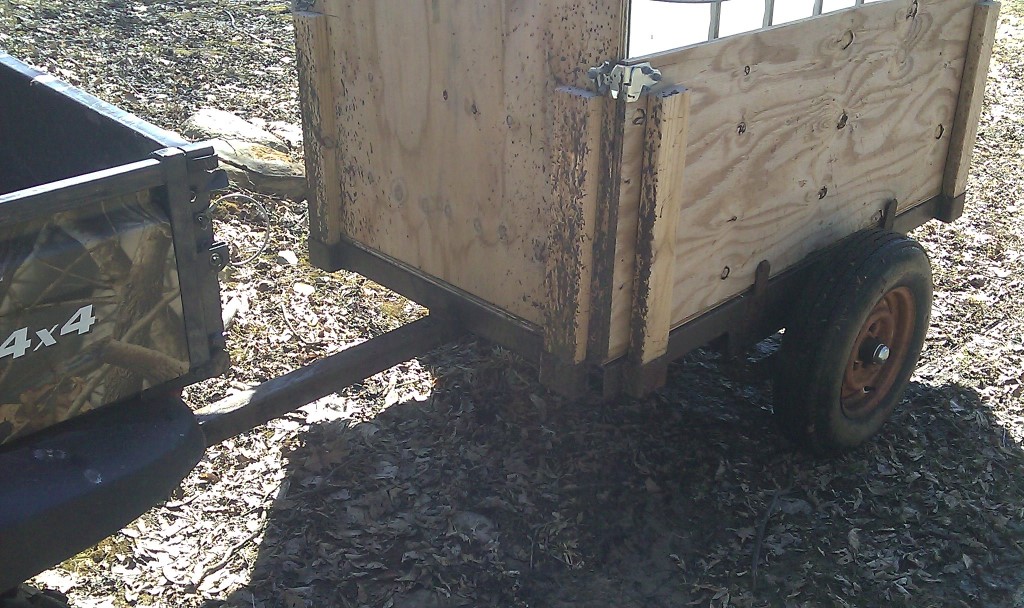

Everything is ready for paint now. Had a weld on one of the stake pockets for the back that didnt hold, and once I got the sides on, I realized that I needed something to keeping them from bowing out, so I added 2 tabs on each side. Here are some pictures:
Walkaround:
IMG_2352 (Custom).JPG IMG_2353 (Custom).JPG IMG_2355 (Custom).JPG IMG_2357 (Custom).JPG IMG_2358 (Custom).JPG
Looking into the box from the front:

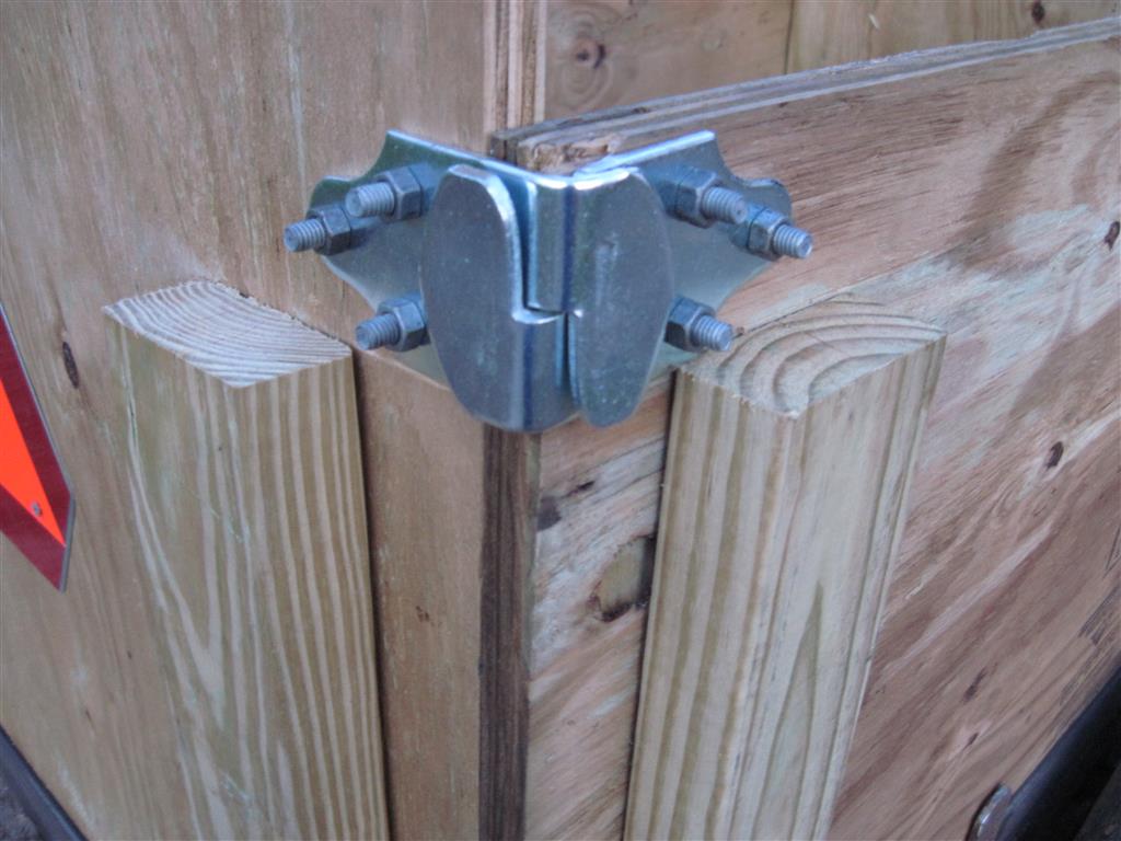

RR and RF corners showing brackets there to lock sides together at the top. Will eventually cut the bolts off flush, or add acorn nuts:
Hitch closeup:
Hitch stowed:
Hitch out:
Still need to paint it, but cold weather shouldn't be a problem going forward.

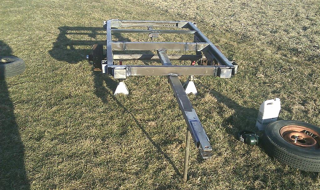

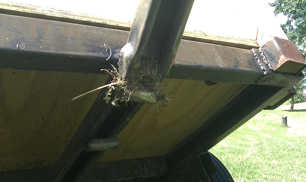

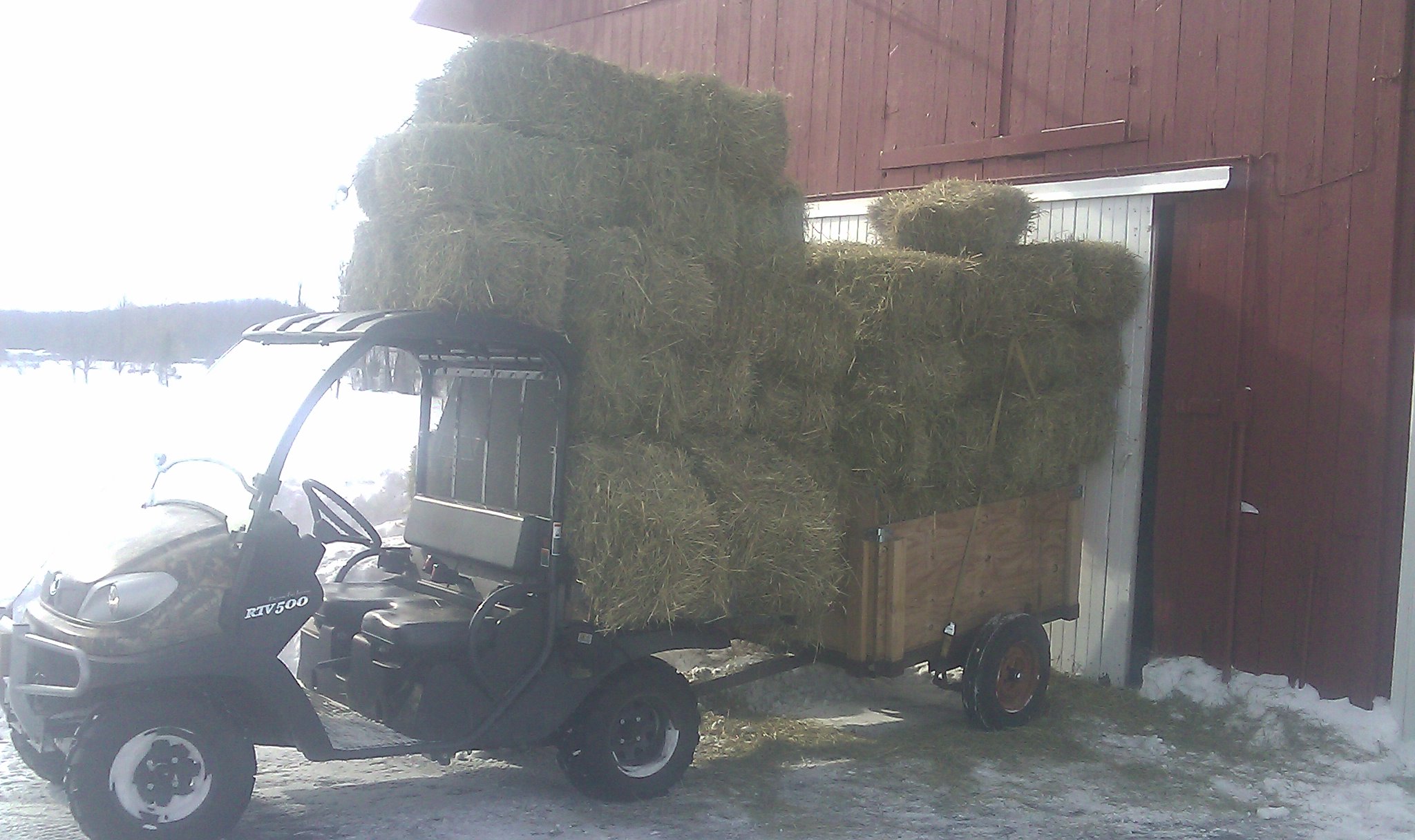

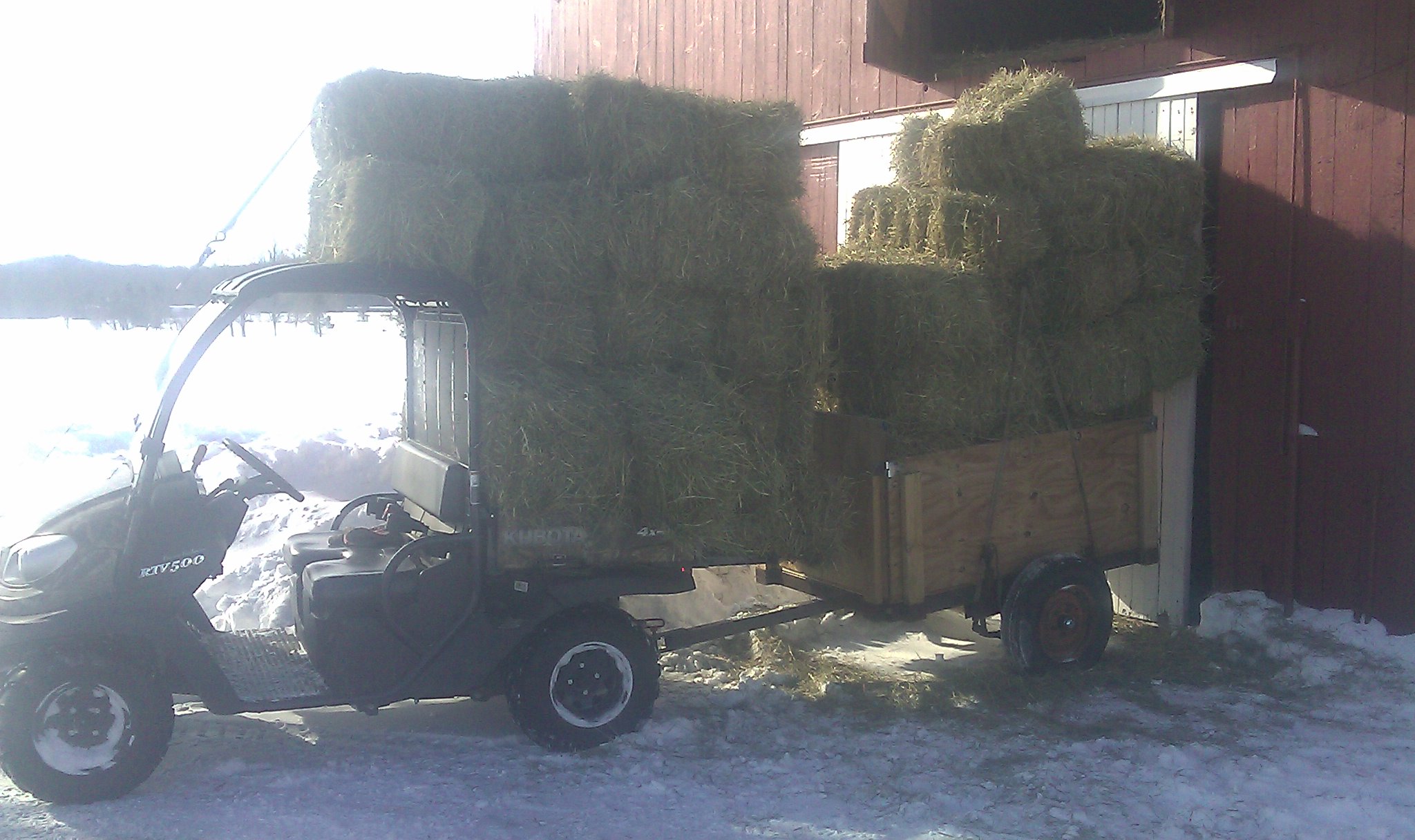

To those who said that the tongue wasn't strong enough, you were right, but the problem was the vertical dimension, not the horizontal one. My brother was using it last week to move dirt and when i got home from work he told me that "The first load, I filled it all the way up, the second, I only filled it halfway and the tongue broke" . My guess is that the first load was filled all of the way back, while the 2nd only put dirt in front of the axle (causing more tongue weight, but less overall trailer weight).
Adding diagonals wouldn't have helped much with this though as it bent vertically:
Need to hit up the local fab shop and get a heavier piece of c channel or tube to replace the tongue.
Aaron Z
