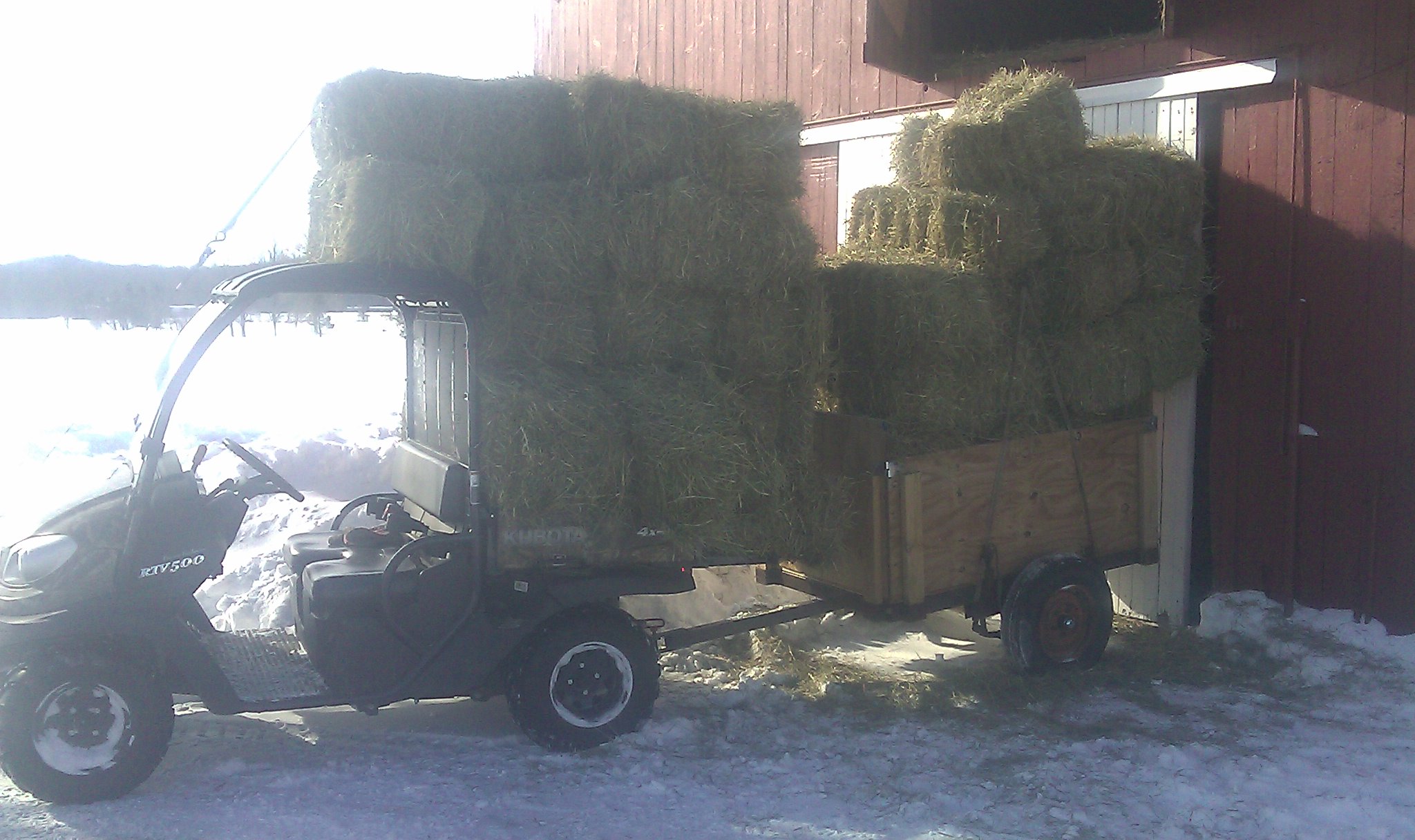

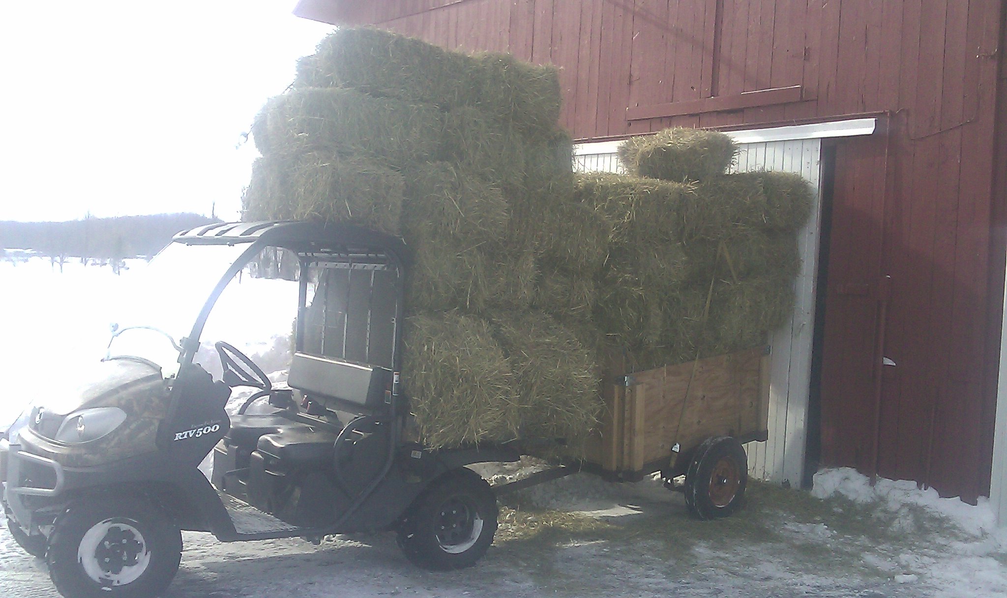

Finally got myself, the trailer, the neighbor and his welder (now a Miller 211) in the same place at the same time to put a new tongue on the trailer.
We cut the old one off in two pieces with a torch and built a new one from 3"x3" 3/16" square tubing.
The next morning, we loaded the trailer with 18-20 bales of hay and put another 18-20 bales on the RTV to get hay down to the barn for the animals. Worked well.

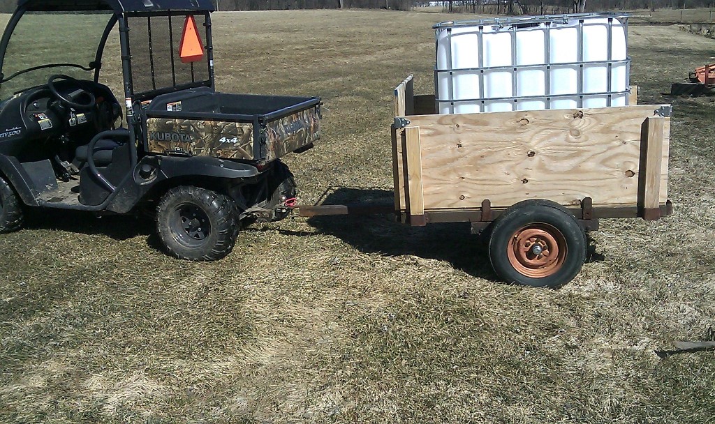

Had a friend give me a couple of IBC totes (originally had food safe soap in them) and they fit perfectly inside the trailer. Should be just right to put a pump in front of the trailer and they should sit level behind the RTV once I get new(er) wider tires installed on the rims.

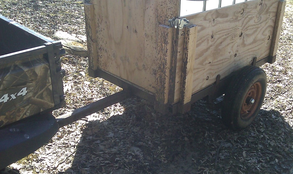

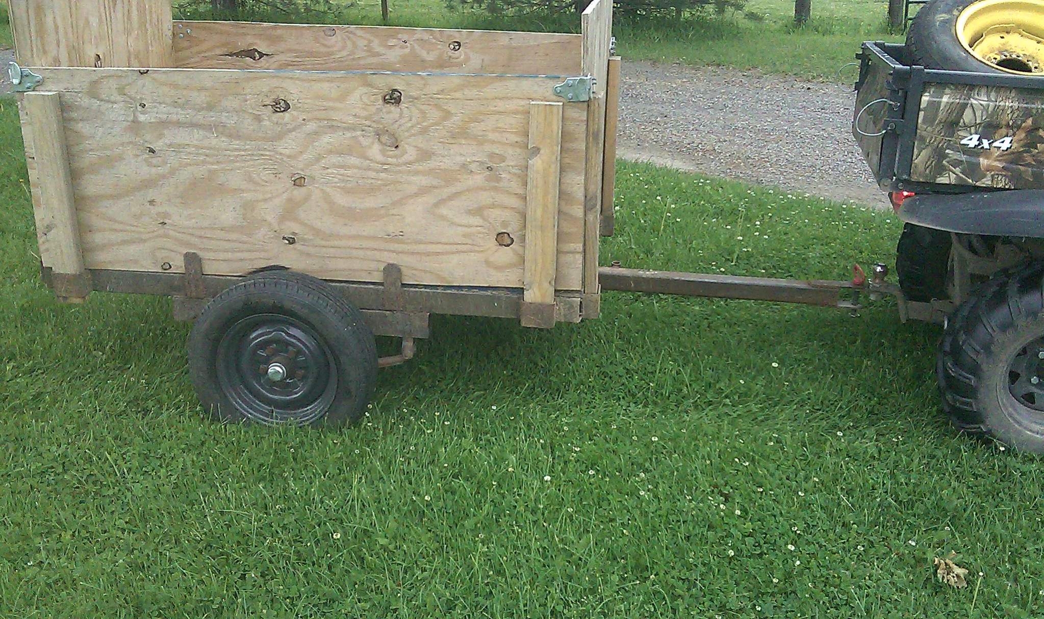

I almost made the same mistake with the tongue you made but a fellow jeep friend pointed it out before I welded. Ended up running the tongue to the first cross member with gussets. It's all scrap metal and a new Northern axle. I beat the snot out of it with wood and sand no problems.

Nice trailer. How have the lights held up being so exposed?
Aaron Z
   / New woods trailer for our RTV... #26
Aaron Z
Surprisingly enough they're ok. But if I had to do it again I wouldn't use them. I made a snowmobile trailer for a friend recently and found skinny length led lights that were much easier to install and a lot less susceptible to being ripped off. These square ones... It's only a matter of time.

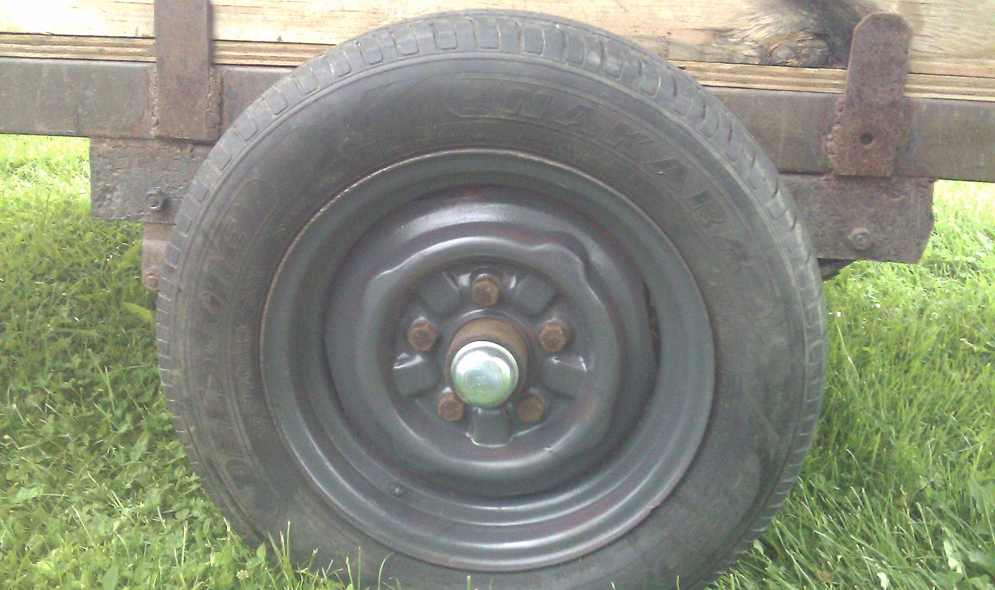

And an update with the new (to me) tires mounted on the trailer:
I cleaned up the rims, primed them and then painted them Kubota ROPS grey before I had the tires/tubes mounted.
