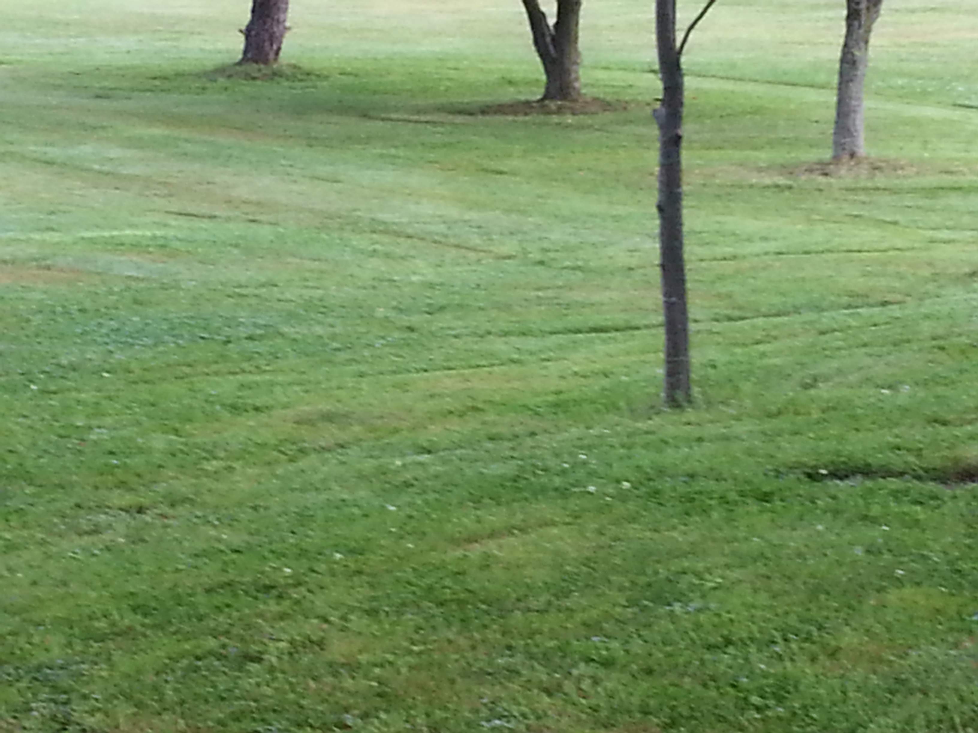

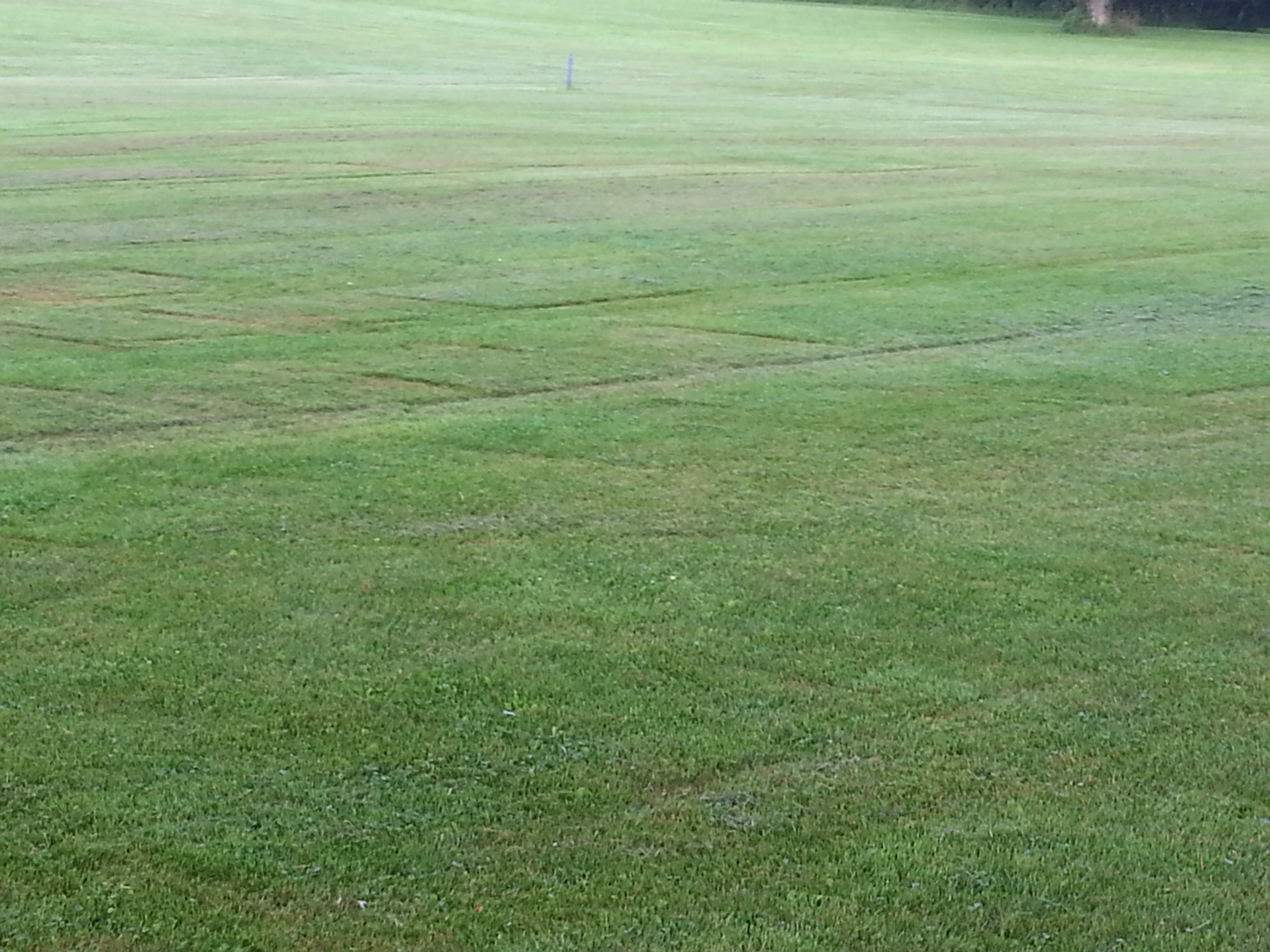

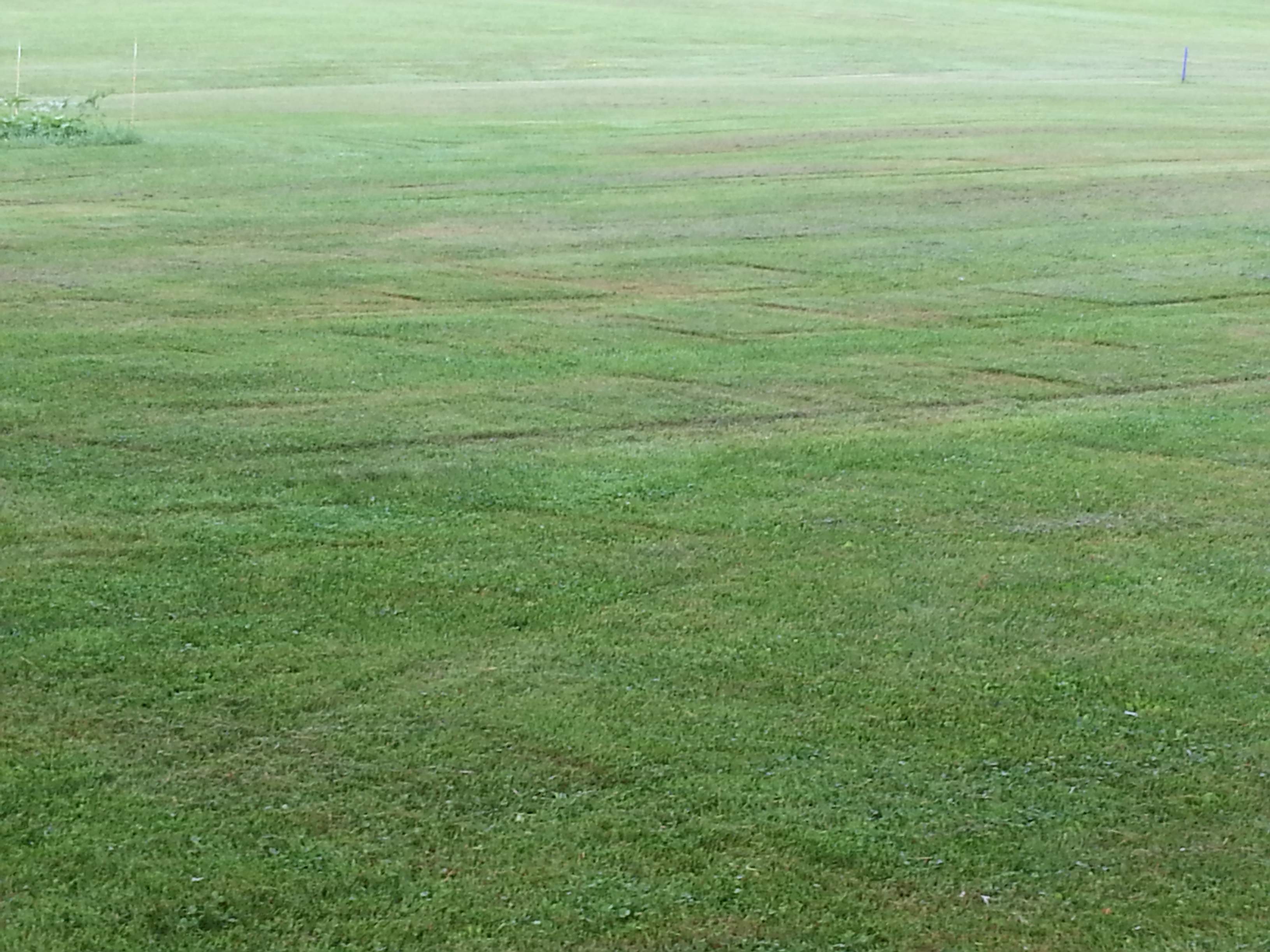

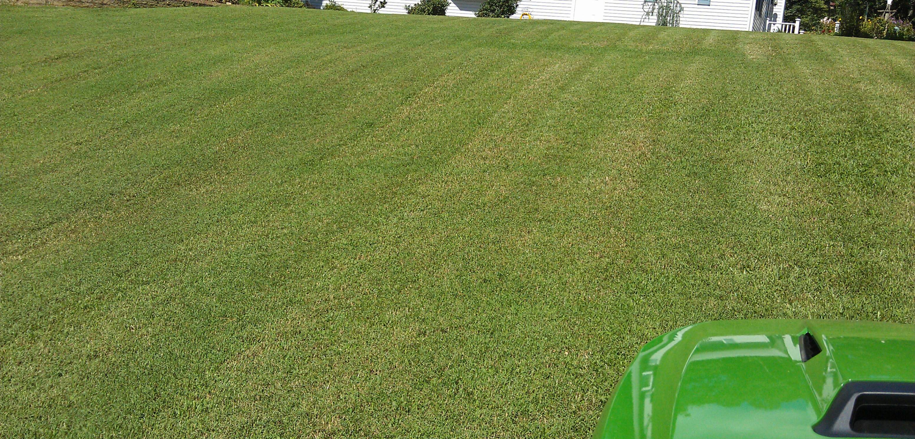

Unfortunately, I would have to agree that the cut quality on the JD X7xx series does suck compared to other mowers I had. The Scag Tiger Cat I had put the JD X748 w/the 60" 7-iron deck to shame. I think it is mainly because the deck on my JD X748 is rigid and does not float like the Scag's Velocity Plus deck, which the Scag used chain links to make the Velocity Plus deck float across bumps and etc. The JD cuts well on the flat areas of the lawn, but when you hit bumps, hills, banks and etc., the mower digs in as shown in the picture I attached. Unfortunately, my X748 has been back to dealer to check this issue and they said it was the tire pressure, but when I got it back, the tractor mowed the same way. Heck my Woods PRD8400 mower on my JD 4520 put the X748's deck's cut quality to shame when cutting the same area, but again the Woods deck floats. I think if JD would make the deck float on the X7xx tractors and put an anti-scalping roller in the middle of the decks, it would improve the cut quality of their deck.

That is a terrible cut in the pictures. I have a x720 with a 54" cut with gator blades and my cut isn't like that. I can't understand what the difference could be.

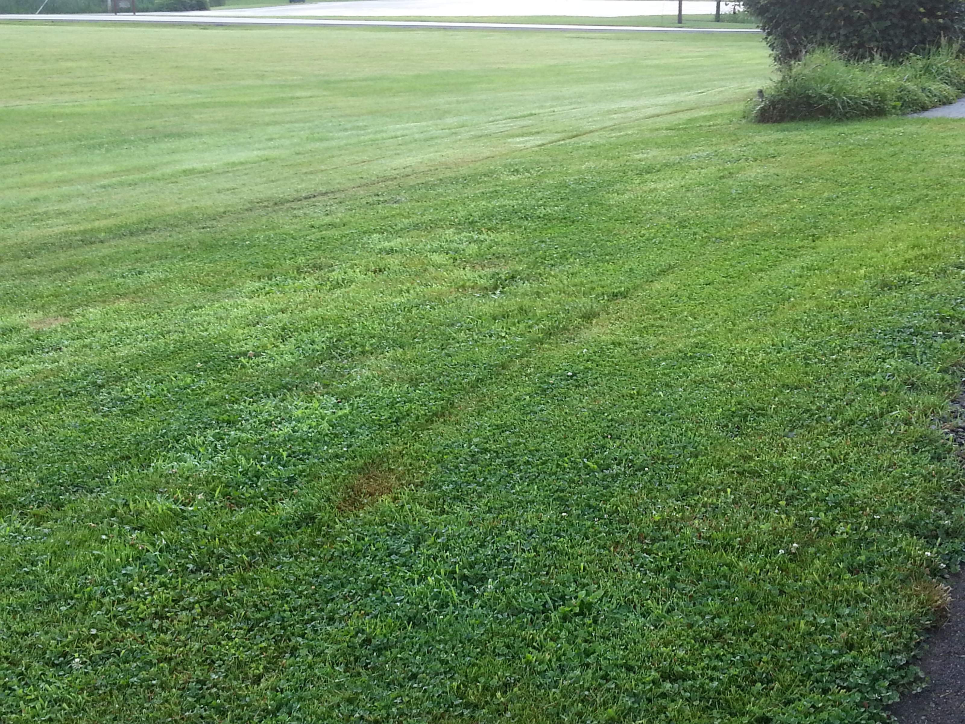

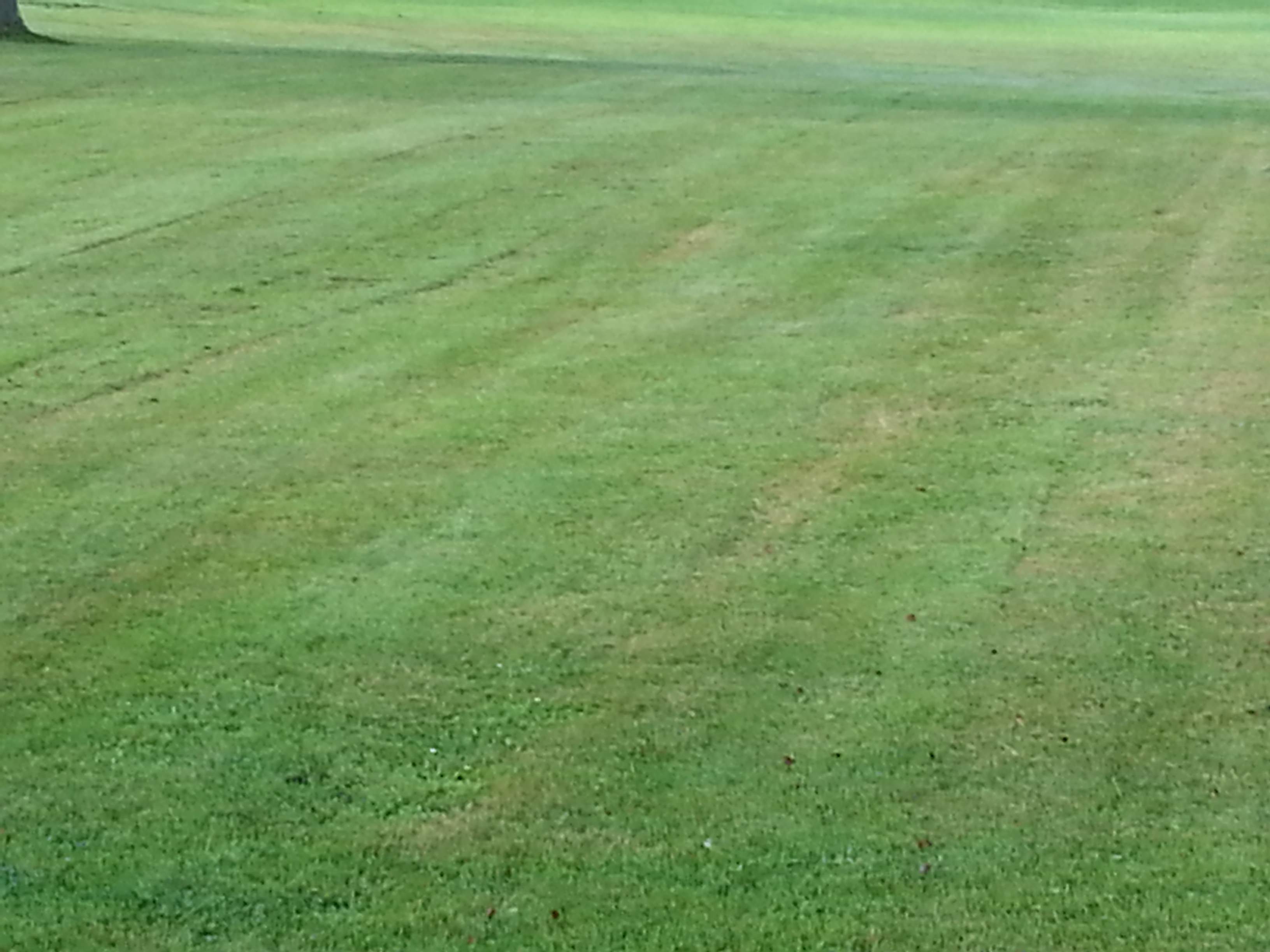

Eagle 107: I swear you copied my pictures from Lawnmowerforum. Dealer picked mine up, returned it 7 days later. Replaced drop link. Said Deere had a trouble call or something their blog issue report. Didn't fix my problem. I have 54HC, 22 hours on it. The best cut I get is when you let the deck ride on the anti - scalp wheels. Manual says no to this. Anyhow, every time I check my
Blade/deck depth measurement. It is off by at least 1/2 inch. Now trouble is when Dealer returned it the adjustment hex bolt was at the end of threads. I placed 5 washers on the head side to gain adjustments. I also greased all draft, drop link, Mower connection points with molly lube. Now My Dealer is saying it wants it for a short time to have a factory rep see it. Bad thing is I think it is a flaw in the construction of the draft/tractor assembly. It rides nice nice. It flexes and dips from tires, center of gravity high, rocks and rolls enough to dip one way or the other cutting a deeper profile on the leaning side. It is a simple connection so very little else could be at fault. I think next step I am writing Deere headquarters. My tractor is X758. Had a JD 445, JD 4110, L135. All provided smooth cuts. Now I dump 13k in a Flag Ship model X758 and it cuts terrible.
View attachment 337049View attachment 337050View attachment 337051View attachment 337052View attachment 337053View attachment 337054
Man that is absolutely terrible. My Ferris will scalp a little on the low side like that when mowing on a slope, but never on flat ground. I have some pretty good slopes and no matter which direction I go, I either get the ledge cut like in the photo if going parallel with the slope or scalp the top of the hill when the mower breaks over the top and leave it a bit long when leaving the slope at the bottom. If I raise it to 3" height, it isn't as noticeable but its still there. Yours seems to be doing it all the time. Have you put the mower on a flat concrete slab and checked the side to side level? Tires exactly the same pressure?
My 445 with the 60" deck is the most sensitive I have ever worked on related to air pressure.
It seems 1 lb of pressure variance will screw the thing totally up.
The wider the deck and the slimmer the wheel base the more sensitive this is.
The fatter you are and the more you lean you might skew the cut.:shocked::D
And, you need a low pressure gauge to check this, like used on ATV tires.

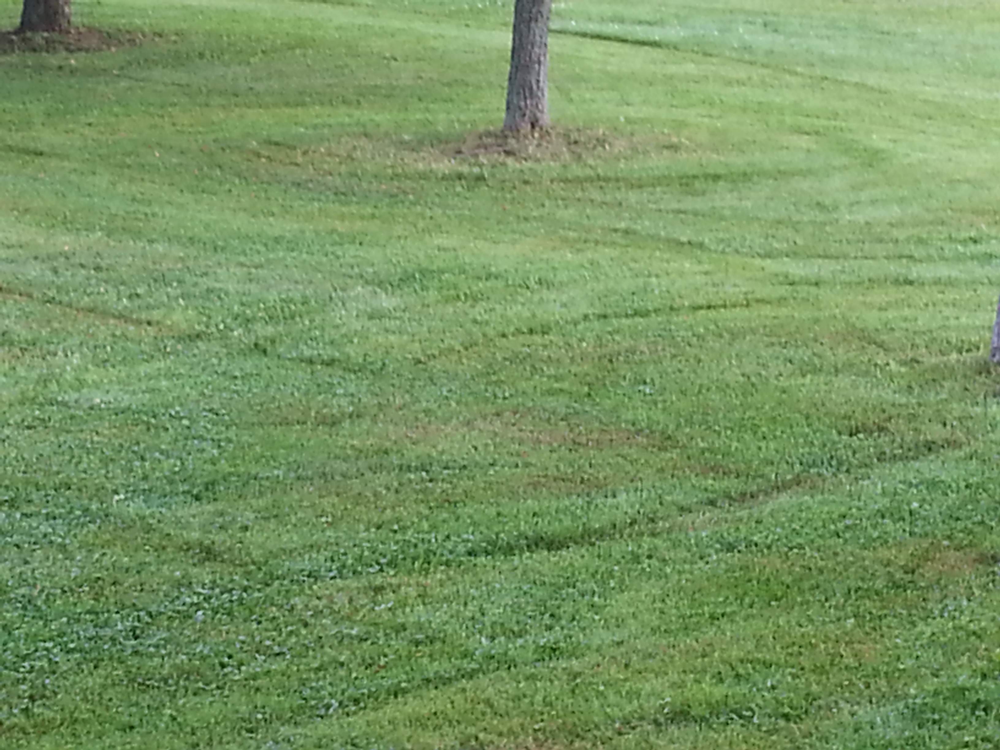

I have adjusted the mower multiple times, and then the service manager from the JD dealership took my X748 two weeks ago, check/adjusted the tire pressure and adjusted the mower twice to make sure everything is correct, but the deck still does not cut right. I really believe at this point it is a design flaw with the larger mowers. The mowing deck is just rigid on the X748; there is no flexibility in the deck to float. So when the tractor hits a depression or rides on an angle, the deck staying fixed just following the angle of the tractor and trends to dig in, which you can see from the photos. I mow at 2.5" and if I raise the deck to 3" it is a little better, but not much. Now the Wood PRD8400 (84") mower is set to 3" and when I hit bumps or cut embankments, the 3pt hitch pivots allowing the mower to float and leaves a great cut all the time. The 60" 7-iron deck will cut fine on very flat surfaces, but once you hit minor or major bumps in the lawn, the cut quality goes downhill fast as the photos show. I guess I will have to write to JD to see if they know a fix for this or if anyone has a trick to fix this, I am all ears. Thanks!

Yes, the tire pressure was double checked at the dealership and the mechanics made sure the front tires were set to 7psi and the rear tires were set to 10psi. I sent an email off to my dealership's service manager with same photos and the service manager is really upset that the 7-iron deck is cutting like this. He called me and stated that the deck is a commercial deck and should float like the Woods and Scag decks. He is going to have tractor picked up soon, but he want to have his tech submit a D-tech ticket to JD first and work with JD to figure out why this might be happening. I am glad I have such a great JD dealership to work with. Hopefully, they can work with JD to figure something out.

I would suggest the following. (1) Raise the tire pressure to 12 PSI for front and rear tires. (2) obtain a blade height adjustment tool from JD. The plastic device cost about eight dollars. This will allow you to accurately adjust the front to rear and side to side deck height. (3) park the mower on a flat level service, lower the deck then take a lift assistant (stick) and see if you can raise each side of the deck. If the deck will not move upwards, something is installed wrong which is not allowing the deck to float.
Comment: From the photos posted it appears the deck is lower on one side than the other and the front to rear adjustment is also off.
   / New X749 with 54C deck has terrible cut quality #40
I kinda agree with slightly higher pressure that will keep them for running lower on a sideways slope.
That mower seems too heavy for 7psi.
In some cases I find it necessary to run more air in one front tire to level my old deck up.
My neighbor has a sloping yard like the one in this photo above and I mowed it last week.
Even with my deck it was butchered up similar to this.
They mow it up and down the hill like you did. I mowed all of it in a CCW circle.
