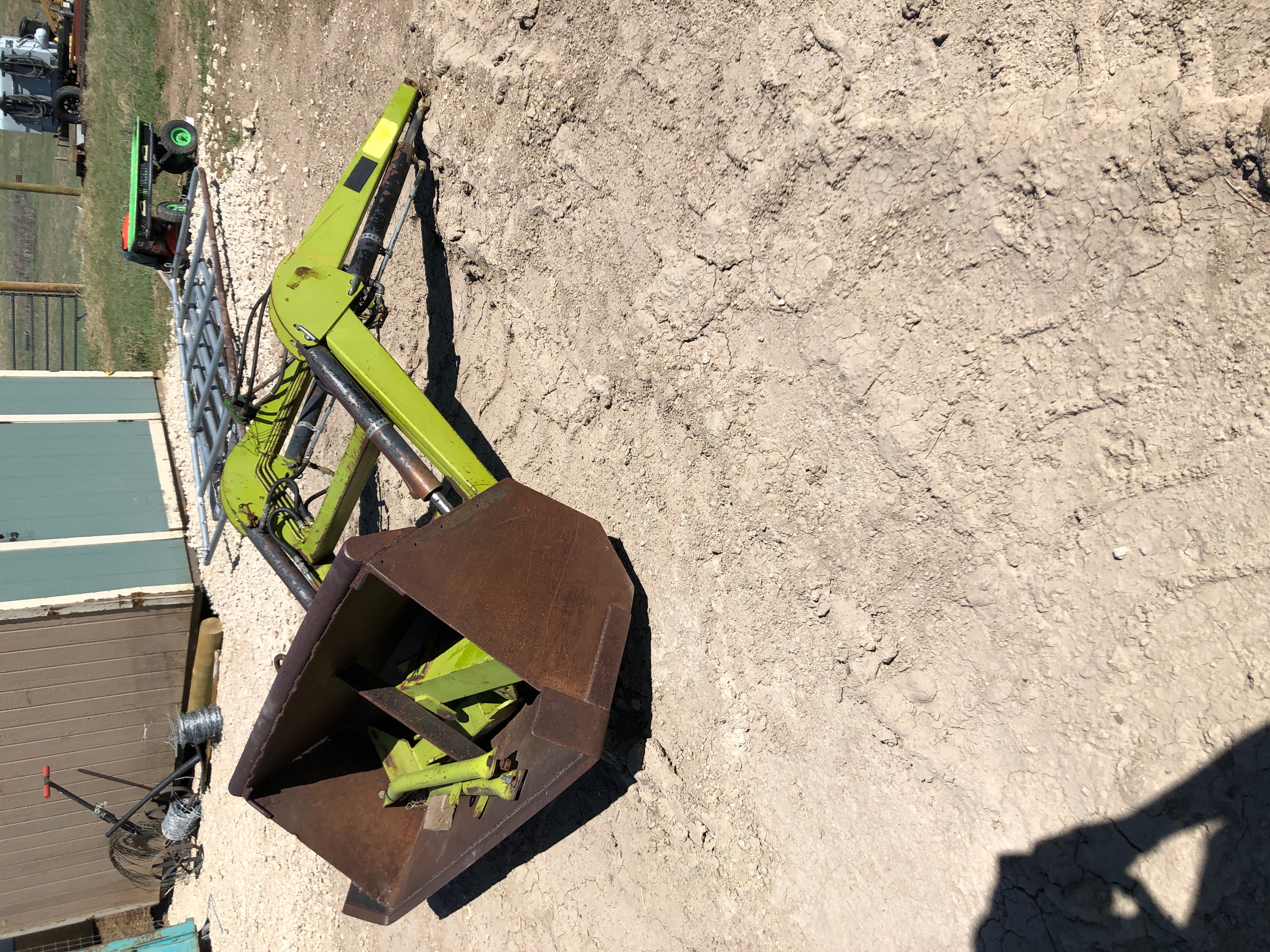

I actually got fenders. I have to do a little metal work to them then paint to match the machine :)
Also have a loader for it on the back of the truck. It needs love. Needs all new hoses, likely rebuild the cylinders and of course, paint.
But hey, I got one. :)
