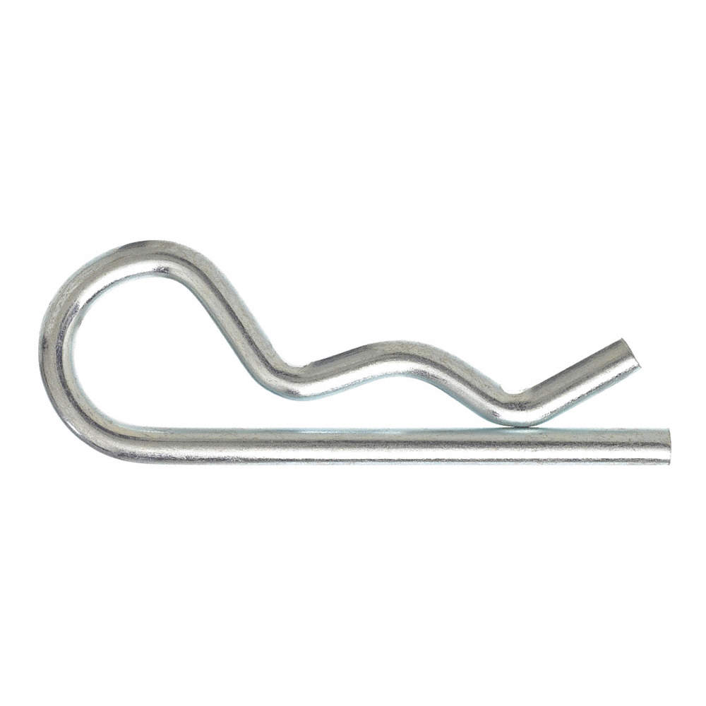

Perhaps cotter pin was the wrong term. I was thinking more like this style.
At least 3/16”
I figure 3/16” would be sufficient to keep the arm inward. Maybe a flat washer between the pin and lift arm ball. View attachment 649995
I fear that even that style pin in place of a cotter pin will not hold up to the force that can be placed on the lower lift arms and pins holding them. Realize the size of lynch pins that are used to secure your lower lift arms to the implement pins. My tractor uses a similar pin with lynch pin to secure the lower lift arms at the differential housing. Also keep in mind that lynch pins are harden.
With all that in mind, if you have the capability of making pins on a lathe, you should also have tools to make very exacting measurements, my suggestion is to carefully measure, then cut threads and secure your long pins with nuts and lock washers. I could not tell you the last time I removed my lower lift arms. So ease of removal is very low on my list of concerns.
