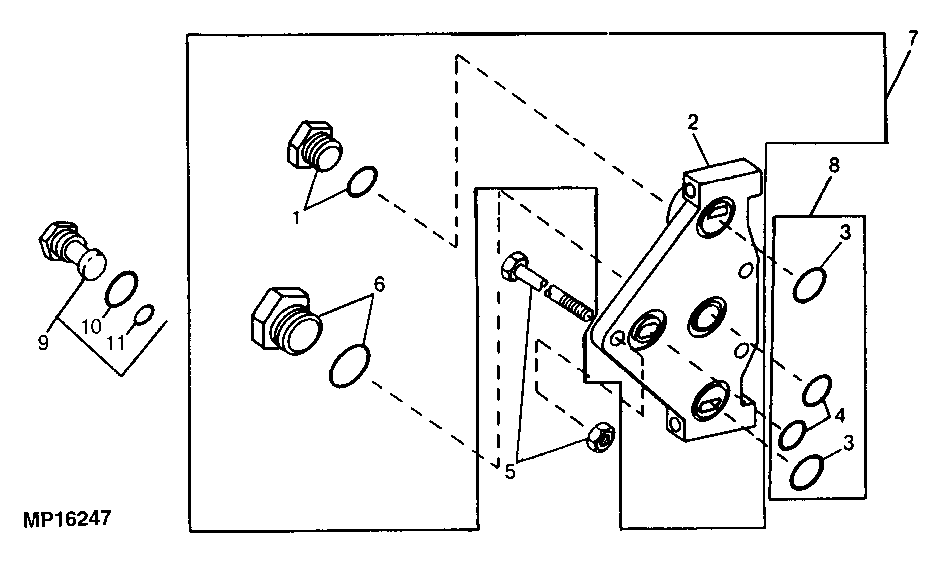

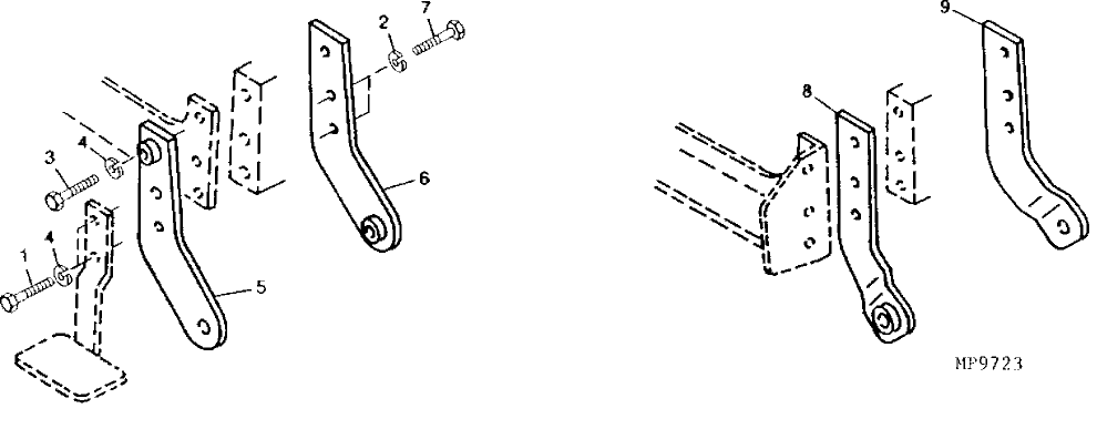

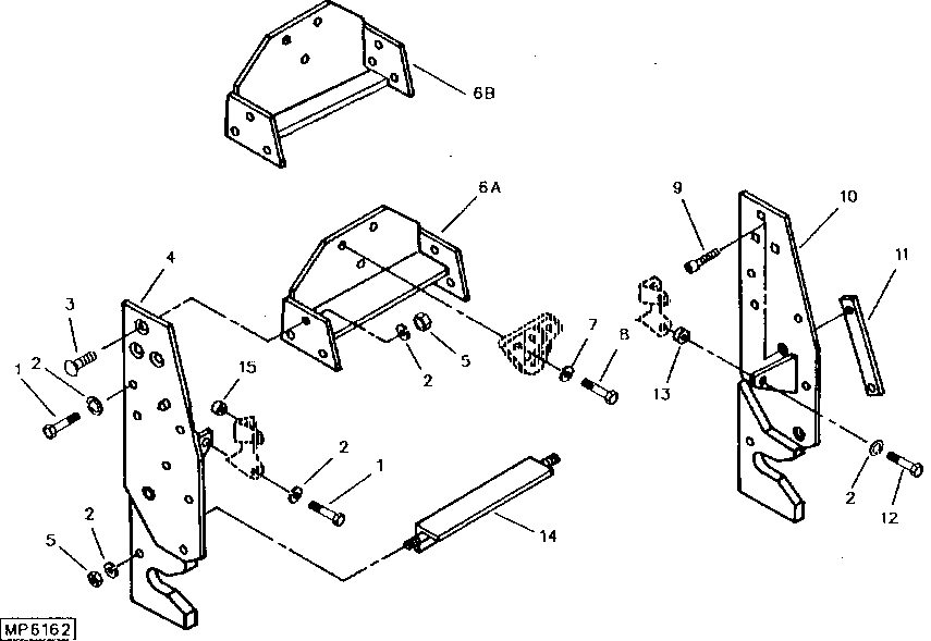

Fair market price . The front and back mounts must be changed to the Dubuque/Mannheim type for your tractor. The hydraulic plug for closed Center will need to be installed. Return the oil to a ported transmission filter cover.

Closed center plug is parts key 9. Frt & rear hangers pictured should be for 1020.
