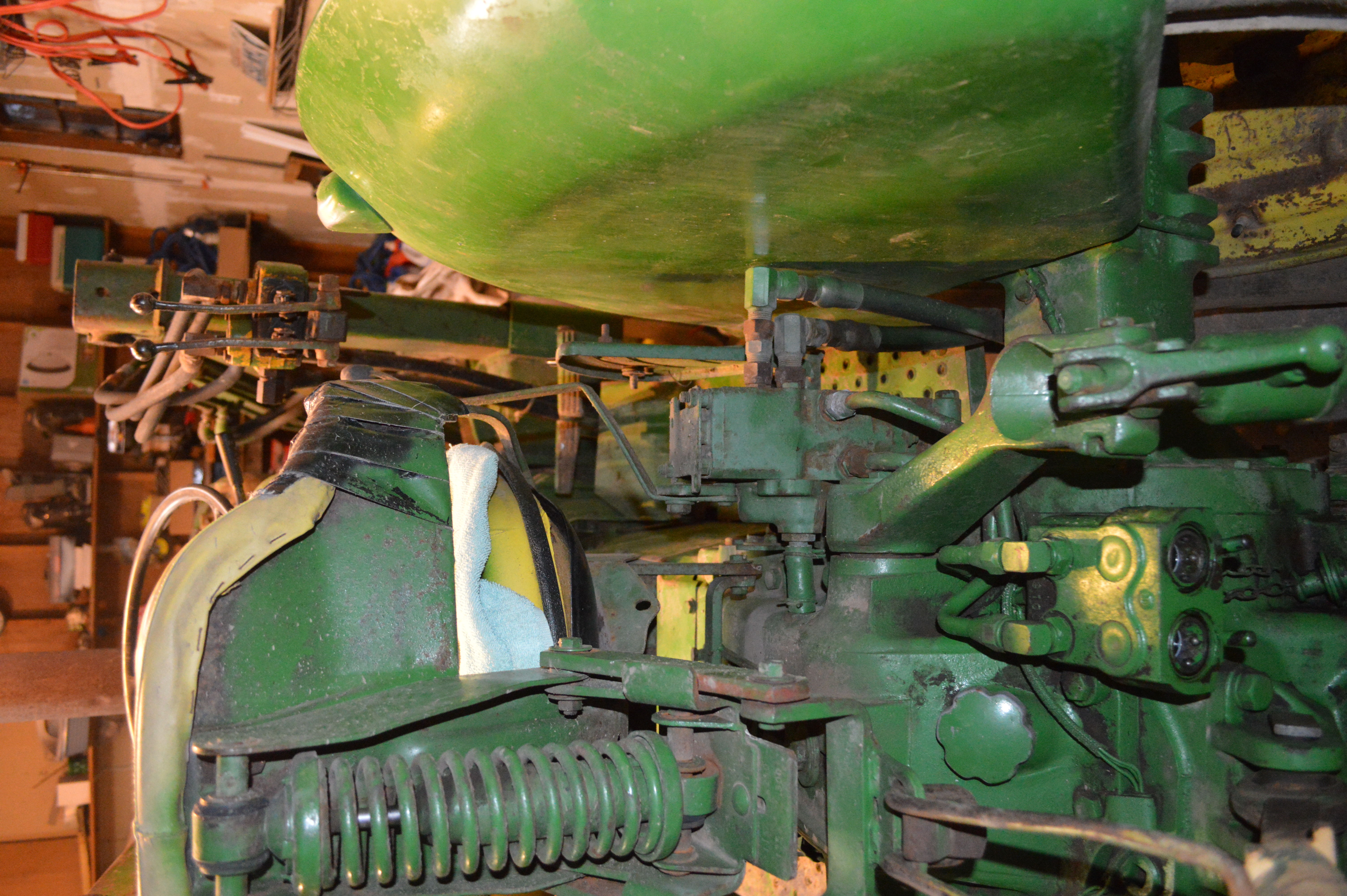

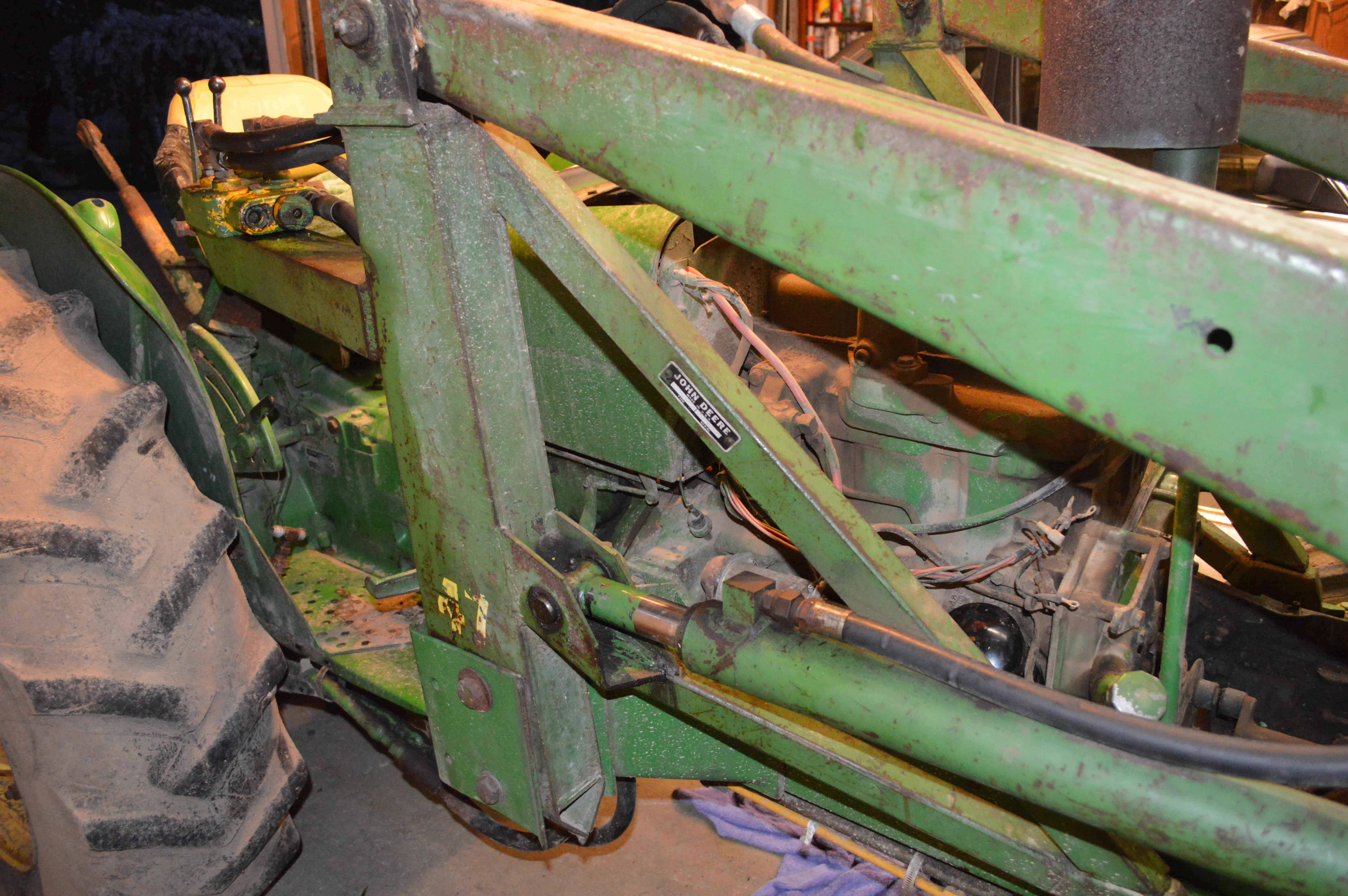

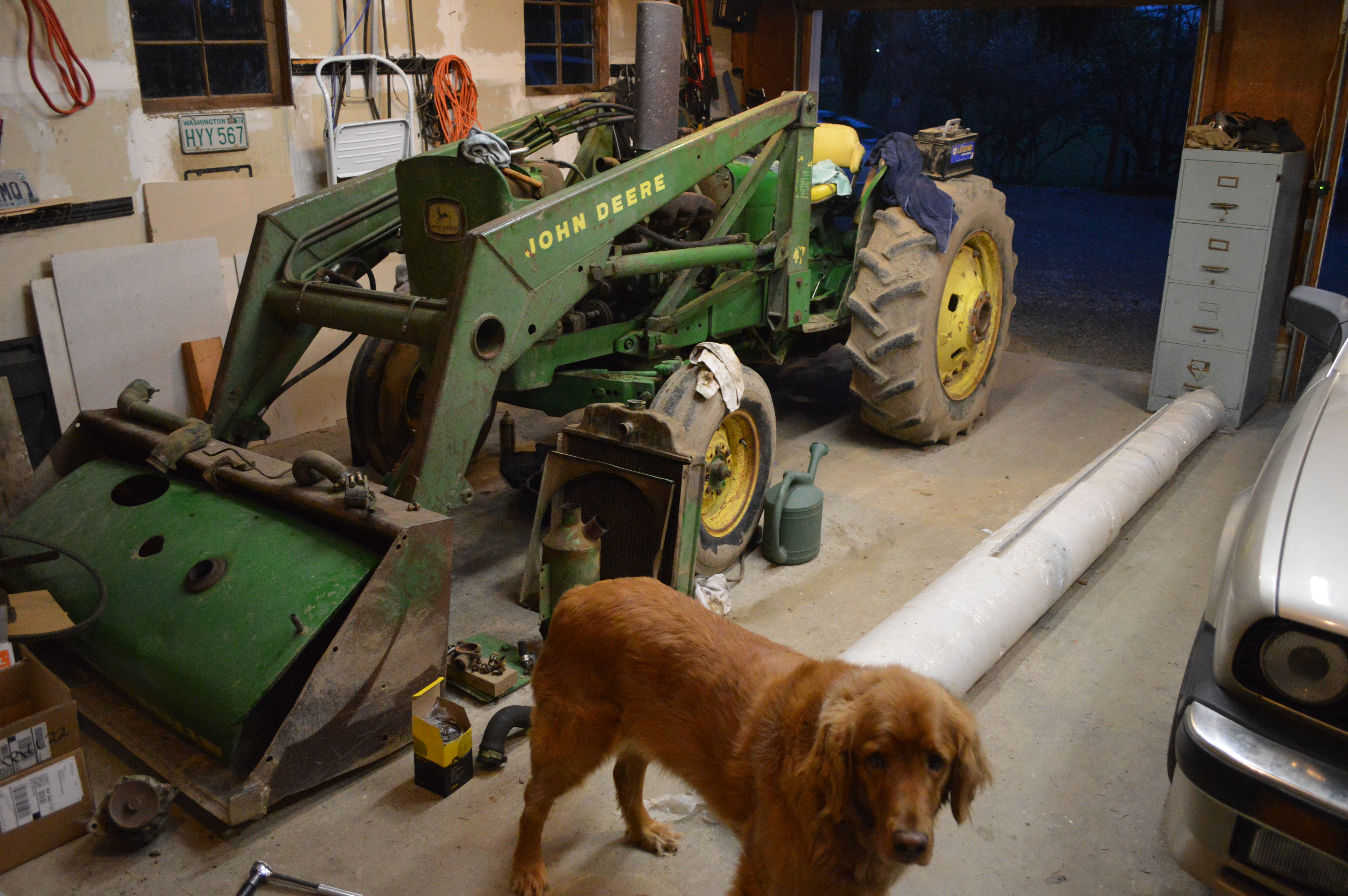

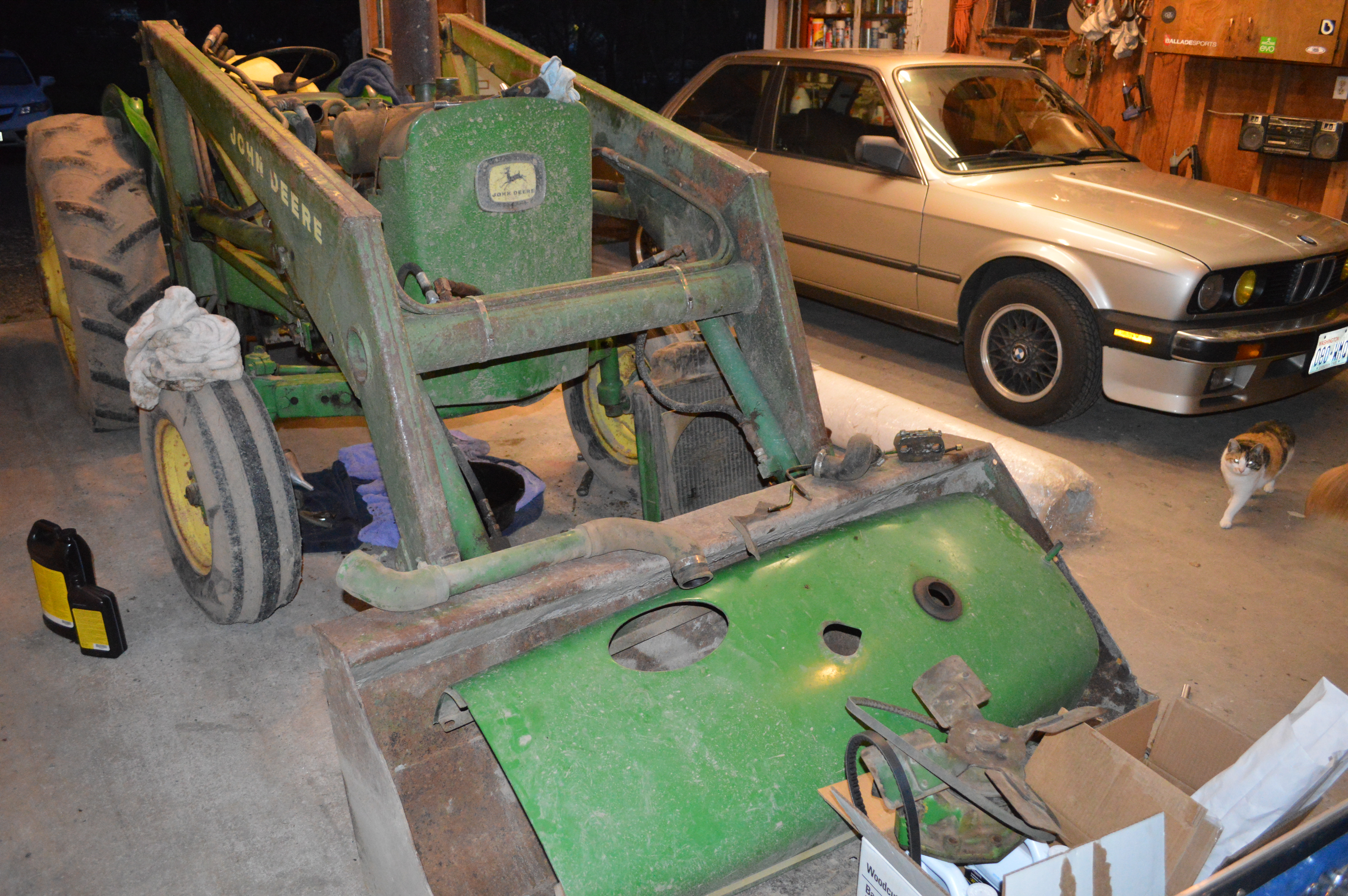

View attachment 461306View attachment 461304View attachment 461305View attachment 461301View attachment 461302View attachment 461303View attachment 461300
Here are some photos that I just took while I am working on the old girl.
Please feel free to tell me what you see in terms of the hydraulic system used, ect. So I have a dual rear detachable remote setup? How does this setup work exactly?
AKA educate me haha.
Thanks everyone!!!
Pic 6 is what I was referring to.
And thanks for the explanation about the "pioneer" term being a proprietary eponym.
   / New, Young, Uneducated owner of a 1969 JD 1020 diesel #40
At least that's how I understand pioneer to be used.
I don't know how to tell from a female coupler what the ISO style is other than looking at what's stamped on the outside.
From my limited experience the IsO 7241-1 series B has been the most common.
The size (i.e. 3/8") is the internal diameter and in practical terms dictates the size hose you pair it with. So if you need/have 3/8" hose you use/have a 3/8" coupler.
