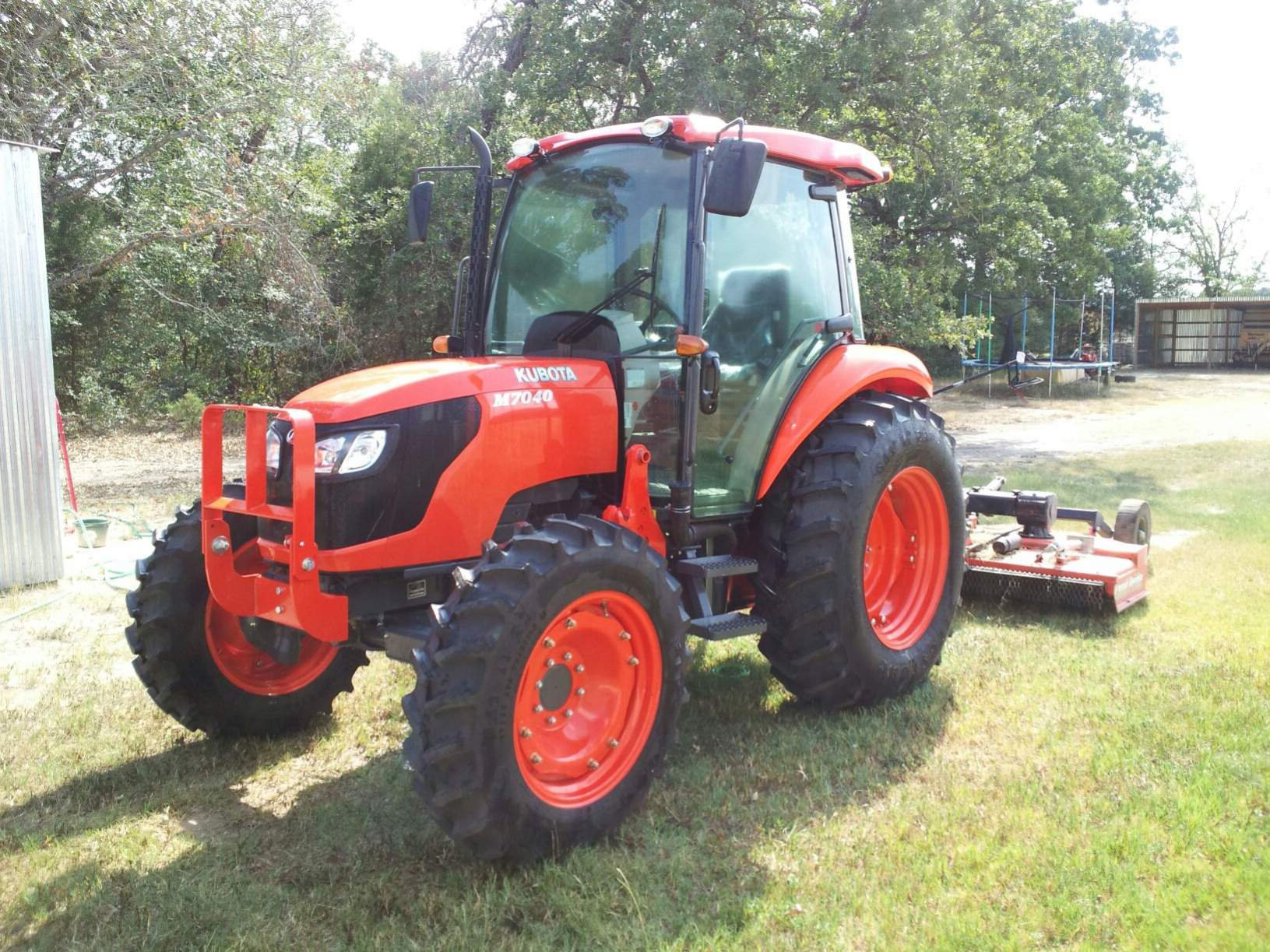

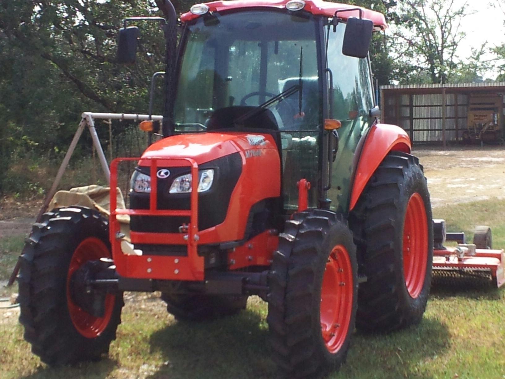

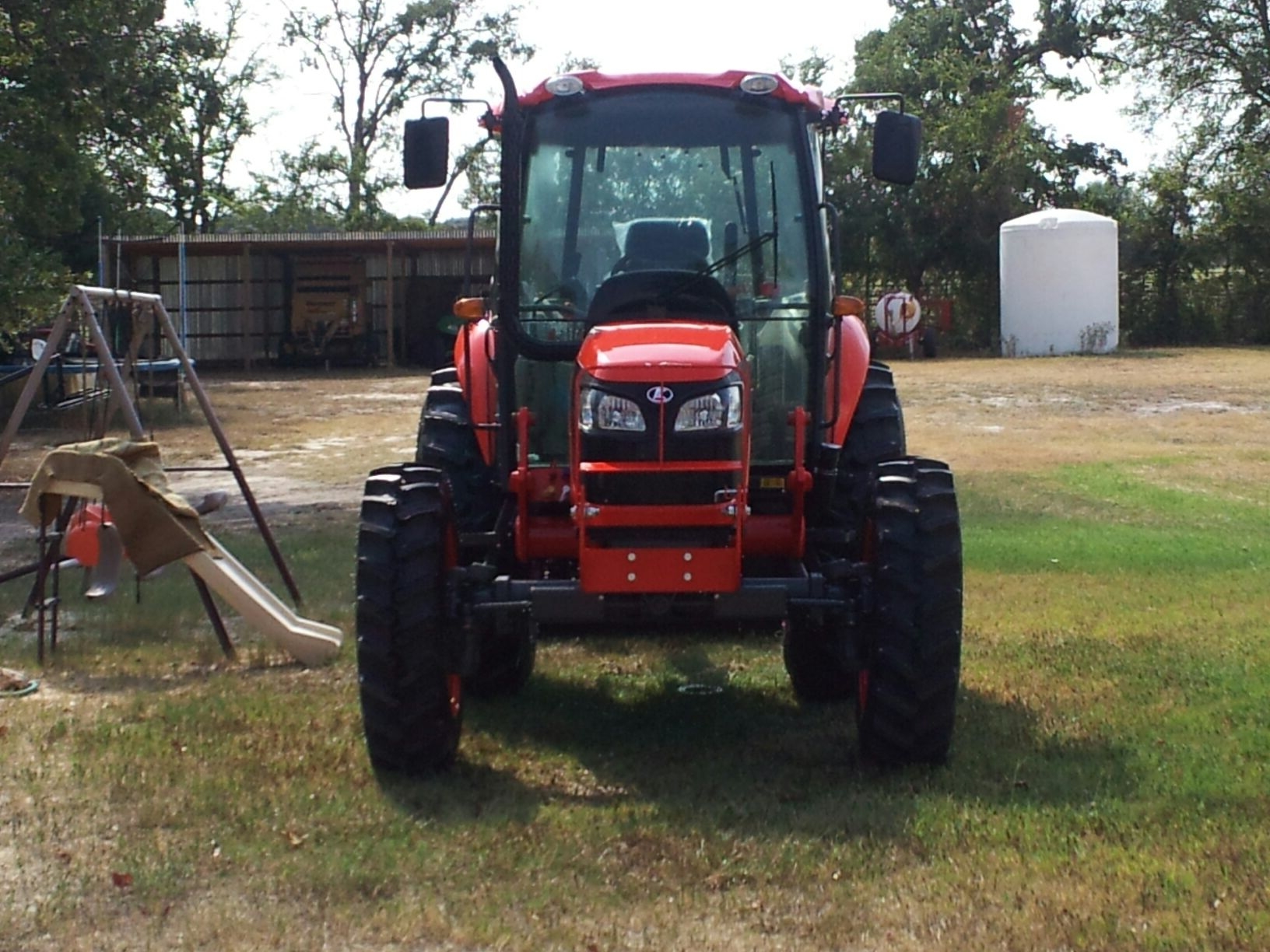

Well I just got the new tires put on and figured would post a cple pics. Tires and rims are what come on the 8540/9540's. Also turned it to wider stance but not the widest it could go,had to un-bolt center part of rims.

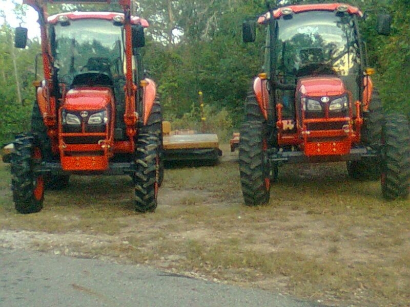

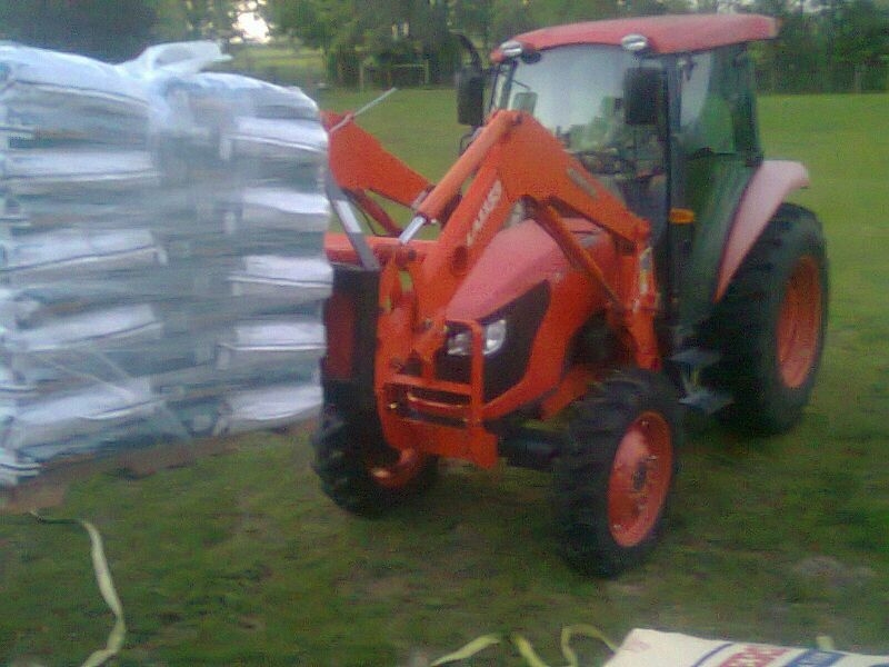

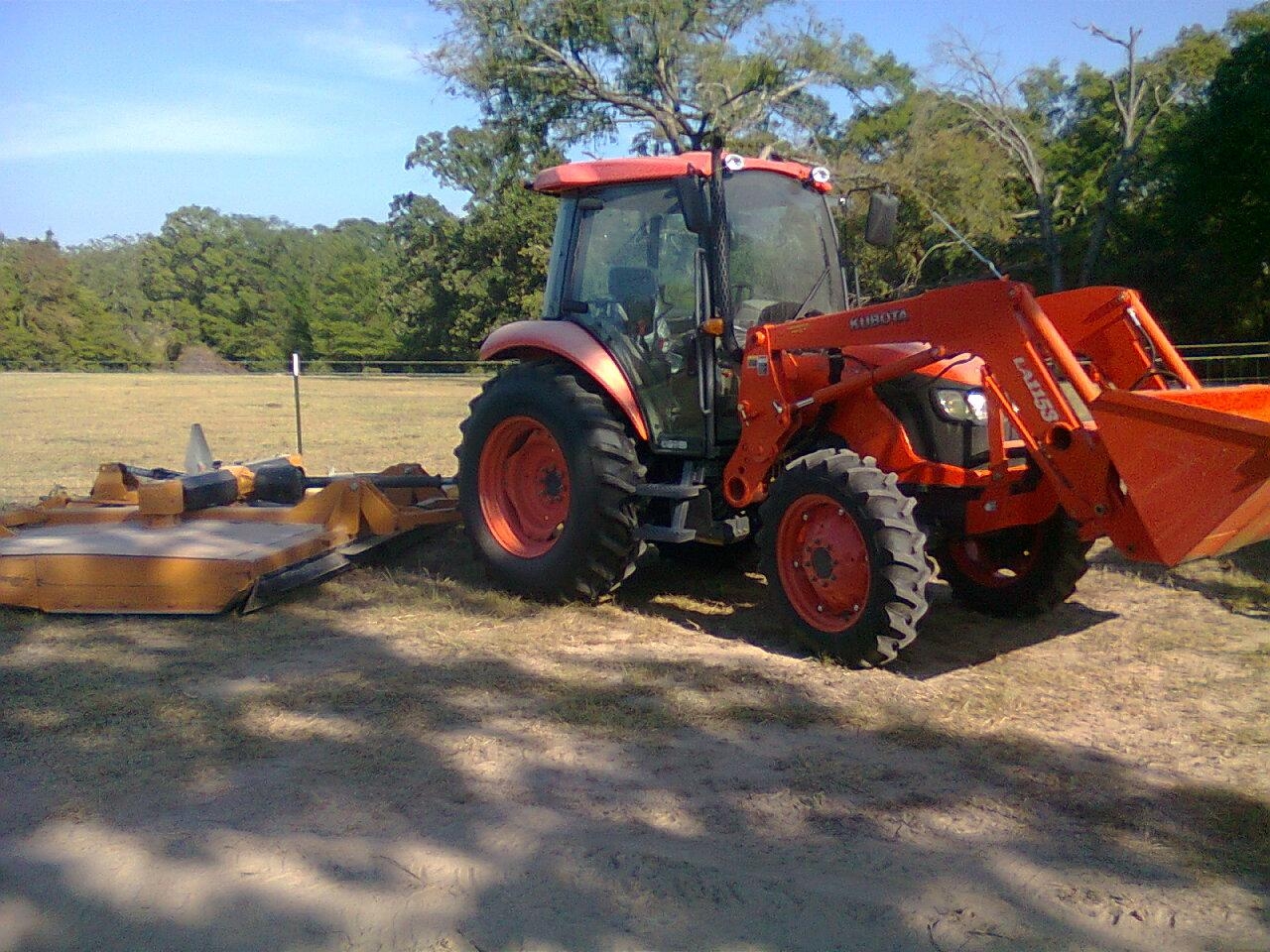

Thanks Roger is rides so much better than the other one thats stock form and this was the first time had the loader off any of the Kubotas I have had.I will always take it off now,since have the other 7040 with it on..Heres photos of the other 7040

I think they are narrow from the dealer too-how wide is the new rear?
It is also nice to be able to get through the smaller gates...especially in the winter for plowing up from the barn.

Sorry guess I should have included what the sizes are,the front is a 11.2-24(standard size 9.5-24) and the rear 16.9-30....
And what I have never got was that the rims dont match on the 7040snew 7040.JPG,here is a photo of my old 50405040 and ds1440wheelie.JPG the rims match. The new front rims I put on the 7040 look like they match,the back ones better now,I thinknew7040 tire change2.jpg...

11.2-24(standard size 9.5-24) they are just alittle bit taller but they are both 24's and yes I trust my salesman,when I talked to him about going to them he said it would be fine they are both 24's. The rims and tires were $800 gave me them at his cost,didnt make anything off them.Had to order them so I changed out myself,had to break the center apart and turn them around so would set wider.I have 100hrs on tractor and I havent had a problem so far,did have to take the plastic toolbox off,thats mounted on side of loader...
