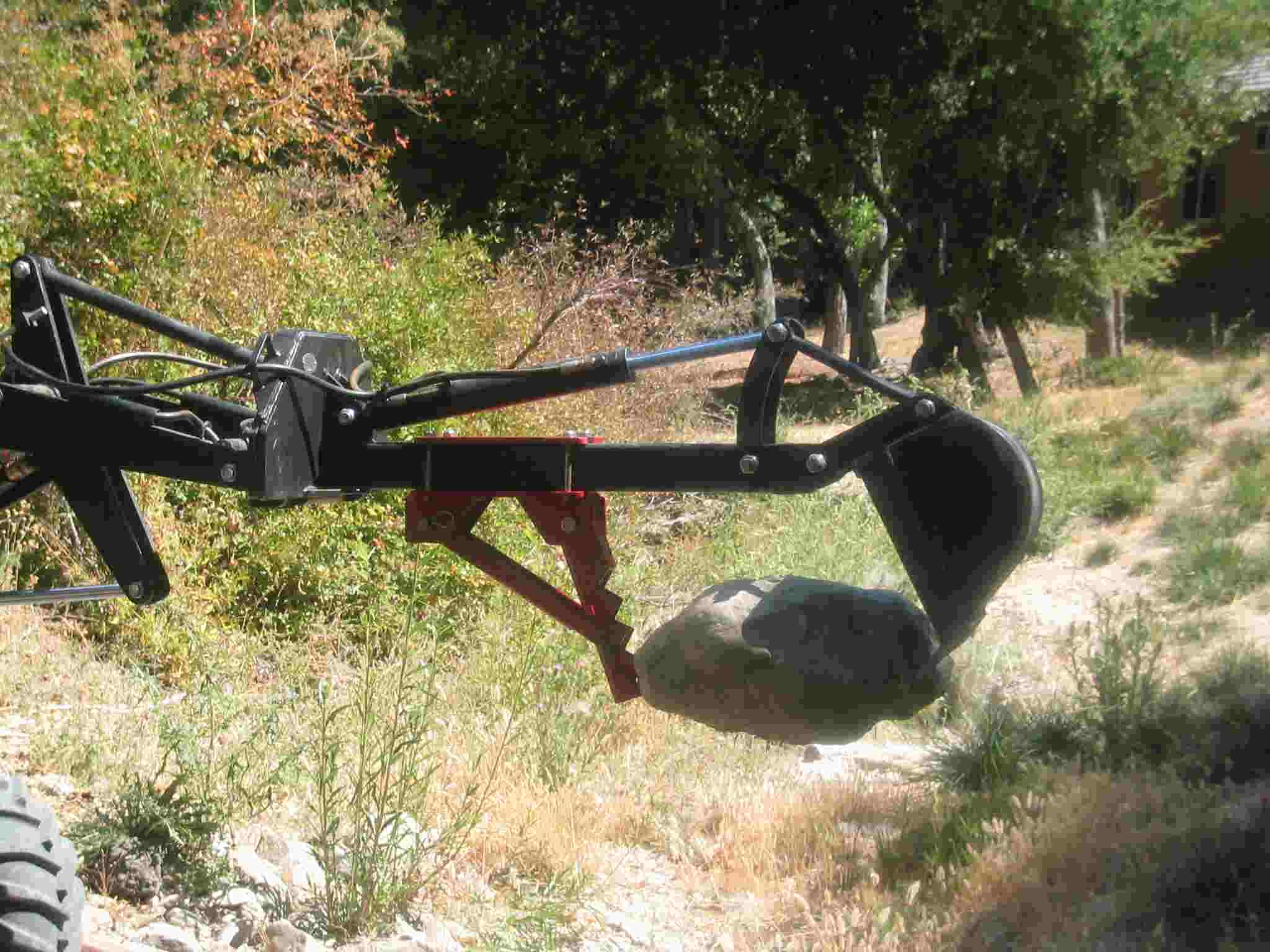

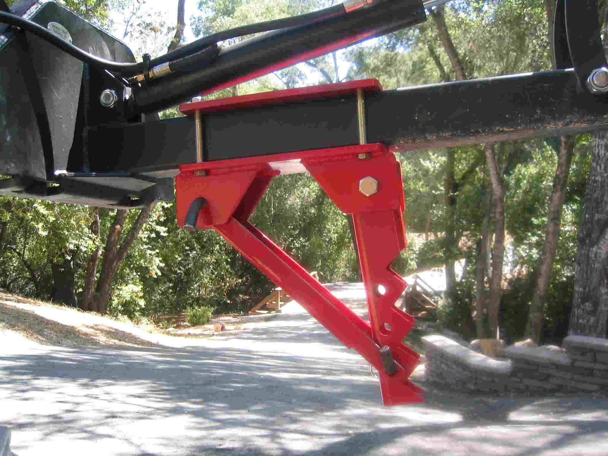

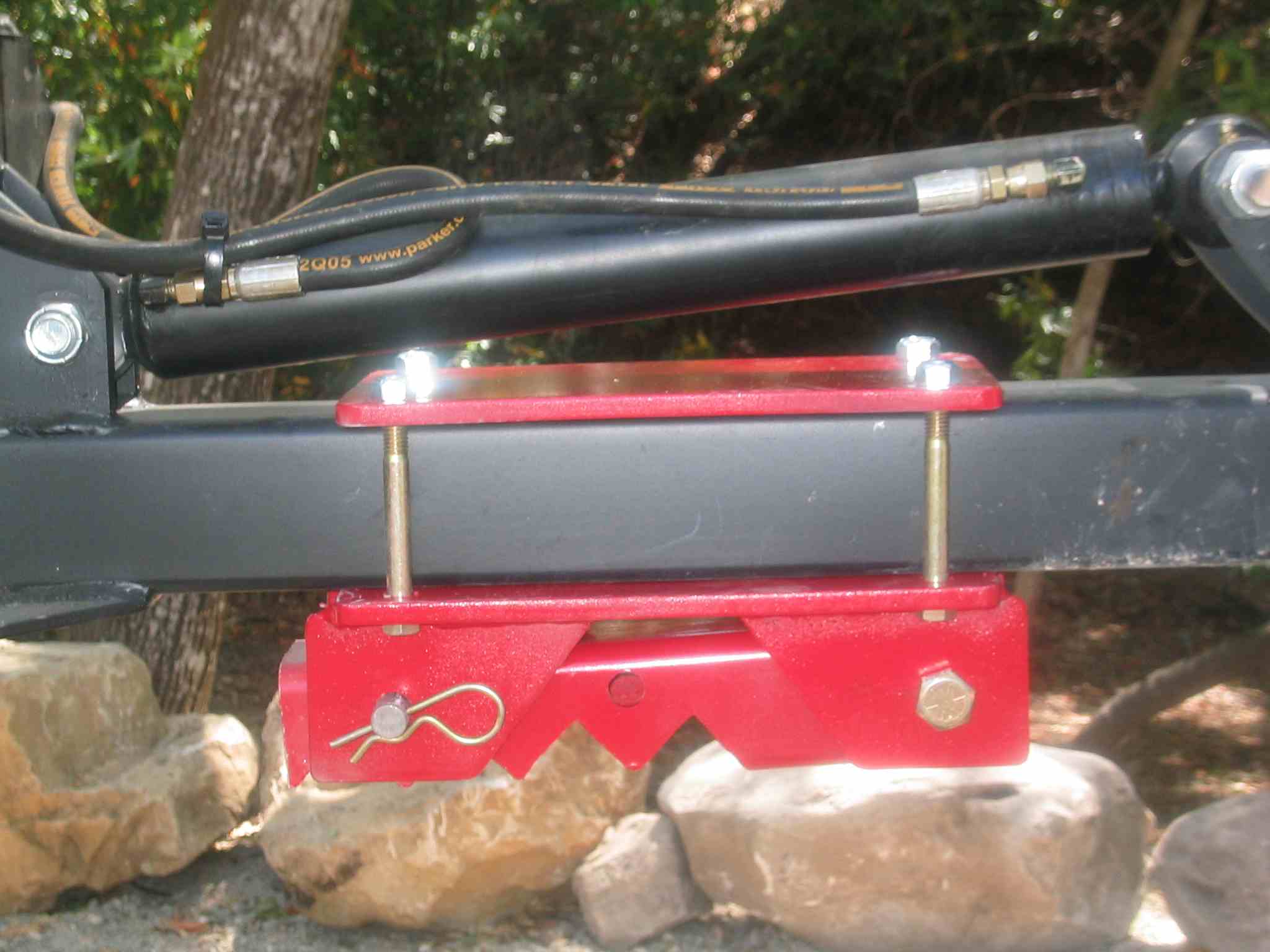

6. It has been suggested that I get a thumb for the mini-hoe. Sounds like a good plan but PT doesn't offer this, correct? Is this something you guys could hook me up with when the time comes?
Dave
I had a thumb made for my mini hoe - attached are pictures. If you want any information on it when you are ready I will provide measurements etc. I designed it to be bolted on as I did not want to weld as there are times I want to remove the thumb but it does fold to store when not in use.
