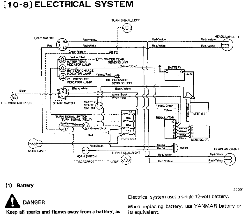

I would have to agree with Bob about the weather. I would also use the decompression on a cold start also. Here is a wire diagram for your tractor it's label is yam/240 but everything seems to be the same for the 2000 complements of Norm a good while back. On mine if you ground out the wire to the water temp. sender your light should come on. I believe that is correct still have Half Timers going on so don't hold me to that. I would have to go out to check for sure. And after Being out in it all day yesterday it aint happening.
Carey

Carey, yes, grounding the wire that goes from the temp sender to the dash will turn on the light.
When the electrical system is working normally, you can test the warning light by sliding up the connector at the sensor to expose the sensor output, then touch a grounded wire there. If everything is ok this will turn on the dash light. Trkrd, you might look for spots where the temp wire is shorted to ground. I think this is more likely than a stuck-on sensor. If possible, disconnect that wire at *both* ends and temporarily replace it with a good wire. If the light is now off, that confirmed a grounded sensor wire.
