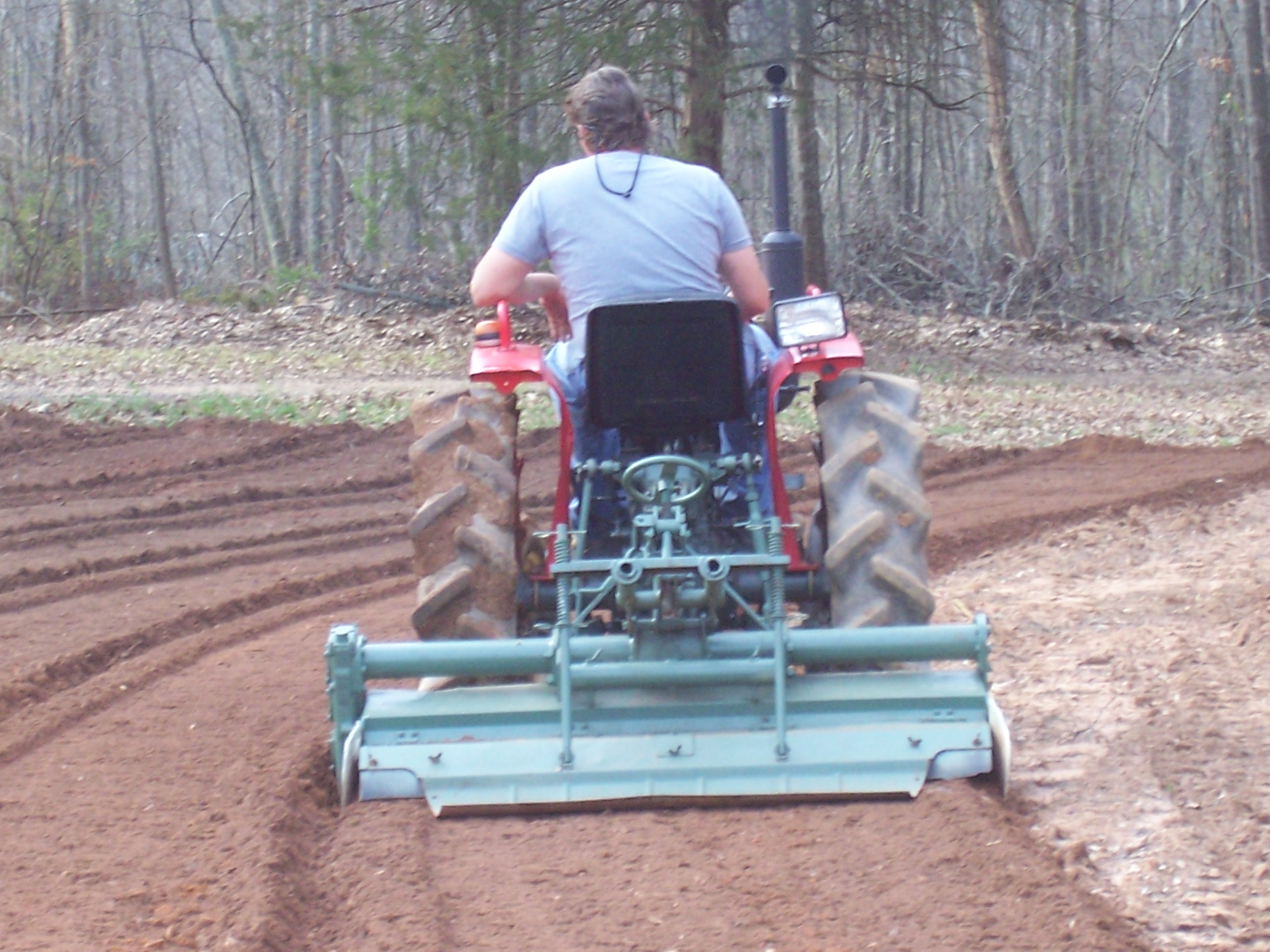

Justin I would take your alt.to a parts store and see if they can just match it with Datsun. Napa. would be a good place to start for my area.
Also hear is a pic. of what I did for a work light for the rear and it works great Just a fuseable link to a switch to the battery so I only use it if I need to and it's bright.:D

Curiosity was getting to me so I had to go check. I knew it wasn't much when I had to fix the wiring on it when I bought it. @1200 rpms I run 13.25 Dcv. It only pulls .35 with the head lights and work light on .22 with only the work light on. Or 12.90 or 13.03 more than plenty. I have no way to check amps. Do not know your setup. That is just another plus in having the 240/2000 tractor and how simple and efficient it is.:D Maybe you might be possible to use the same alternater. Doubtful Cali. would have most likely been all over that. The work light was Already on there when I bought it and the only marking on it was made in Taiwan can't help much on that.
