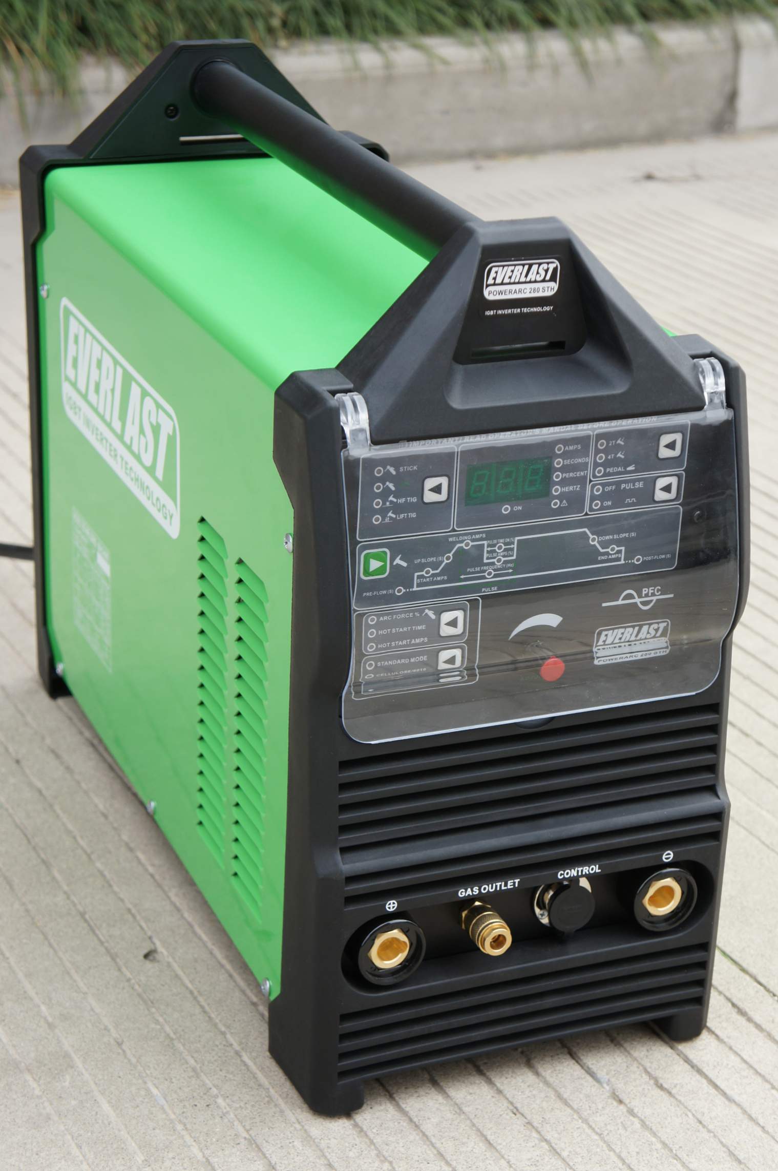

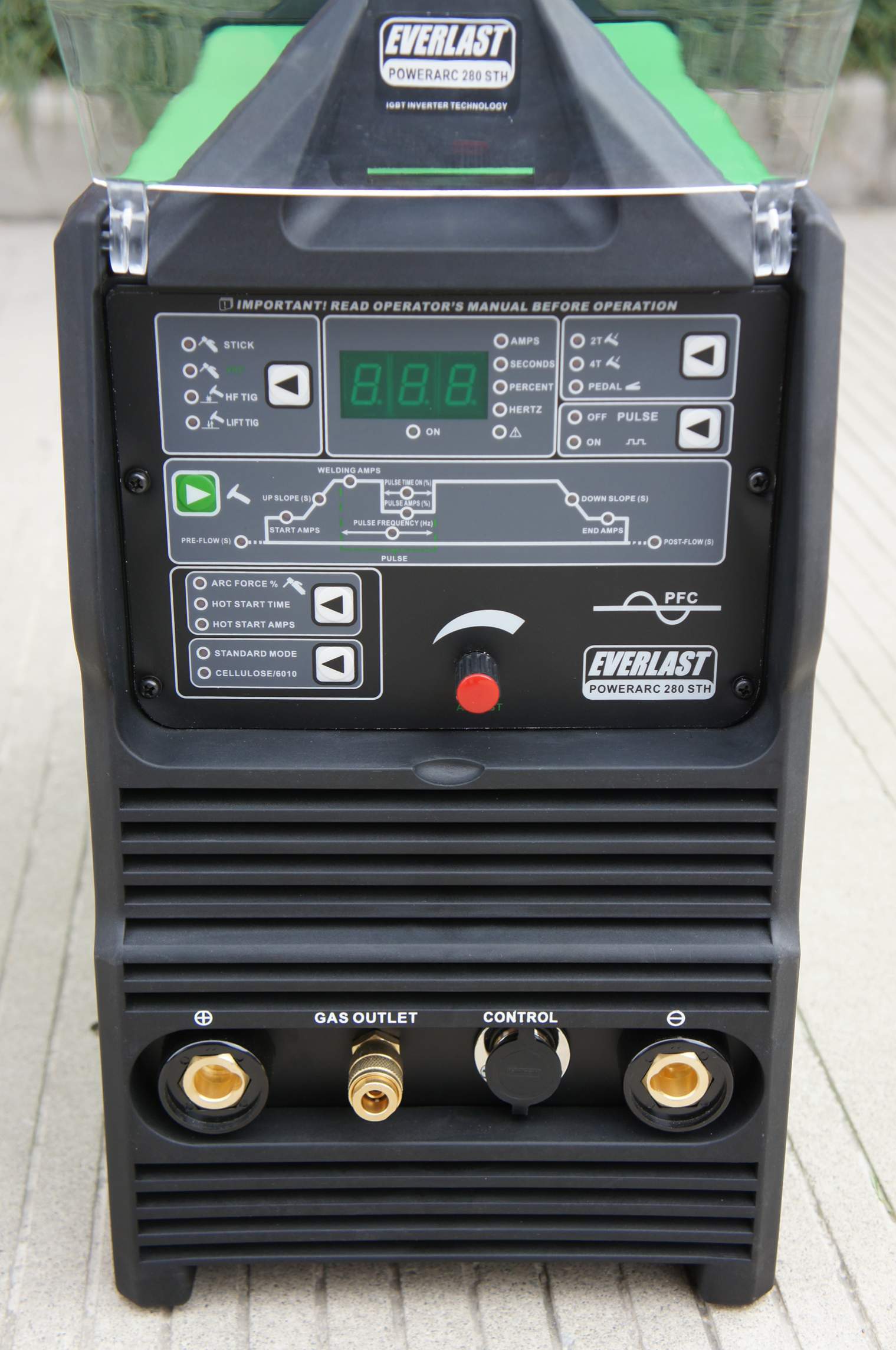

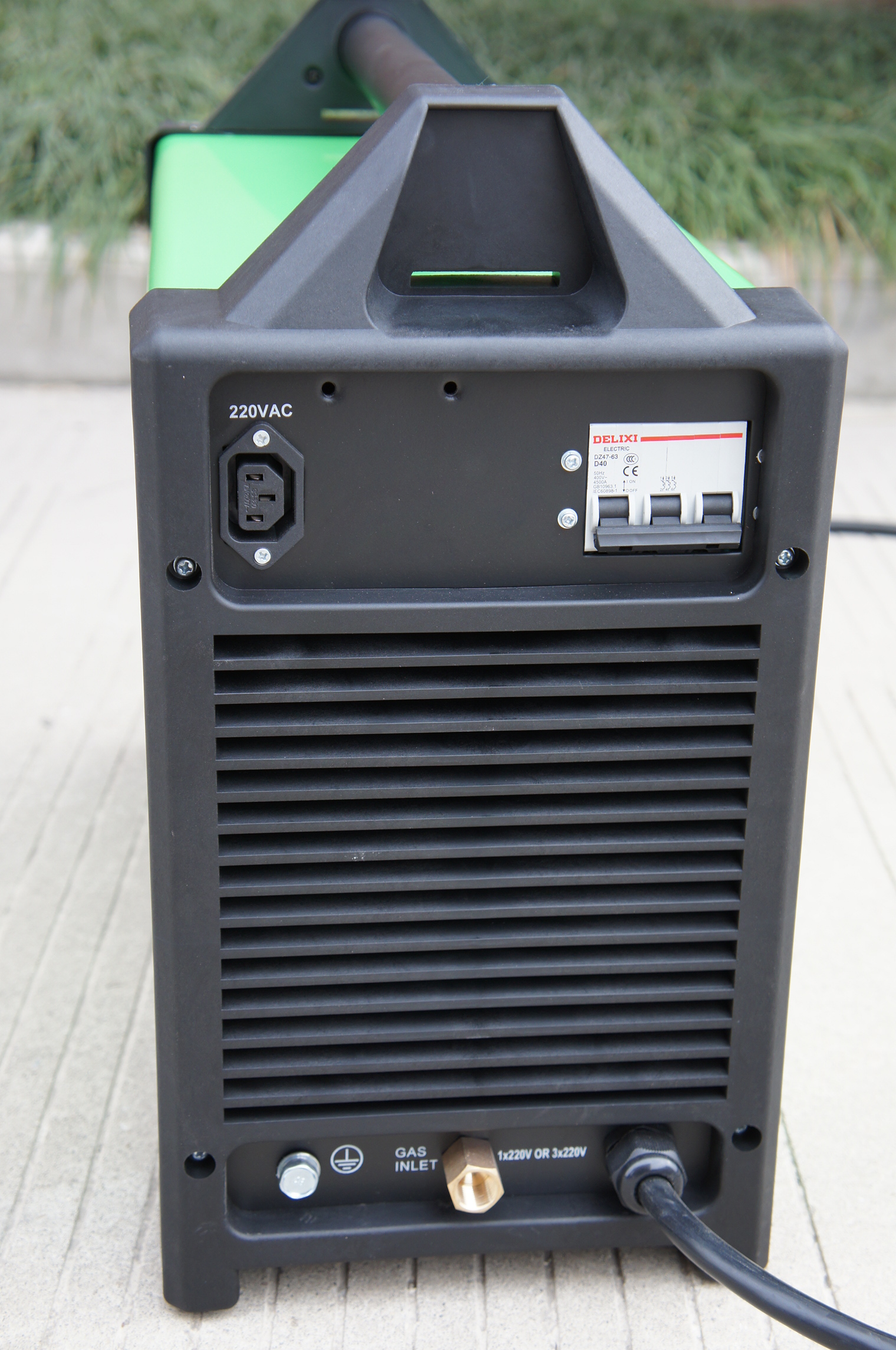

The PowerARC 280STH's are on their way...1050.00 list price. Introductory price for TBN'rs is 950.00 shipped. All digital controlled welding. 250 amps stick/280 amps DC TIG. Hot start time and intensity along with Arc force control. VRD and 6010 capability.
wow, 280 amps TIG. I don't think an air cooled torch is gonna work with that bad boy.
