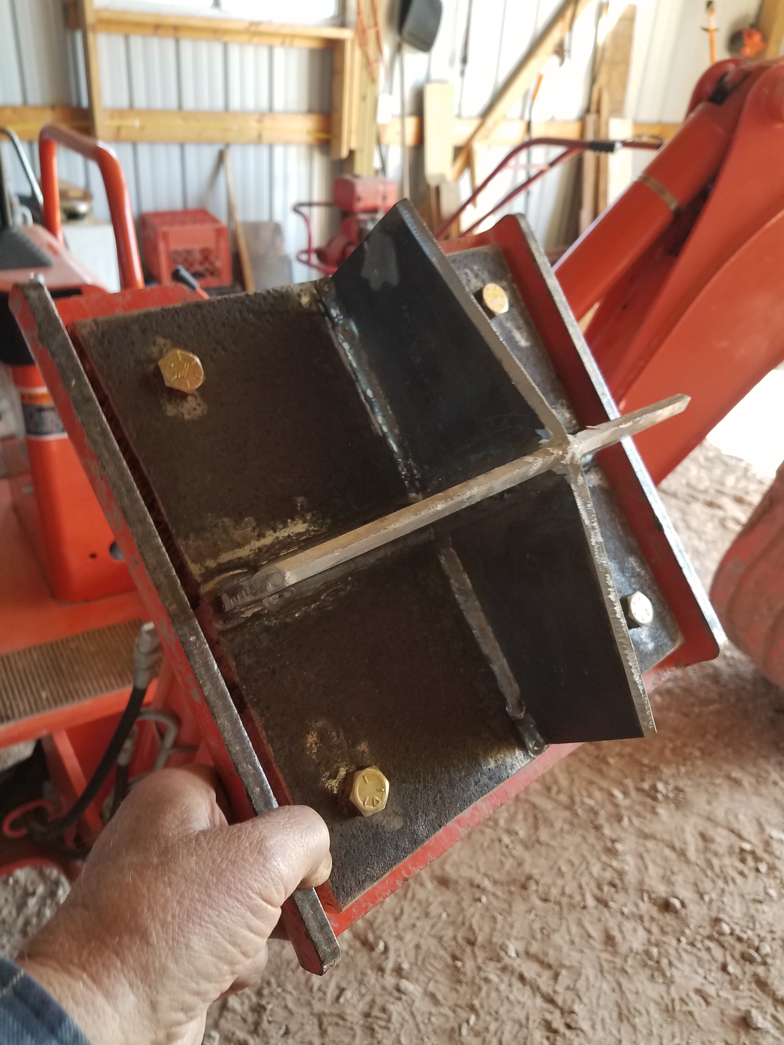

I added a pic of my stabilizer pad that I had my welder make for me. Really helps a lot.

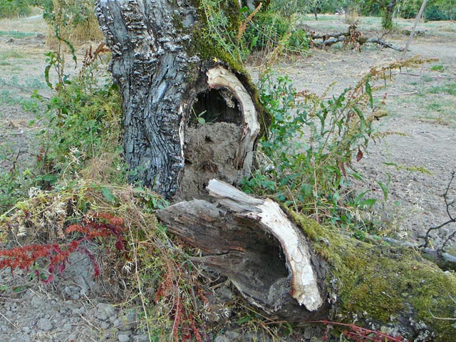

In the apple orchard I usually dig out a cavity at least as big as a card table, up to dining-table size. This is needed because the gophers have set up their headquarters beneath the trees, where discing can't get them.
About half the time I encounter a big nest of soft grass under the stump, maybe a birthing nursery? And major tunnels coming in from all directions. I need to disrupt this so that a subsequent tree has a chance to get going before the gophers eat its roots.
Photo - Gophers apparently push excavated dirt up into hollow stumps. I can expect to find a nest under this one.
