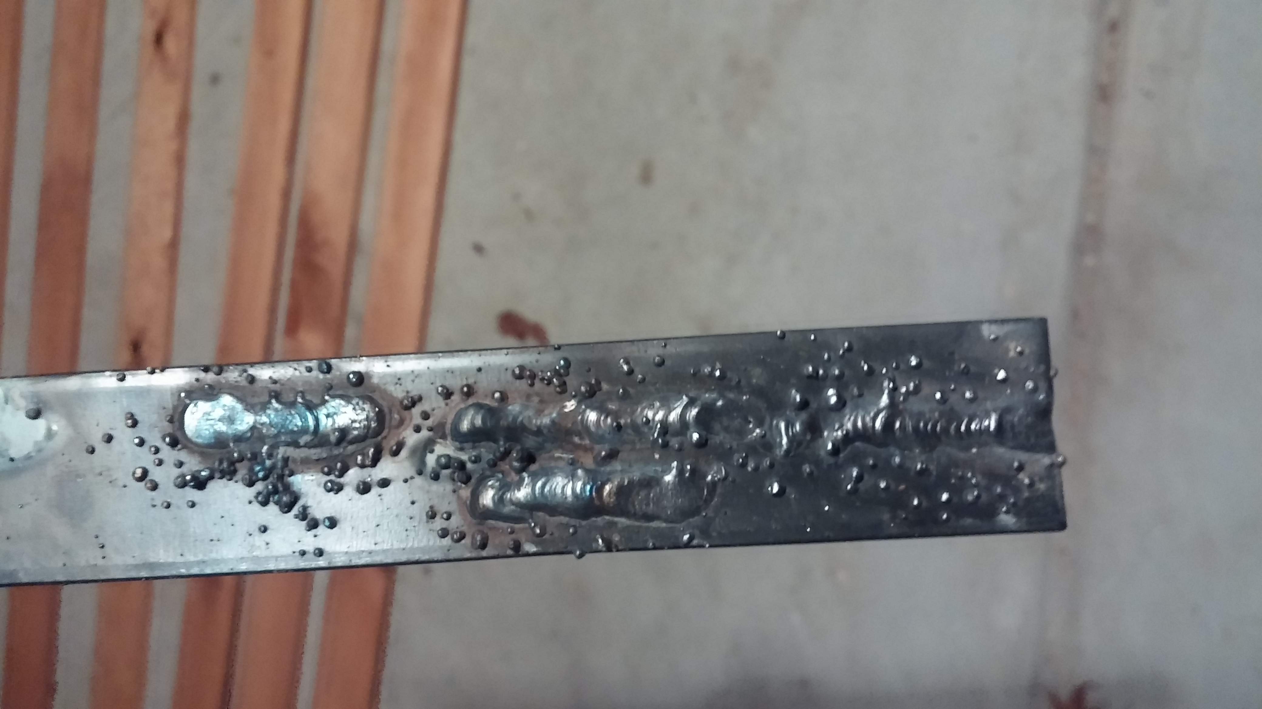

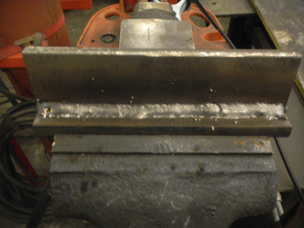

Santa brought an Everlast Power iMig 140e. It is my first attempt at welding in almost 40 years ago in high school metal shop. I was just trying to lay down some beads on 1/8" flat bar stock. I know that the sweet spot sounds like bacon frying. I know that it's a combination of voltage, wire speed, gun angle and speed. Of course, getting the right combinations will take lots of practice. That and feedback from the wealth of knowledge here :)
Here are my first beads. What causes the splatter? Any good sites for diagnosing issues? All comments welcome.
/ Newbie questions #2
You running it with gas or no gas ? No gas = Flux core wire and you will get the splatter .

yep. flux core wire. .030. I know that CO2 and CO2/argon are the shielding gasses that are common. What are the +/- for each one? I plan on picking up a bottle but have not had time yet.

Self shielded flux core wire is nice if you have to weld outside in the wind, or when you want to take the welder someplace, and you don't want to lug the heavy tank too. It works better than gas shielded wire on less than clean metal.
Gas shielded wire and C25 gas, can give good looking beads on clean metal, and there is less spatter to clean off. There is no slag to remove either.
You can also use CO2 as your shielding gas. It is less expensive than C25, and it will give a bit more penetration. A bit more spatter too.
You will need to change polarity when changing betwen flux core wire and solid wire.

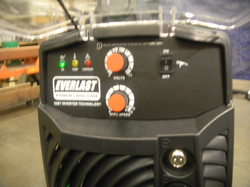

I got to play with an Everlast PoweriMig 140e recently.

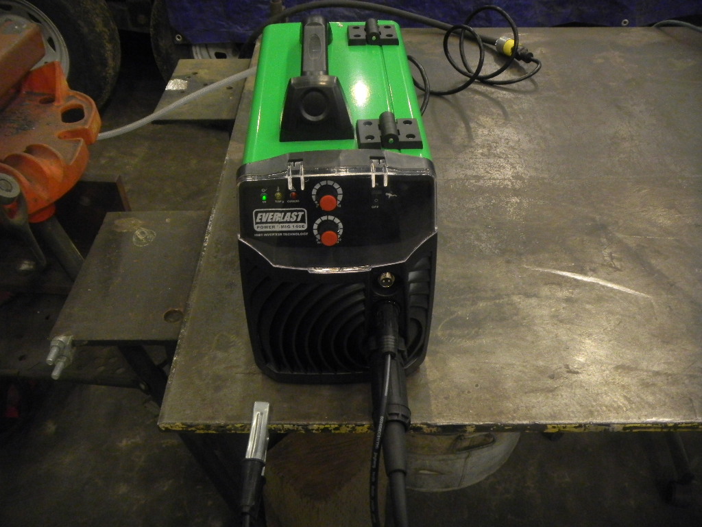

The majority of self shielded wires run on DCEN. As CNC Dan mentioned you did change the polarity by changing the wires inside the machine? If not you'll need a 10 mm socket and extension.
Stickout will cause a lot of splatter too. You'll need to force the nozzle back, so the contact tip is flush with the end of the nozzle.

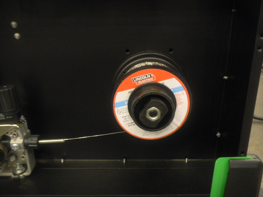

I thought I took pictures of the Imig e with Lincoln's NR-211.

Thanks! I have read many posts and some talked about reversing polarity but did not know what the rules were about when to switch it. I will give it a try as it will be a month or so before I will pick up a bottle and go solid wire (and switch polarity back).

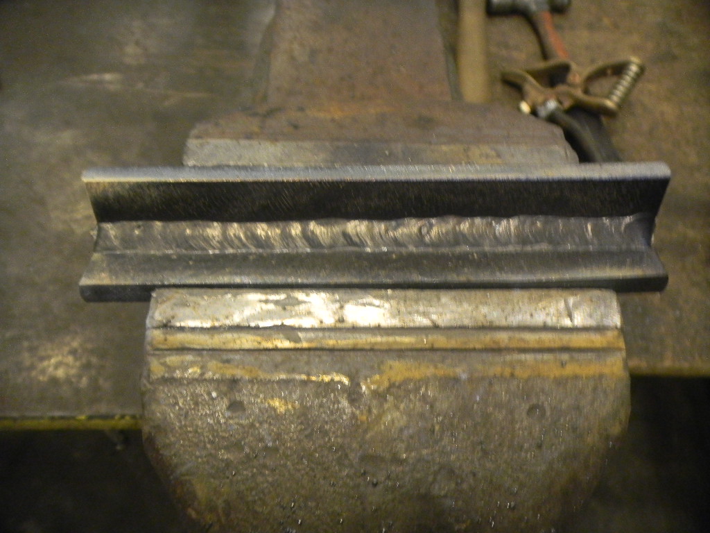

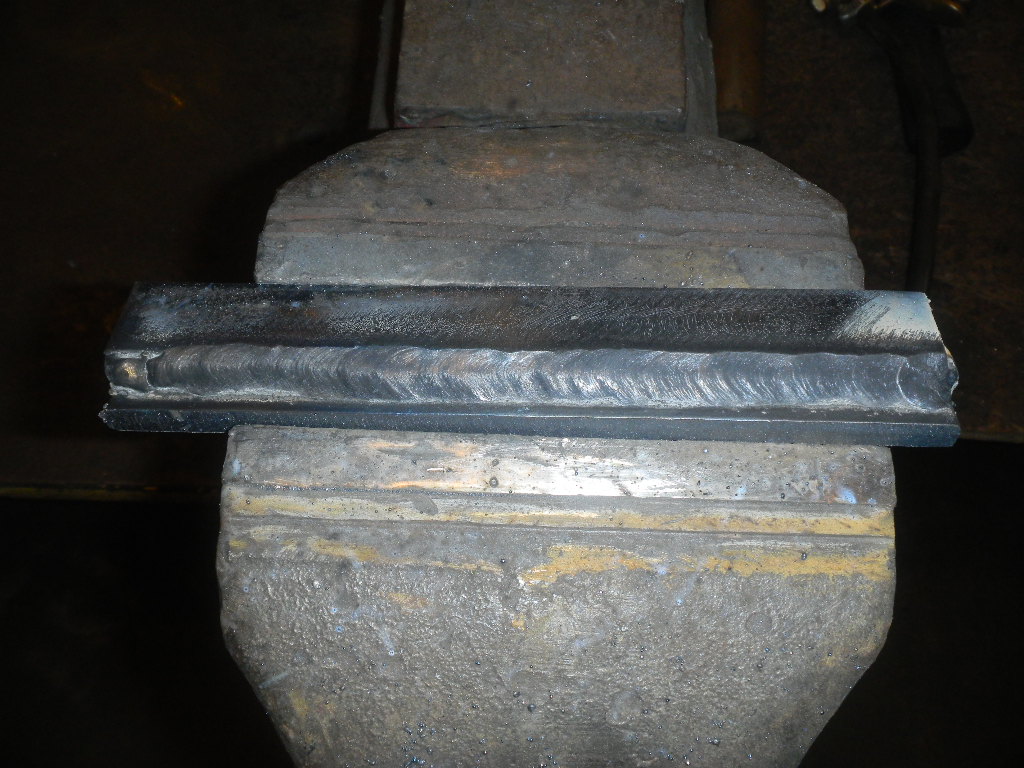

Remember now anything that produces slag you'll want to drag. If you're right handed, start on the left side, and weld to the right side.
I found with .030" Lincoln L-56 Mig wire that machine had a very nice arc:cool:. And real easy to find the sweet spot:thumbsup:. With .025" wire the voltage had a smaller window for finding the sweet spot.:confused:
Here is my first weld with that machine. .030" Lincoln L-56 Mig wire. Notice the splatter? Once the gun got warm enough where I could slid the nozzle back, that really cut down on the splatter.
What size wire was that, .030?
I haven't had much time to fool around with my 140E yet. Put in a roll of .030 flux core since it fit the drive roll that came with it.

Wow! What a difference DCEN makes with flux core wire. Who knew? :ashamed: Thanks for your advice. Much less splatter. Now to just practice, practice, practice.
/ Newbie questions #16
The flux core drive rolls help in feeding too. Are you using them?
As far as pushing the nozzle back, they will screw on and off if you rotate them. The spring design that holds them on acts like a type of thread. I don't recommend going anything more than flush with gas, but with flux core, a little stick out might not hurt.
