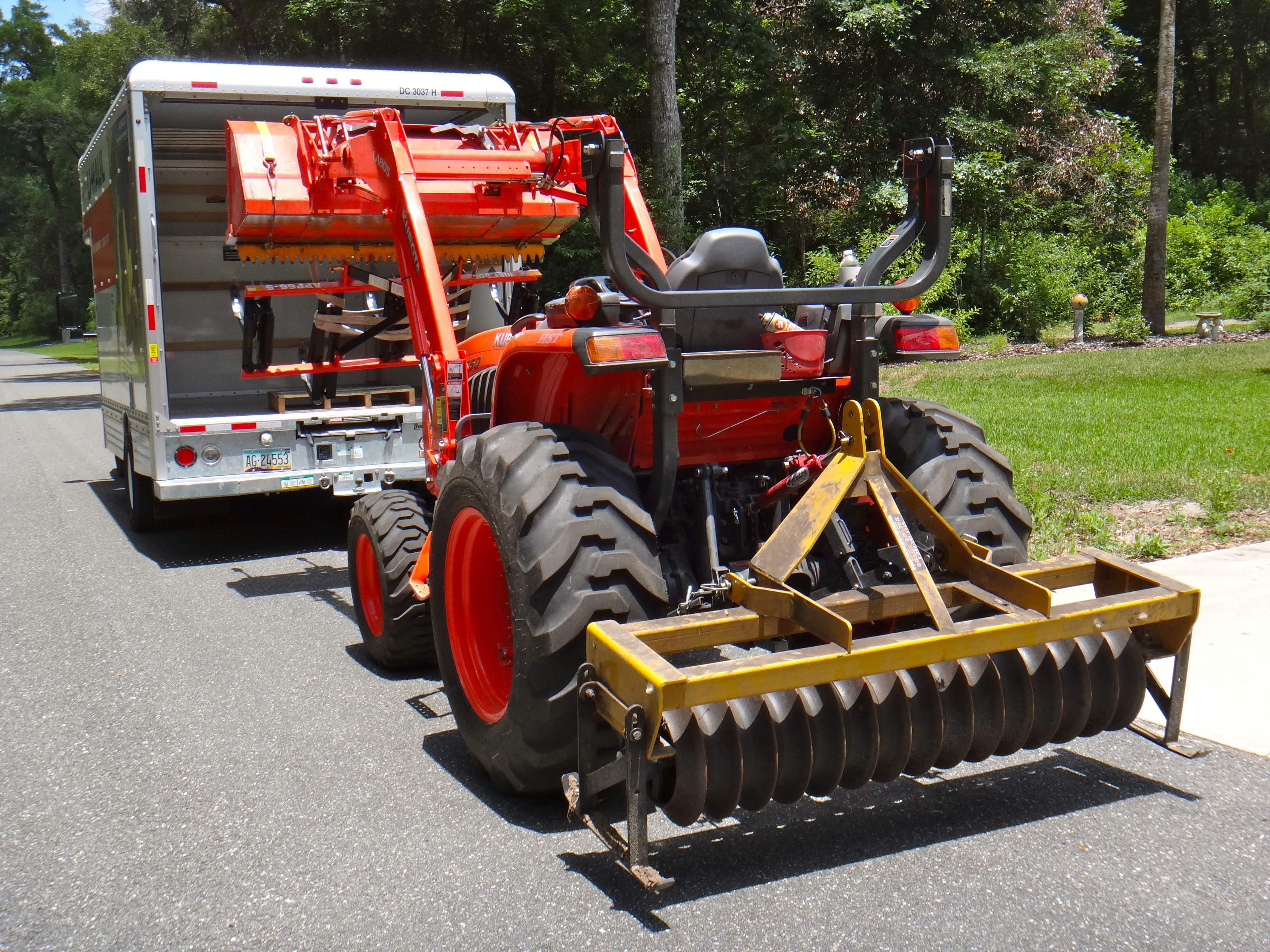

That depends on distance. It is expensive for the dealer to send a HD truck, HD trailer and mechanic/driver any distance. Every trip is two segments (outbound + return) for the dealer.
If so, at 500lbs do they bring it into your garage for you, or do they kick her off their trailer at the bottom of your driveway?
Probably would unload at the entrance to your garage, if the HD truck and HD trailer can get that far. If not, mount it on the B2601 Three Point Hitch and mobile be. The driver will help you mount. Later, alone, you will wonder: HOW DID HE DO THAT SO EASILY? ~~~No, Backhoe in the way, again. Tow/skid in with the tractor.
If I were to pick it up at the dealer with my pick up truck, how do I get her out of my pickup at home?
The safest way would be to drag it off the truck with the tractor, using ramps and chain.
As you have a Backhoe/counterbalance installed on your B2601, you can lift the roped/chained Box Blade 2" with the FEL, move out the truck, then lower the Box Blade. DO NOT MOVE THE TRACTOR AT ALL. This will be your first pucker.
I don't believe I noticed hooks for chains on the FEL.
Chain hooks are always optional. You want 5/16" size. I use and recommend Ken's Bolt On Hooks, Maryland.
Lowe's and Home Depot sell Grade 70, 5/16" chain, 20', in a bag CHEAP. Have Lowe's cut to 8' + 12' lengths before you depart the store; buy two Grade 70, 5/16" slip hooks for the two new ends. Grab hook on one end, slip hook on other end. Walmart sells Grande 70, 1/4" chain, in a bag CHEAP. Look in the TOWING/TRANSPORT section. Grade 70, hear??
LINK: Ken's Bolt on Grab Hooks <<Home>>

Nah. You will be asking WHEN YOU HAVE TO PUT IT BACK ON.

My dealer has a loaner trailer that he lets customers use for implement delivery. With my lpgs I just used my fel and a heavy nylon strap to lift it off. Or your new hooks/chains.
Then you leave it in a convenient spot OUTSIDE. It's a farm implement! It will get rusty and have a nice patina no matter what you do for storage.
While there is nothing wrong with the above, it does neglect the difficulties created in hooking up said Box ScraPer [not ScraPPer] when you neither have a "quick hitch" or other easily adjusted attachment setup on your 3-point hitch.
I don't have any pictures, but I reinforced an appropriately-sized pallet and put it on 4 casters rated for more than the specified weight of our box blade and it made getting it off and on our tractor dramatically easier [especially before we got our Harbor Freight Quick Hitch, but even with it]. 3-Point Quick Hitch for Tractors - 27-3/16" Clearance.
