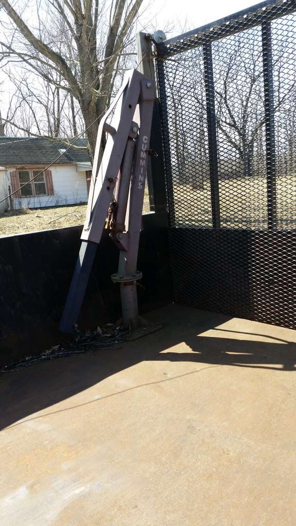

A dump trailer might work. Mine has a heavy landscape ramp/gate on the rear. I added a small winch to lower and raise gate. Only haul 2 pallets at a time, added a truck hoist to lift gate and swing it to the side.
Back when purchased, we had Cummins Tool trucks that would setup and sell stuff on a weekend. It's the only place I've seen selling the tall p/u truck hoists.

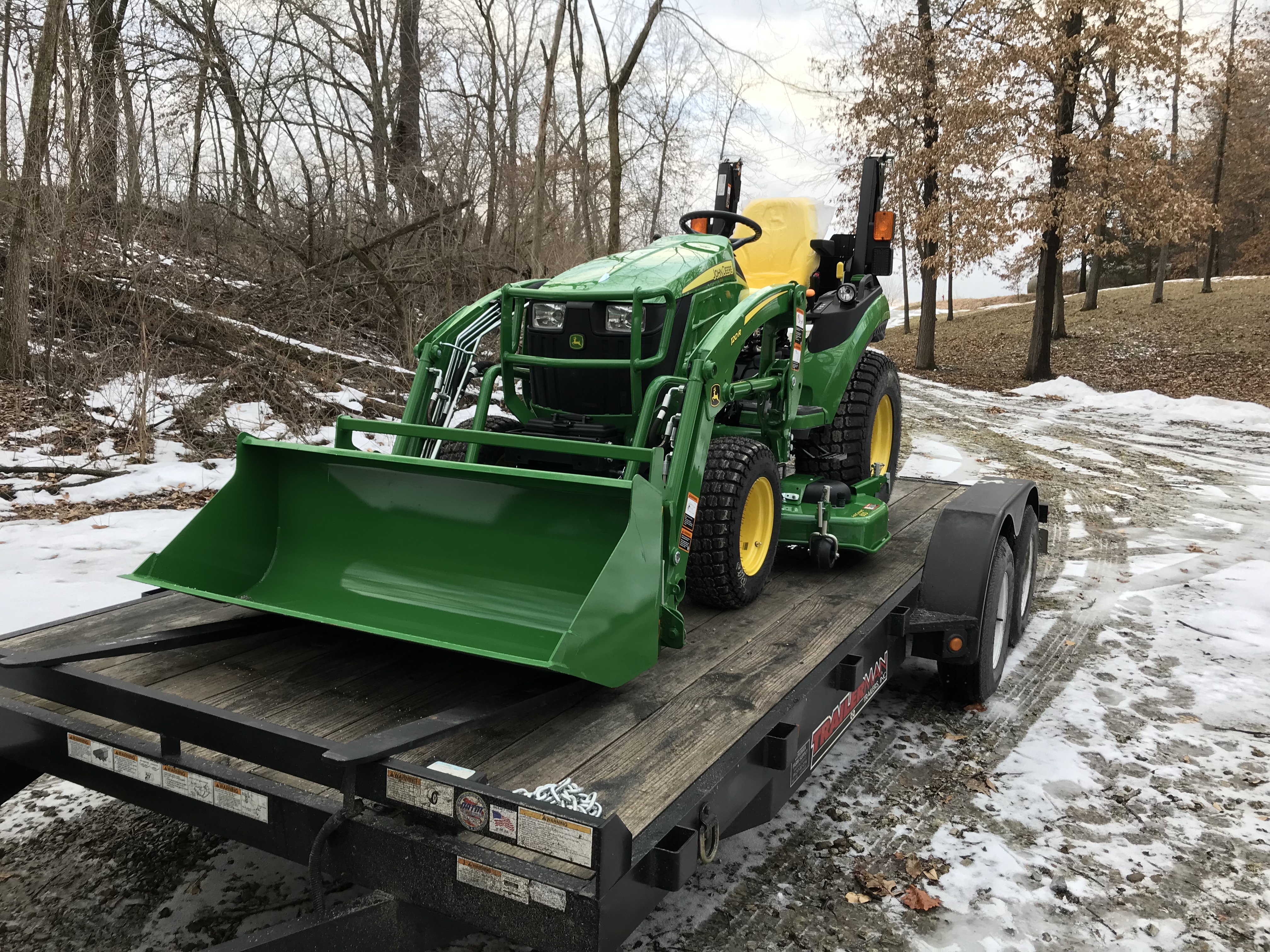

Here is a picture of mine, it’s a 7000 lb rated trailer which allows for 5000 pound payload. It’s 16 feet of flat deck with a 2 foot dovetail. This is about as cheap as you can get, it was about $2200 a years ago. They are cheaper if they have the side rails and prices have gone up and inventory is down.
A single axle is an option but that really limits on what you can haul and getting the load balanced is harder. A dump trailer is also an option but is probably more expensive.
