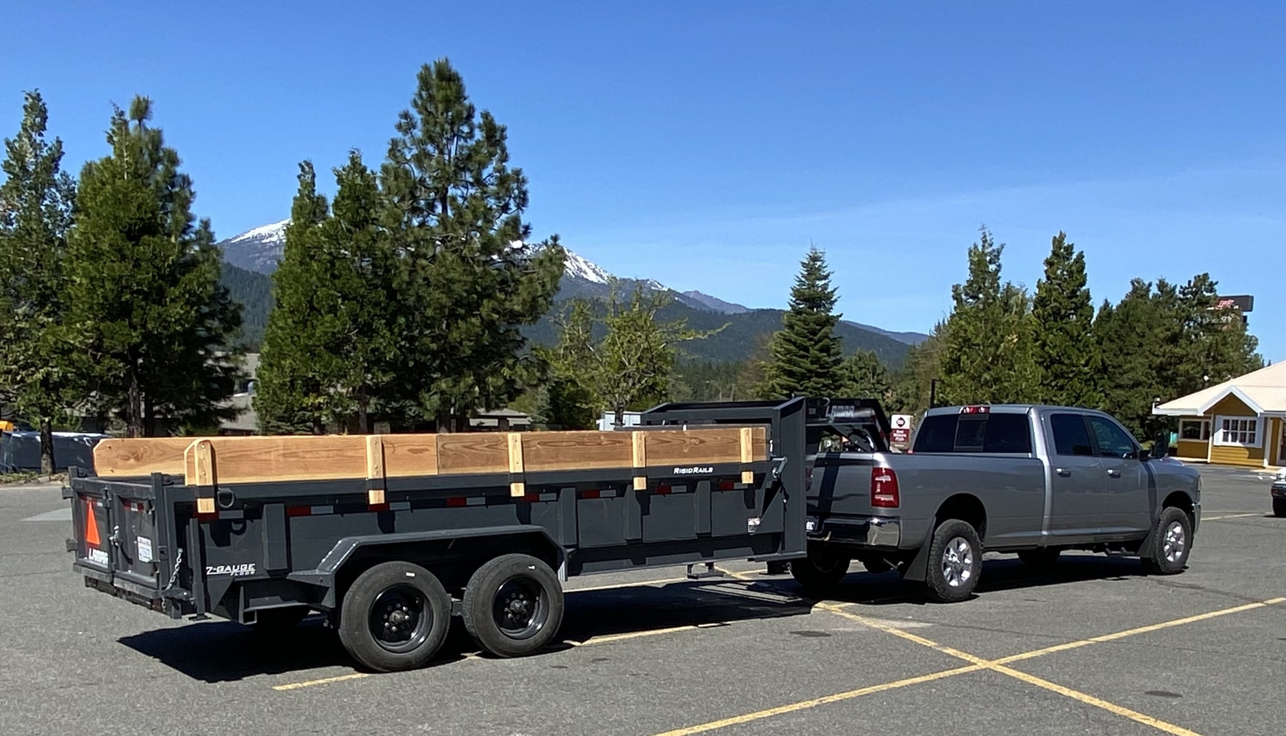

That is a NICE trailer! I have 2 Lamar equipment trailers. They both are well built!
Thanks. Thats's my new set of sideboards. Pretty spiffy. I had the 10' 2x12's in the barn. Needed a 12footer for the 6' pieces on the ends. Almost fell over at the lumber yard. $47 smackers.
