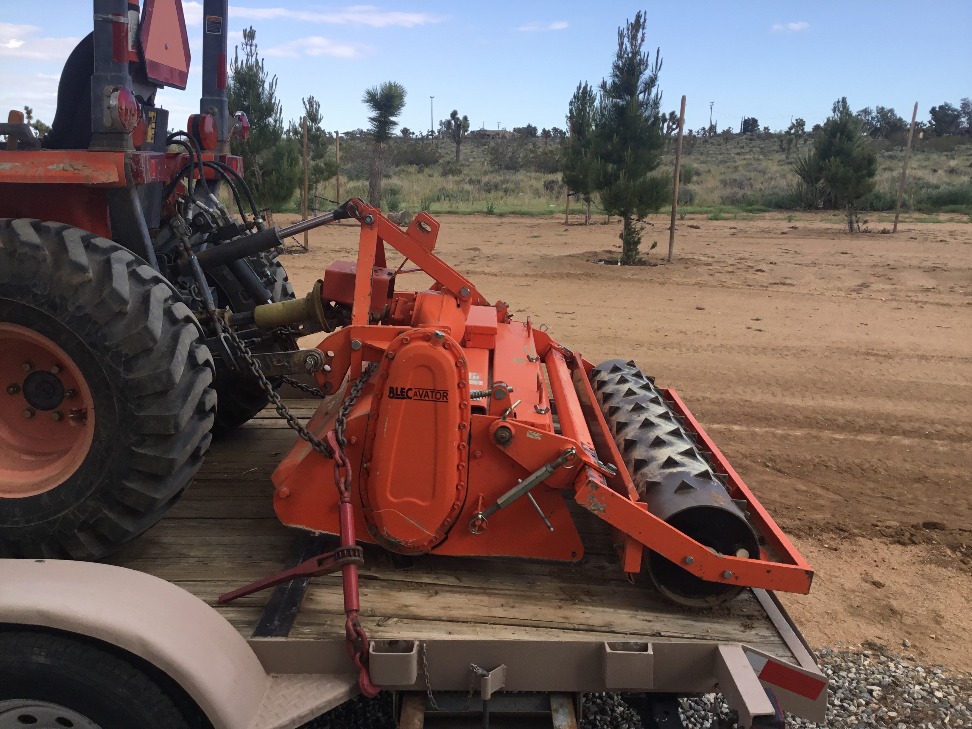

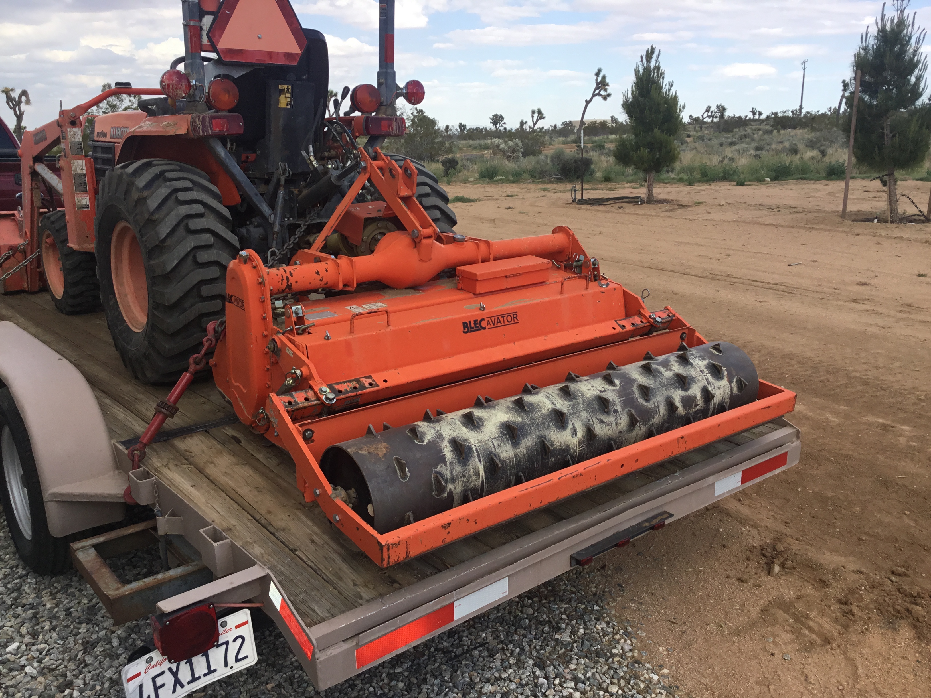

I bought this reverse rotation Blecavator about 10 years ago at a school district auction for $200. It is made in England and weighs about 900#. It not only reverse tills but it has an adjustable comb behind the tines. After the tiller passes the loose soil passes through the tines and the rocks and debris fall in the depression behind the tines. It then has a following screed which levels the soil and finally a compactor drum that levels some more and introduces divots that aerate and hold water. It takes every bit off my B7800s 23 HP PTO to run it.

$200 seems like a fair price.... :laughing:
Nice find! :thumbsup:
   / Newby question: Which is better forward rotating tiller or reverse? #19
I was Facilities Manager for the district and knew what it was. There were no other bids. Shudda bid $100. New ones are about $15,000 now.
